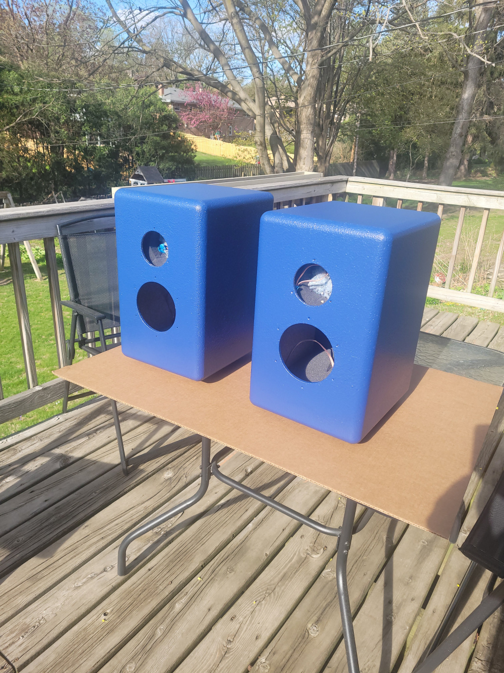

    My theme cabs with some almost free $ latex paint rolled on. No effort to hide the butt joint seams or fill the super chunky end grain (cheap Menards PB shelving). One super-duper heavy coat rolled on with a high textured foam roller. Pretty decent 20 footers IMHO! They ended up drying a tad darker. Somewhere between royal blue and navy blue. I actually really like the color. I still have 7/8ths of a gallon left over for another project.

  • Kinda remind me of JR's Taigas in color.
  • Much better👍🏻
