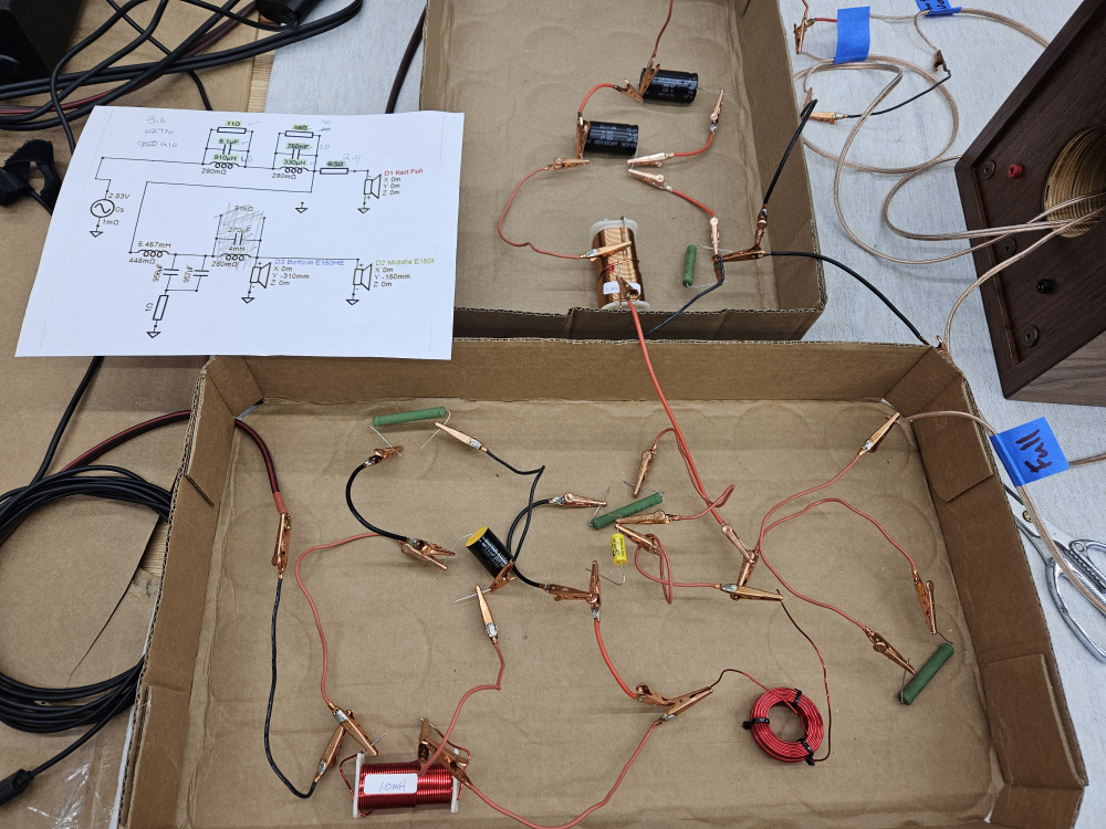

Back to XO's for a min, this is close to final for me, everything look acceptable before I lock it down?
Unfortunately, the LCR notch on the woofers has to be moved out front. If the notch would include the first inductor, and no resistor, I would have allowed it because that affects the slope and such.
The 91ohm resistor isn't really there, I should have deleted before uploading the pic. This notch only acts upon the slope of the woofer. I thought as long as it didn't impact the natural rising slope of the full range, it was okay?
If 4mh coil and 270 uf cap notch was moved out front of the full range it would be acting as a bit of high pass on the full range, which I didn't want and I didn't think was allowed.
With the LC as wired and placed out front, the 270uF will not be a highpass, as bass will travel through the coil to both widerange and woofer. It will place a dip in both drivers' passband.
As is wired where you have it, it does not affect rolloff slope. It places a dip in the response of the woofers, and therefore is a contouring network.
Might I add- those are some large values you have there....
I will move it tonight and see what happens.
Prolly be fine and with lower values.
Glad I asked and thanks for the quick reply.
Wish me luck!
I'll need more than you. I have not cut any holes yet!
Just ended up removing that notch and adjusting a couple of other values.
