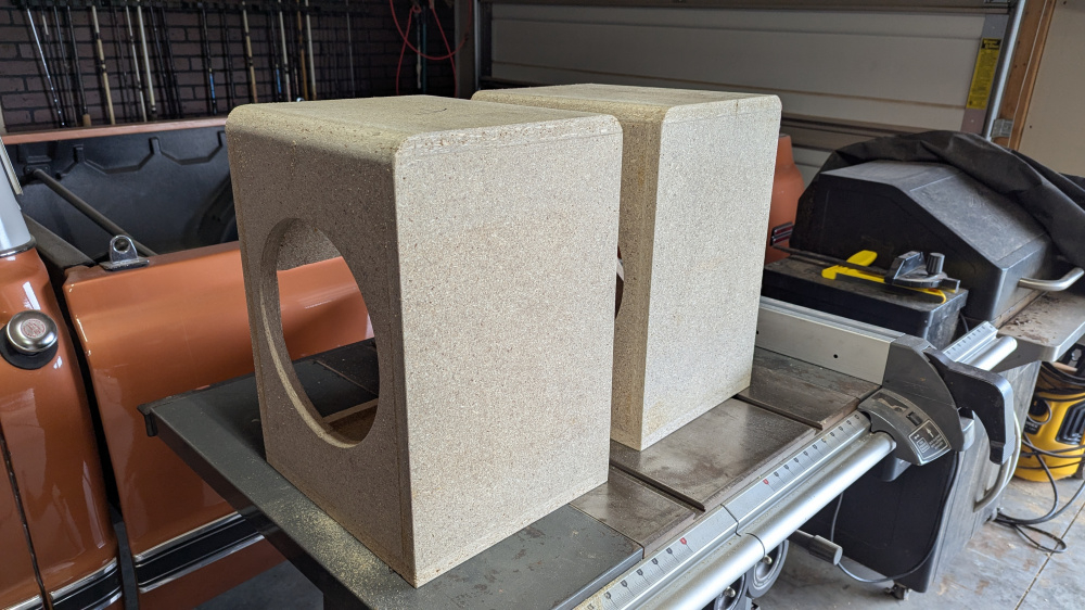

  • Machine work done, now to decide how much further I take the cabinets. I might do a full seam/end grain fill and a smooth Duratex. I may just rough Duratex them and call it a day. I don't know - see how my mood is here in a bit. Beautiful weather today.

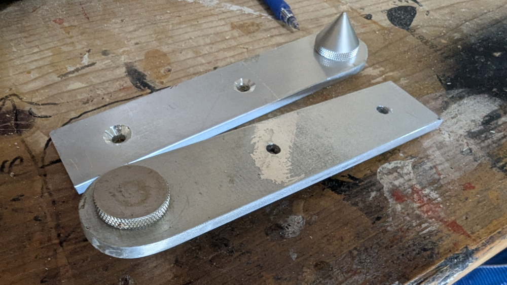

    I decided on outriggers, Lowell gifted me a set a few years ago that will be perfect for these.

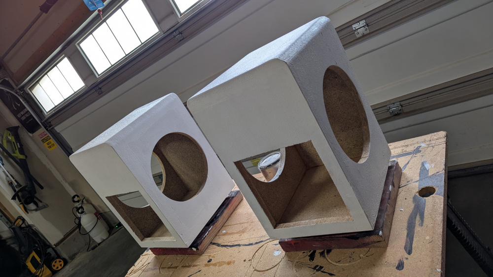

  • Decided to do a half decent finish on these. I figure I'll have something like $1000 in to the pair I may as well make them look halfway decent.

  • edited April 23

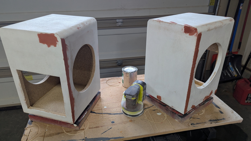

    Luckily I had some white sitting around so will do first two build coats with it.
    6thplanetTom_SDrewsBrews
  • I guess pushbutton in = boost on. According to some claimed measurements, the boost is actually centered at 28hz, q of 1.6, and 5db. Changes things a bit, but not terribly.

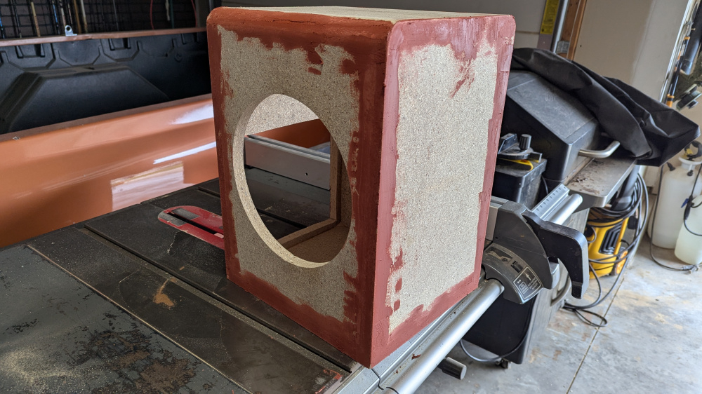

  • Sanded first coat down and started filling more blems. Will recoat again after putty cures.
    johnny5jzkenrhodesDrewsBrews4thtryPWRRYD

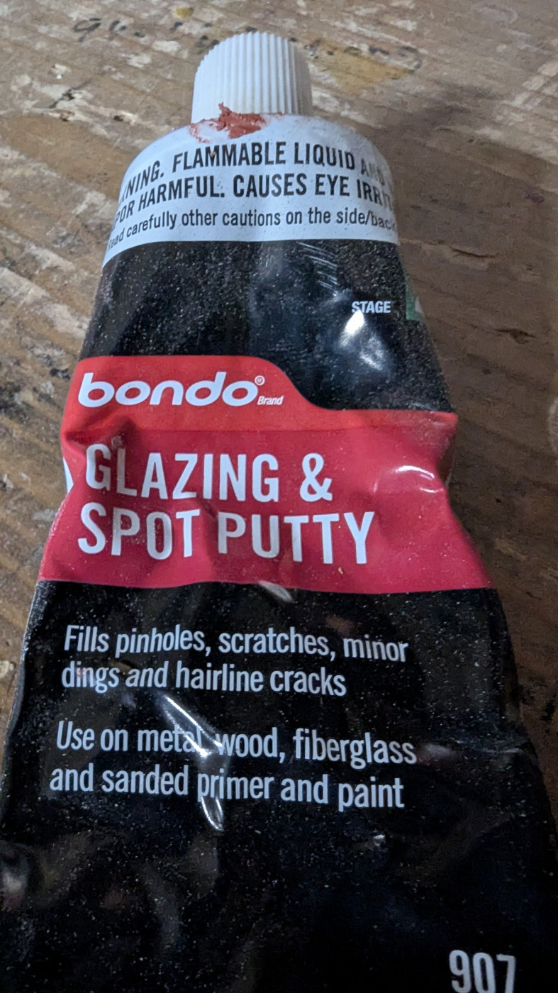

  • Is that automotive spot putty that comes in a tooth paste tube from Autozone, Advanced Auto, O'Reilly's, etc?
  • Yessir.

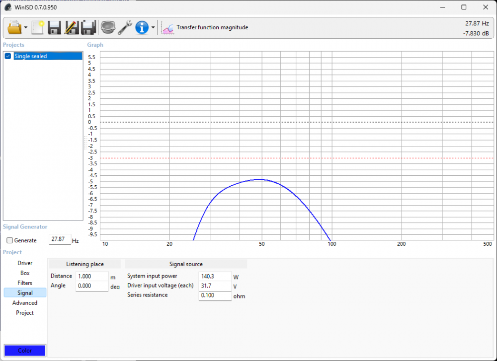

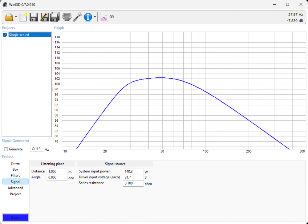

  • Change of plans due to me being an idiot. I measured wrong and the enclosure is not wide enough for two drivers. So, I remodeled with a single driver in this enclosure. It obviously sacrifices output, but I actually gain extension. I will have to add a brace or two now, as well. So that all being said...
    With the 60Hz lowpass, 20Hz highpass, and boost applied the sub now extends to 27Hz. This is 6Hz lower than the dual driver, so that at least is a win.
    Maximum SPL is of course reduced somewhat:
    And of course excursion increases, and in this alignment hits the limit at 28Hz give or take:

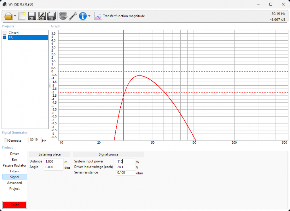

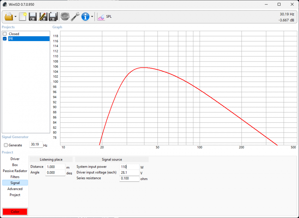

  • I forgot I have a pair of Dayton RS 10" passive radiators... They fit the cutout and everything. So, now I do not have to make my cabinets ugly with a cap on the one hole. I also gain output but sacrifice a few Hz. The rolloff is steeper as well.
    Max SPL is back up to the 106db range:

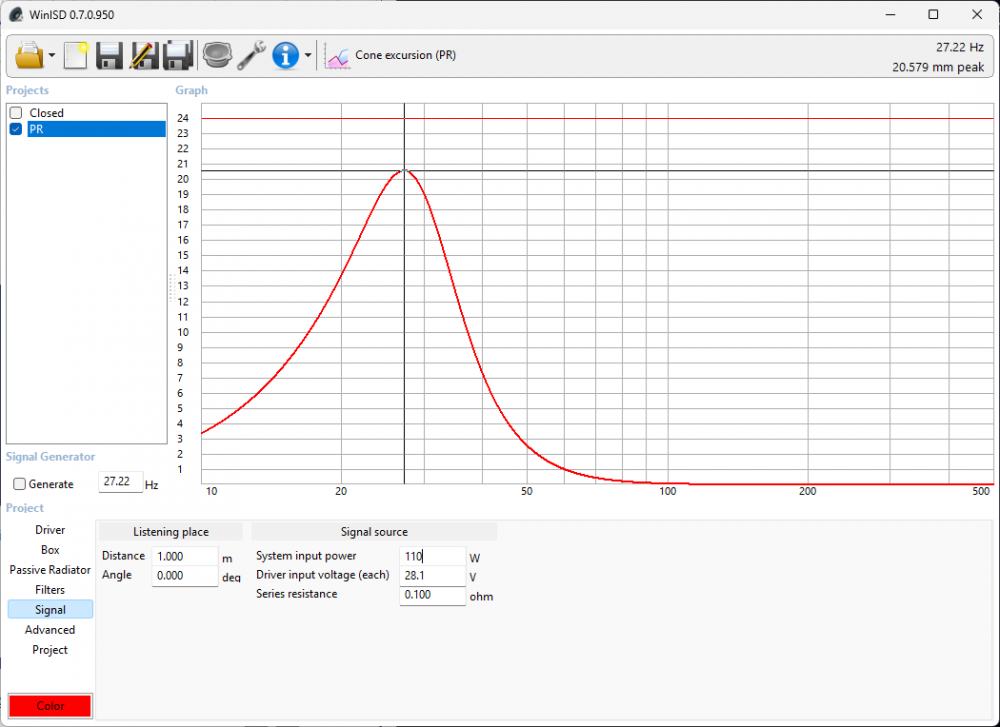

    Excursion is at its limits at 22Hz but it otherwise under pretty good control:

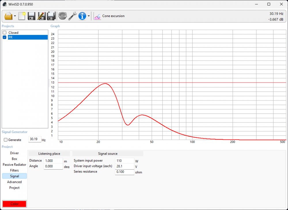

    Passive radiator is not working overly hard, either:
    So whew, saved the day. Many thanks to Tajanes for the passives awhile back.
