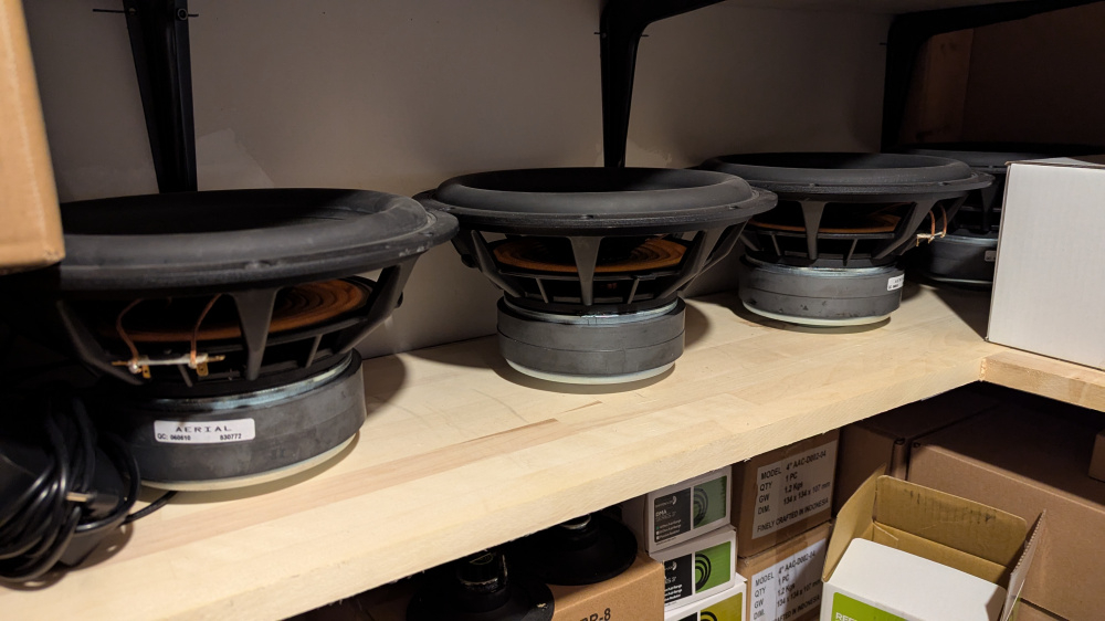

So I am sitting on four of the Scanspeak built Peerless XXLS lookalikes from the Aerial buyout four or five years ago. Nice build quality, good specs for small enclosures. Shorting rings and some venting around voice coil should mean reasonably low distortion here and there.

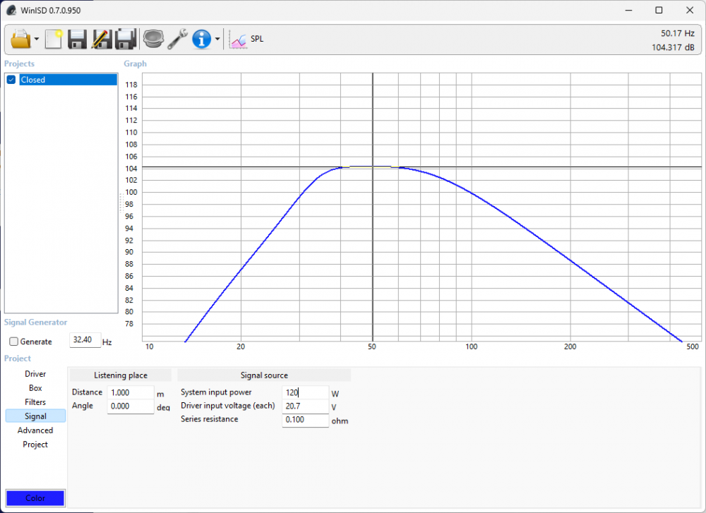

Now for the fun stuff. I modeled these as a pair (they are 8 ohm) in a sealed enclosure with the 35Hz boost applied from the SPA250. 0.63 cubic feet(!) yields F3 of 32Hz:
Xmax is nowhere near its limits at 250Watts - however 3rd party testing indicates the SPA250 is actually capable of outputting 400W! I modeled based on the 250W figure. Will never see near that under my normal usage, but at 250W we are looking at over 104db between 40 and 63Hz. This is a significant output level, especially if thrown in a corner somewhere.

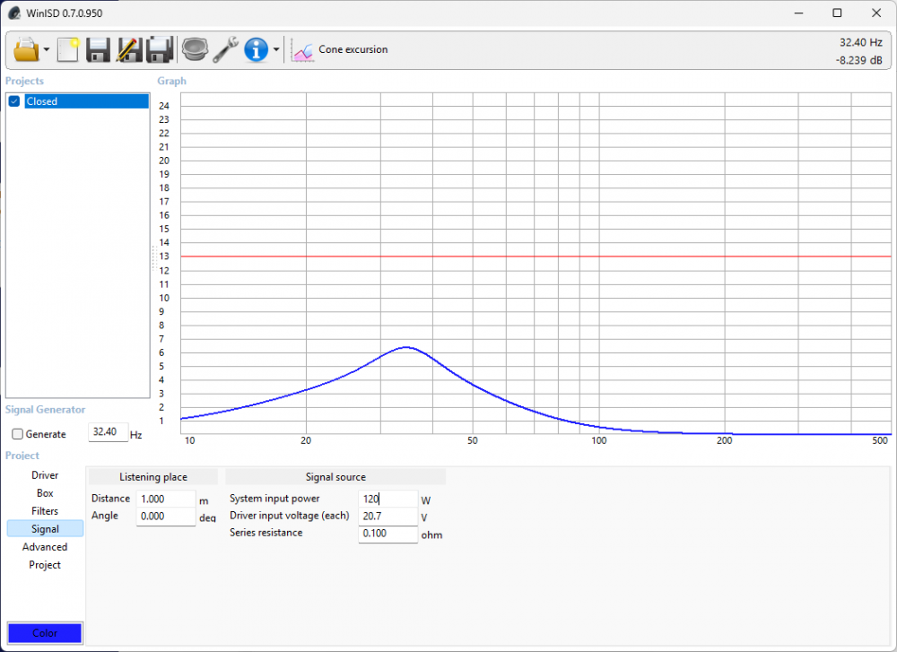

Excursion at 250W:
SPL:

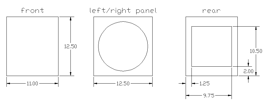

These would be mounted opposing so bracing is probably not really required. I can crank them out using some PB shelving, and the drawing I made is based on any one panel having a maximum width of 11". Add a nice Duratex finish and we are looking at a serious pair of stealth subs.

Some driver porn:

    Your dimensions come up to around .665cf. The amp and drivers probably take up a not insignificant chunk of that.
    I skimmed through the Q&A and found the amp mounting depth is 3.5" (subtract .75" for enclosure material). With the 8.5x8.5" opening that calculates to ~.115cf lost. Then you've got those big chungus magnets. etc. I'd just figure tuning tolerance get tighter when dealing with small volume enclosures like that.
  • Even at 0.5 net F3 is still in the 34 range, I'll take it for the small form factor.

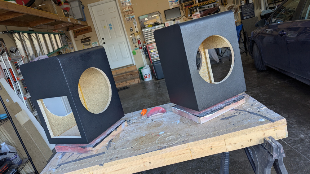

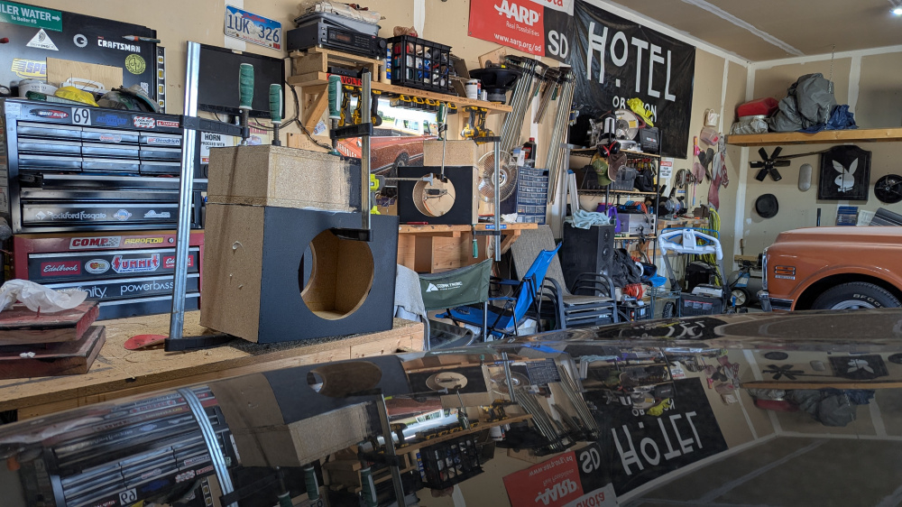

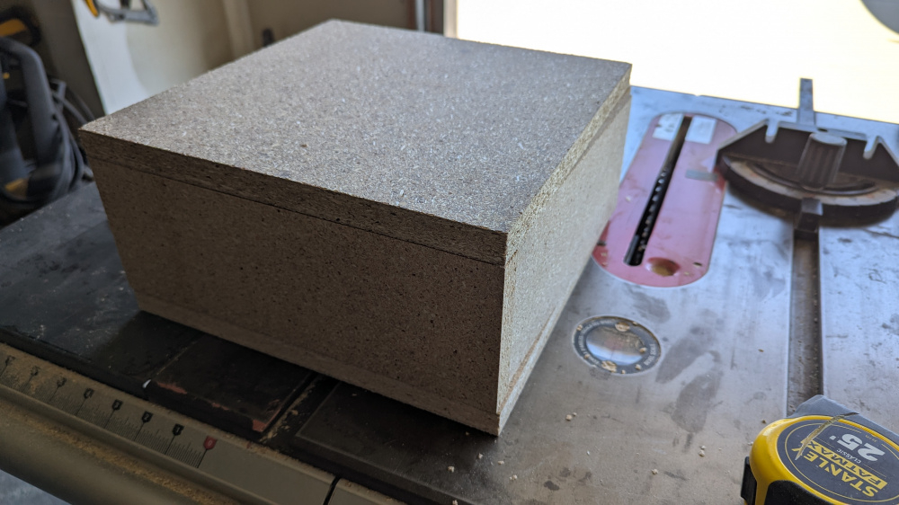

    Upsized to ~0.75 internal. Glued up, will machine tomorrow and start seam filling and prep for Duratex. Drivers will probably not be flush mounted. Have not decided. Will need extra meat installed if I do flush them.

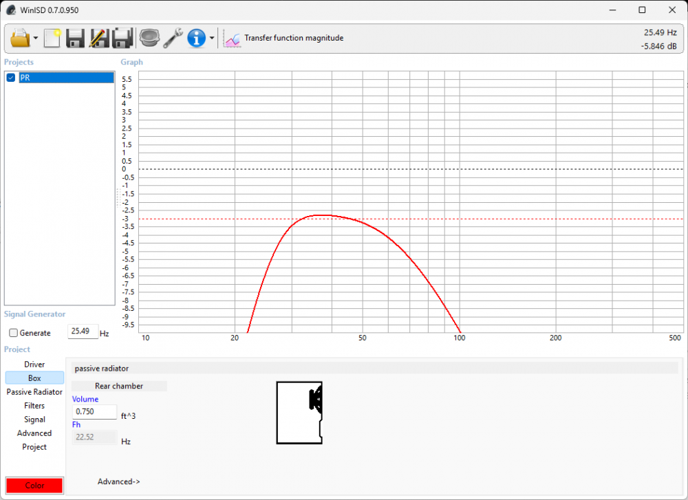

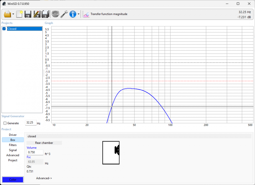

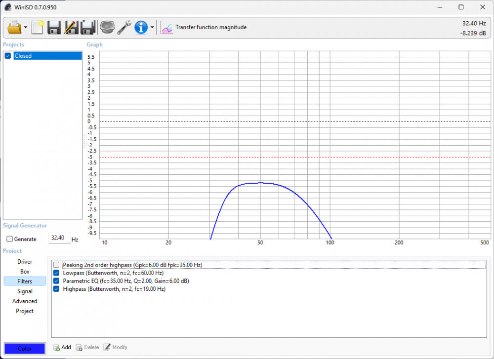

  • Some updated models:
    Gained some output below 50Hz with larger enclosure:
    Note, I did model this based on the 400W dynamic rating of the SPA250. Even considering how much overhead the boost gobbles up, it still gives an impressive overall output. These things should flatout rock corner loaded.
    F3 around 32Hz (with a 60Hz low pass applied):
    Zero issues with excursion, even fewer issues considering the model is tickling 108db - subtract 20db from that for my normal listening levels and we are barely moving the cone here.
    The above models assume a 19Hz high-pass filter which is what I seem to remember Dayton using in the old 240W version. The effect with or without it is negligible. It also assumes the boost is not a peaking high-pass variety, as well. So several assumptions have been made here, but reasonable assumptions. The difference between a simple EQ boost and a peaking high-pass is also minimal. So moral of the story on this particular build is do not sweat the small stuff.

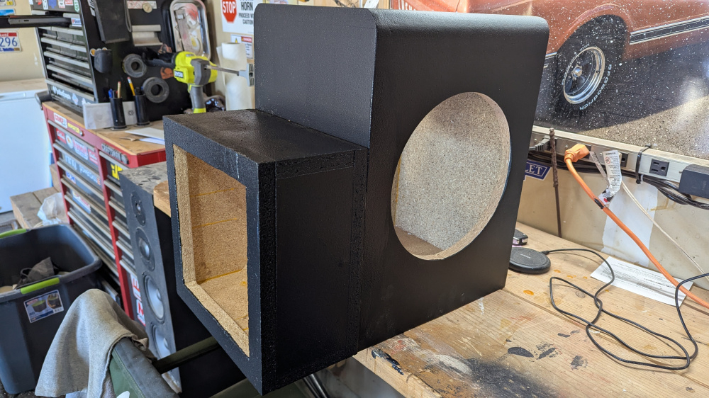

  • I'll church these up just a little bit.
