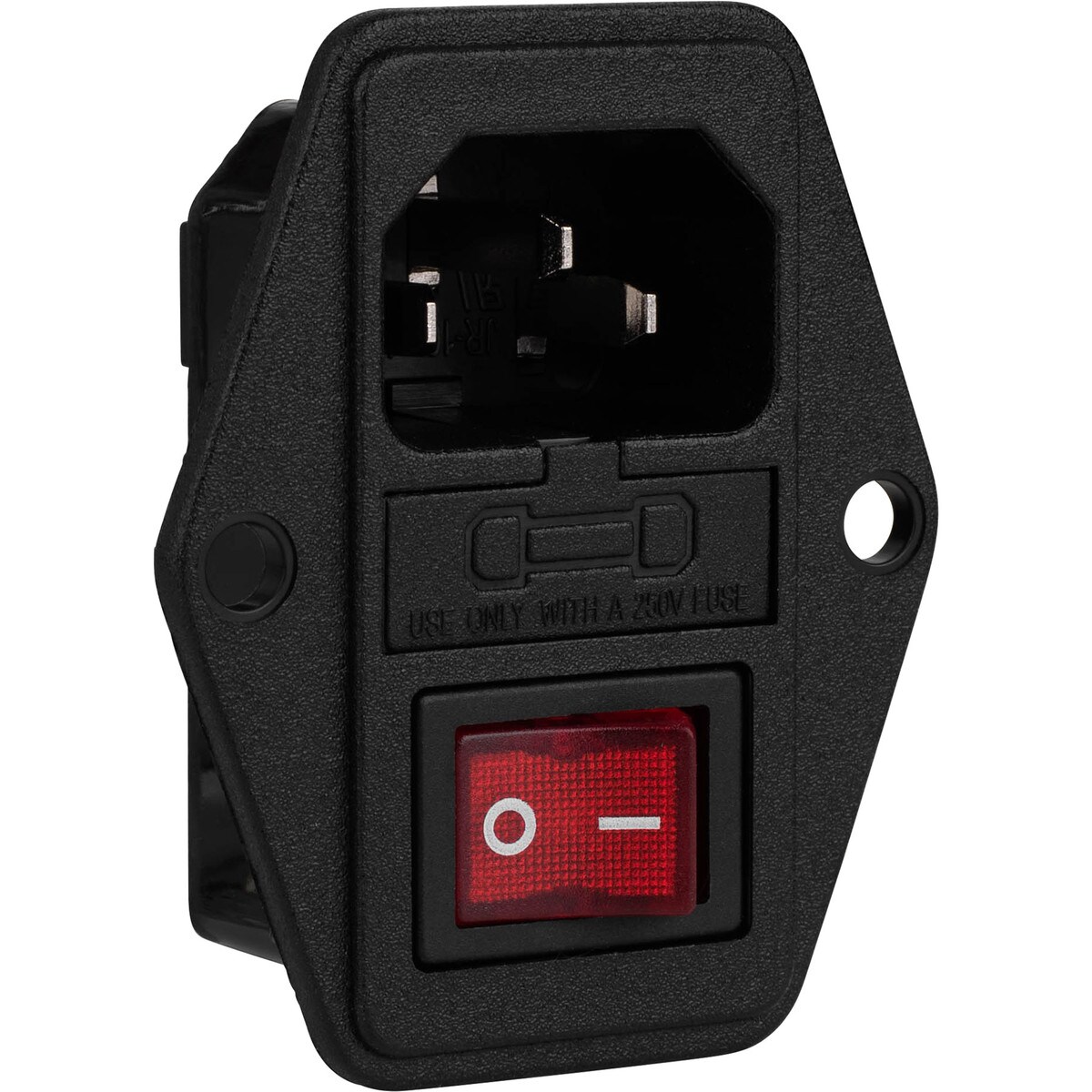

  • can i use something like this? Also, how do i make a big rectangular cutout in the project box?
    https://www.parts-express.com/IEC-AC-Power-Jack-Chassis-Mount-with-Switch-and-Fuse-Holder-090-978
  • Drill an then use a nibbler, and clean it up with a file.

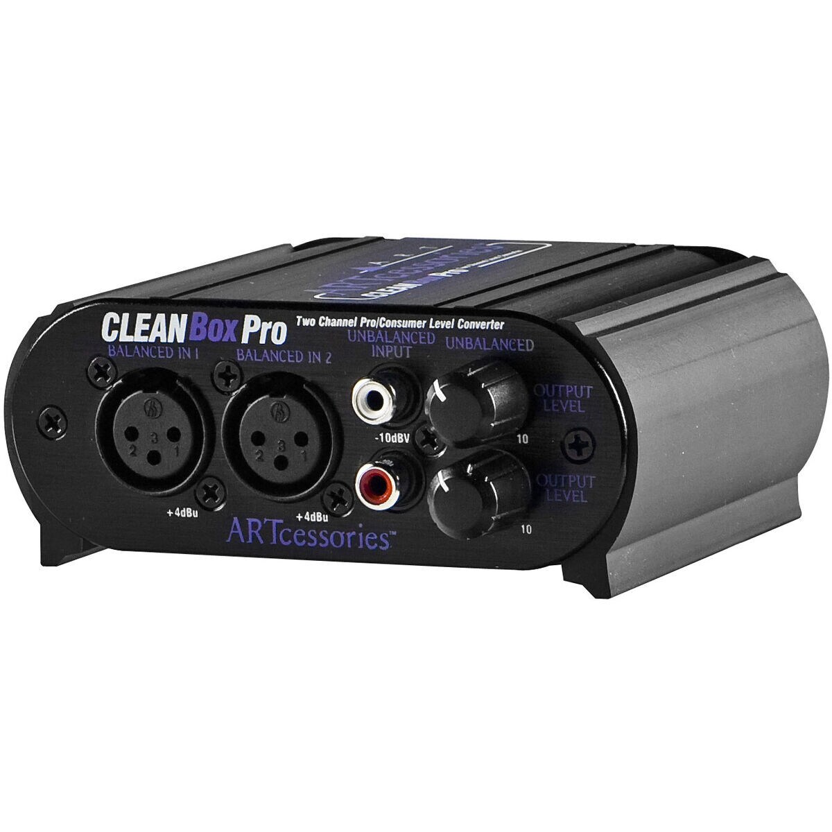

    What does this mean? Is this a pro vs consumer sort of thing?
    Is an input buffer required, if i drive the amp with balanced signal - i do have a DAC that balanced out that i am currently using with the Ncores (I didn't build it though), but it is a consumer DAC.
    I also have a ART Clean Box Pro from stepping up unbal to bal and voltage from consumer to pro which I am using with my Crown Amp (the previous model, which didn't take low V RCA). Would this be a better option?
    https://www.parts-express.com/ART-CLEANBoxPro-Stereo-Balanced-Unbalanced-Converter-245-868
