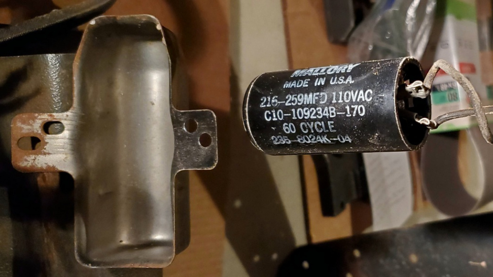

    The motor has capacitor start, probably a polyproplyene type. 3/4 HP. Might be a little wimpy for grinding out huge baffle diffraction roundovers. B)
  • Start capacitors like on your motor, are almost always electrolytic. Run caps are poly.

  • Thanks, Bob. Excellent tips. I'll be sure to do both the mineral spirits and wax. I was going to skip the wax because I figured it would just be scraped off by the sanding belt. But as you indicate, that is not true. I'll be keeping this thing in the basement, so I need all the rust prevention I can get. I also keep a dehumidier cycling on and off to keep my basement dry, but the humidity level is always about 10% higher than upstairs.
    I was going to skip checking the motor capacitor because I thought, in error, that they were probably poly's, which basically last forever. I'll be sure to pop the cover and test the electrolytic for leakage and replace as necessary. Thanks again for the excellent tips! :+1:

    I will need roughly 240uF (216-259MFD) and a high voltage rating. So, multiples of the Jantzen Superior 22uF 1200V units will be my only choice. I'll need to parallel up 11 of them to get 240. Total cost: $1292.72. The only problem is that they are currently out of stock at Parts Express! ;)

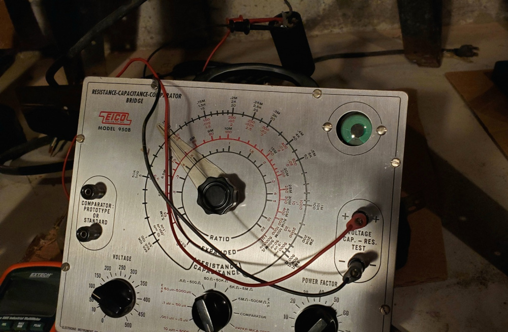

  • I checked the Mallory electrolytic motor start capacitor on my multimeter and it measured in the range of 219 to 255uF, depending on how much residual voltage charge was still in the cap. I also tested it for leakage on my Eico 950B capacitance bridge. With 125vdc applied, the eye tube slowly opens to about half way and then stays there. I cannot get the eye tube to open completely unless I drop the voltage to about 75vdc. Compared to other electrolytics of the same capacitance and voltage, this indicates that the Mallory cap is slightly leaky, but probably still OK. Drop in replacements for these caps are available from several sources. So I might consider replacing it. Or I could just wait until it fails. If it fails, it would probably just open up and then the motor would not start.
