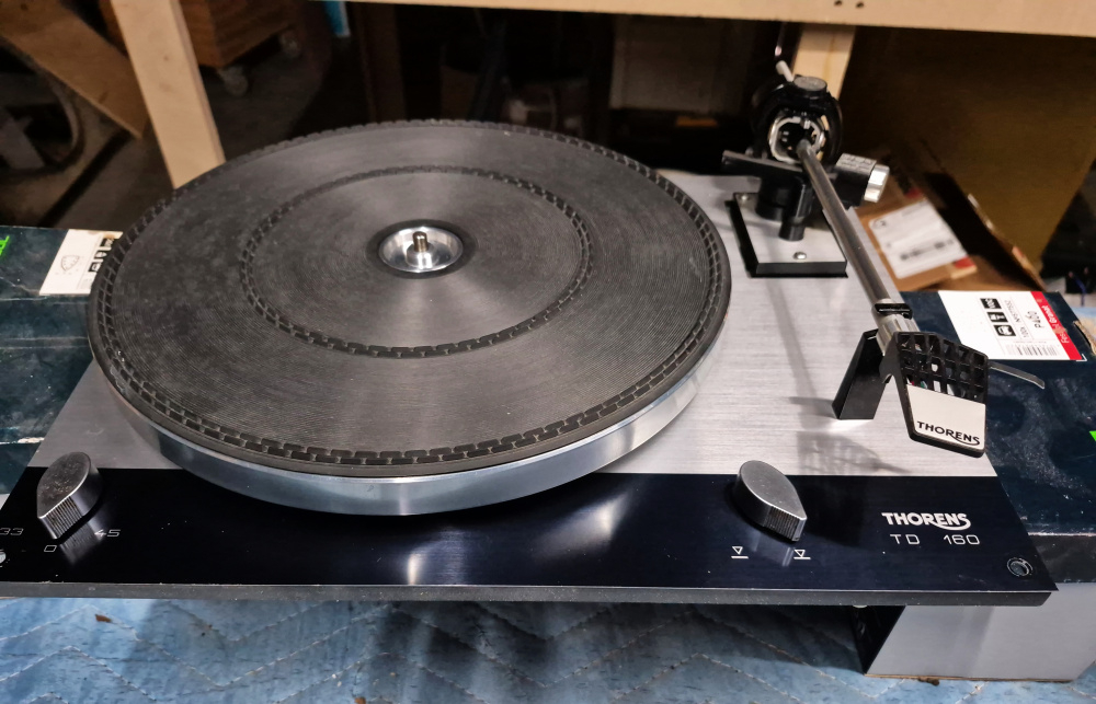

I have had a stash of Rosewood from 1950s. Just a few leaves left. But enough for this plinth and may be another one down the road. Core is a double thickness TruePan+ which is something of a HDF type but still, I can lift half a panel. I've decided to have the aluminum rest on the L-cut around the plinth instead of just 4 corners as original mounting.
CNC to the rescue. The bottom is made in Meganite solid surface. I had a few scraps left over from the commercial work. So, why not. I am planing to thread the feet which I have yet to design.
So, this is it for now. I need to finish lacquering, do a little polishing and start on putting things back together. Got new belt, OEM shell and new banana plugs.

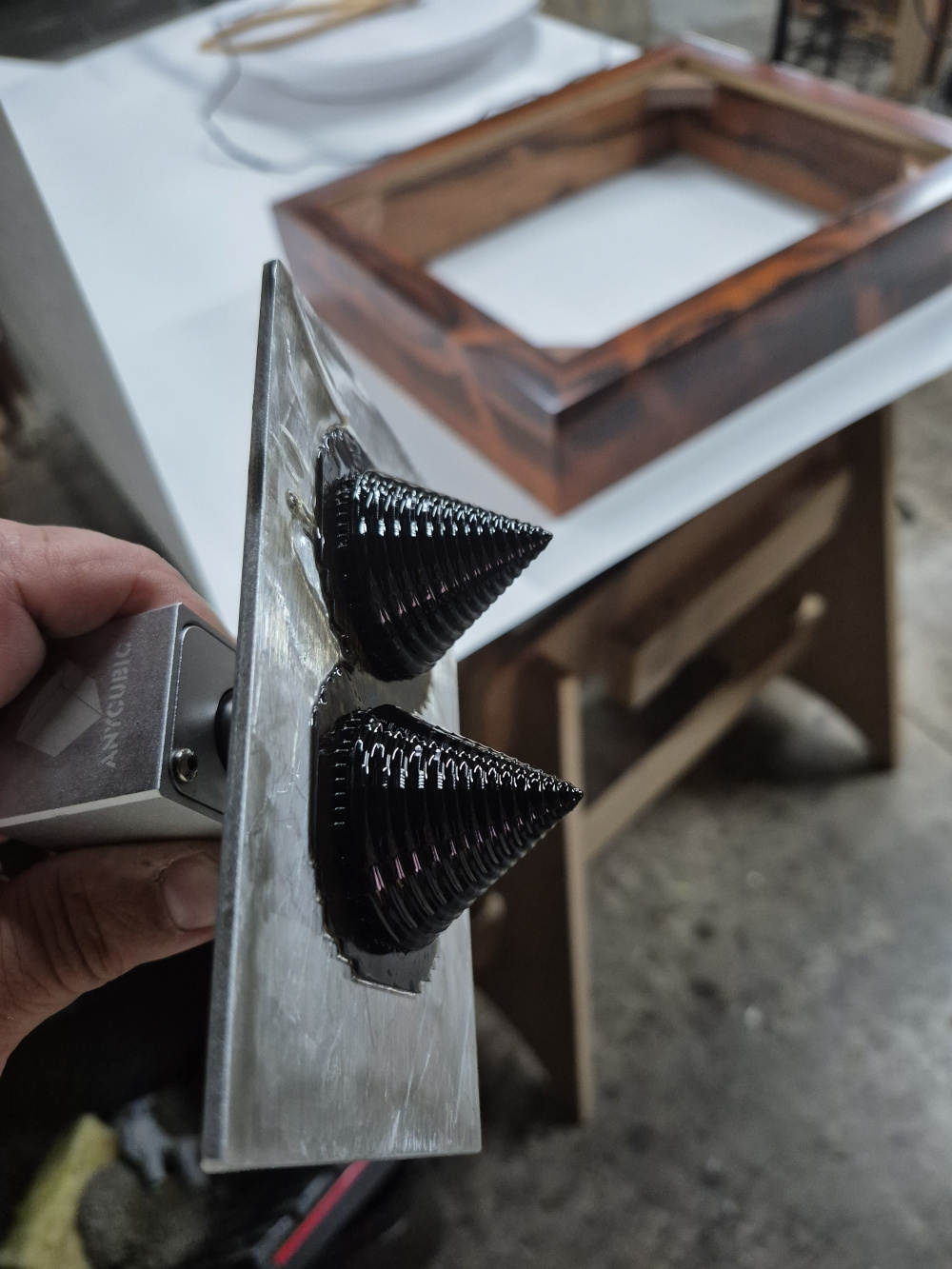

A little bit of progress on the table. I ended up doing semigloss finish on the plinth. Decided to 3d print the legs with sort of vinyl motive. Cleaned out the bearing.

Surprisingly the motor spun smooth and the speed on the platter was spot on so I decided to rebuild it.
Thanks Steve. It's not Walnut. It's a very rear Rosewood veneer. I'll post a few picks as I update.
Wow! That's going to be one of the best looking TD-160s on the planet. Great job on the restoration!!
Cool feet! They wouldnt look as nice but I could print them for you in TPU if you want them to be rubbery.
