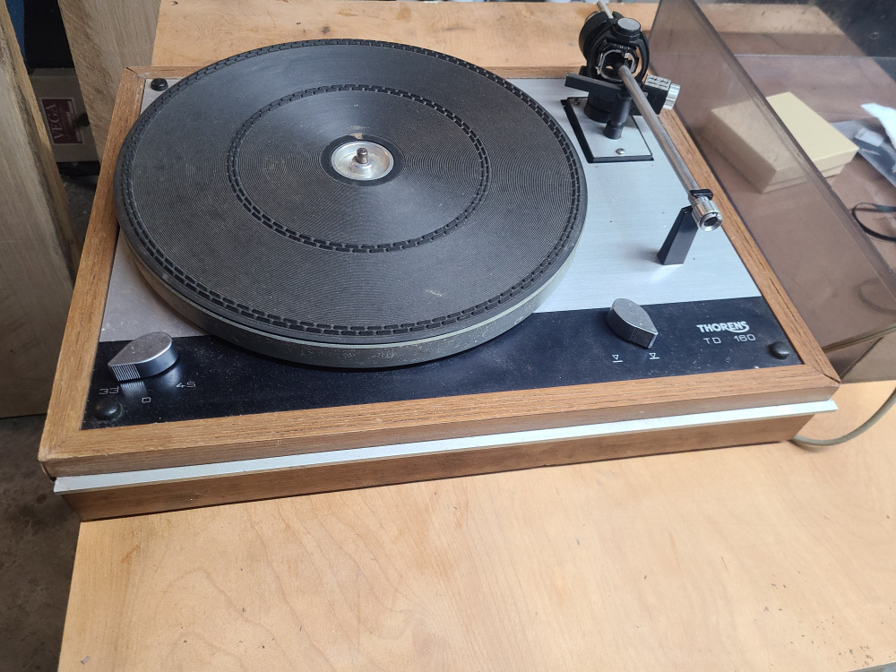

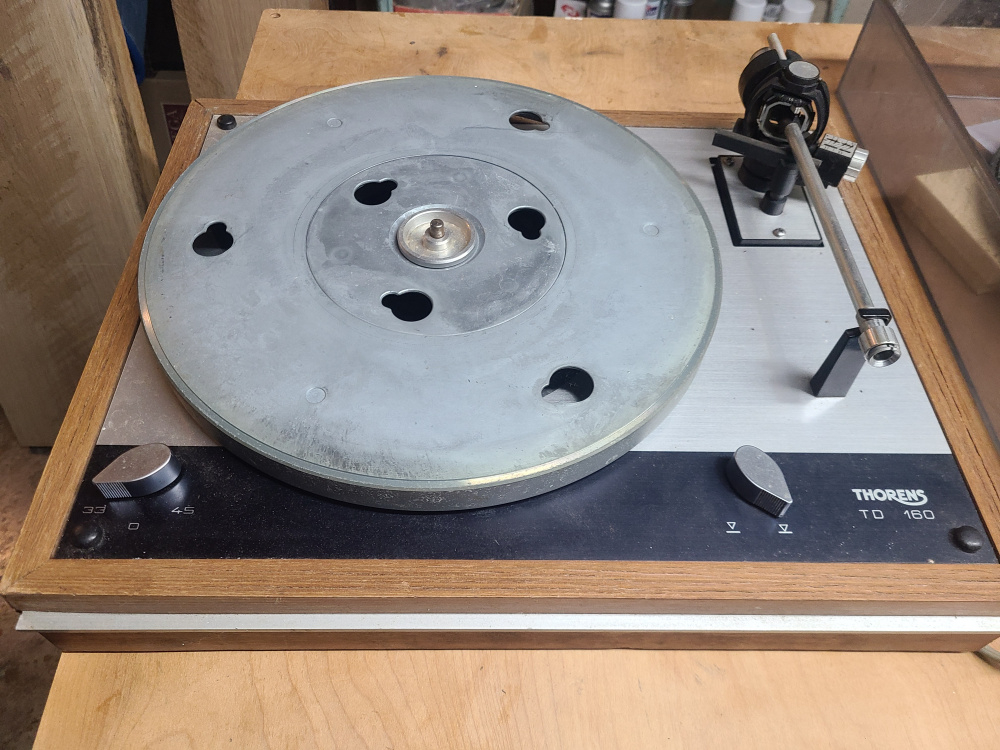

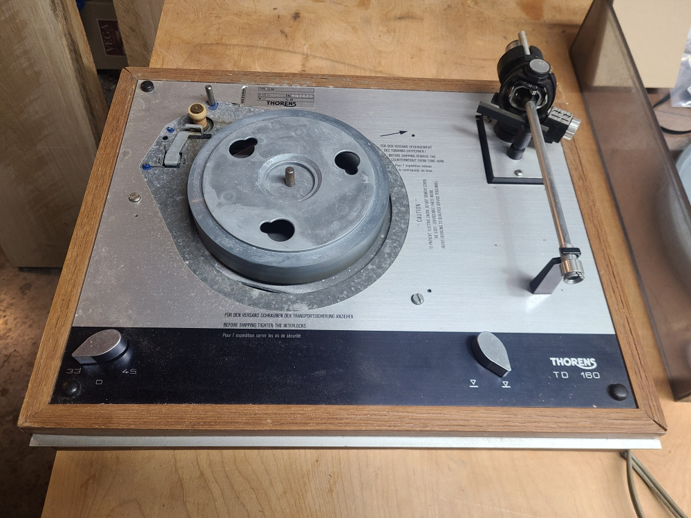

Picked up this ugly duckling for $20 on estate sale
johnny5jztajanesTurn24thtrytrawugly_wooferrjj45

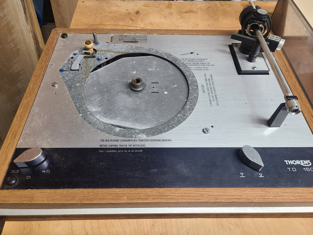

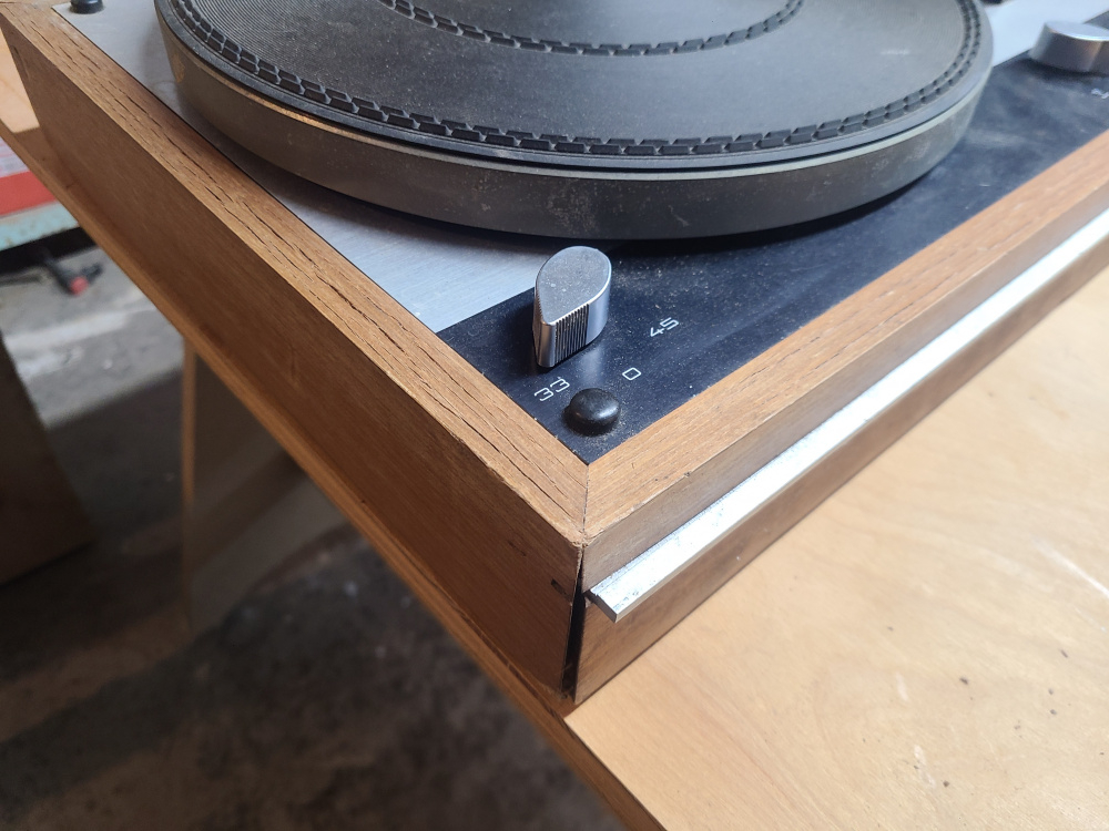

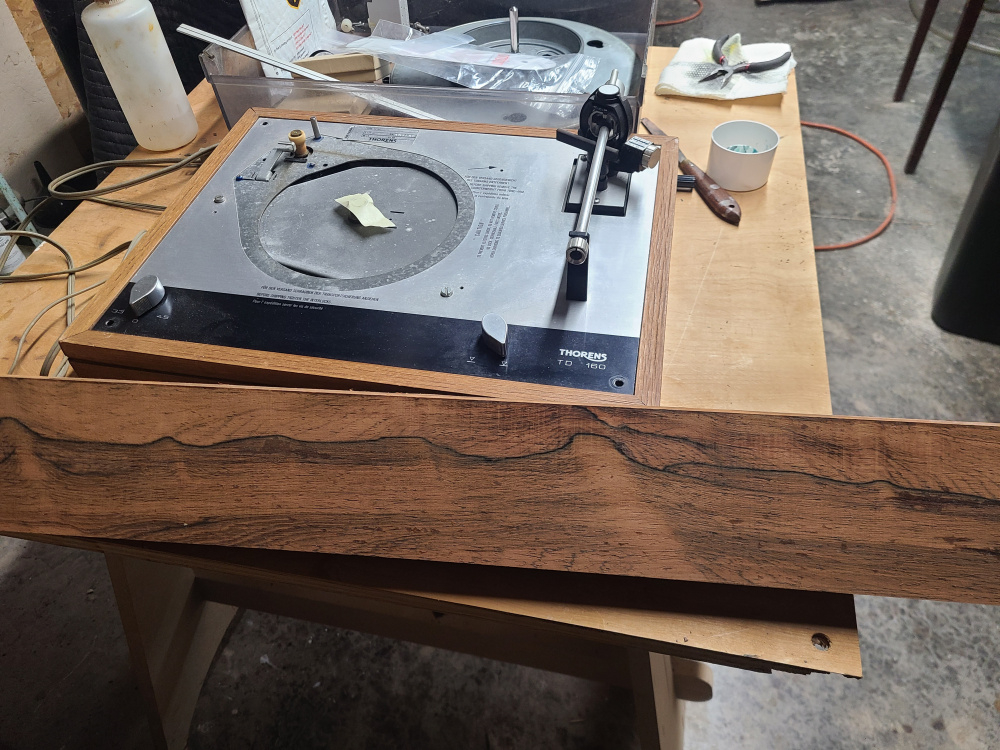

  • plinth is made from flake-board veneered in teak. It's pretty much done with. Likely humid basement killed it.
  • Surprisingly the motor spun smooth and the speed on the platter was spot on so I decided to rebuild it.

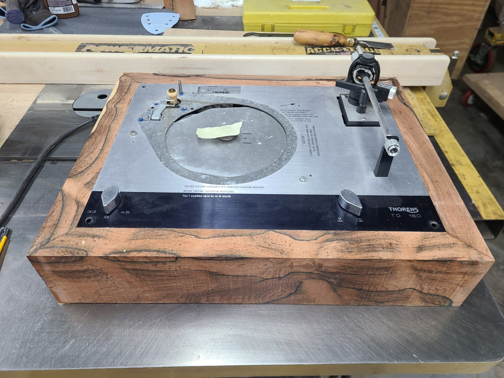

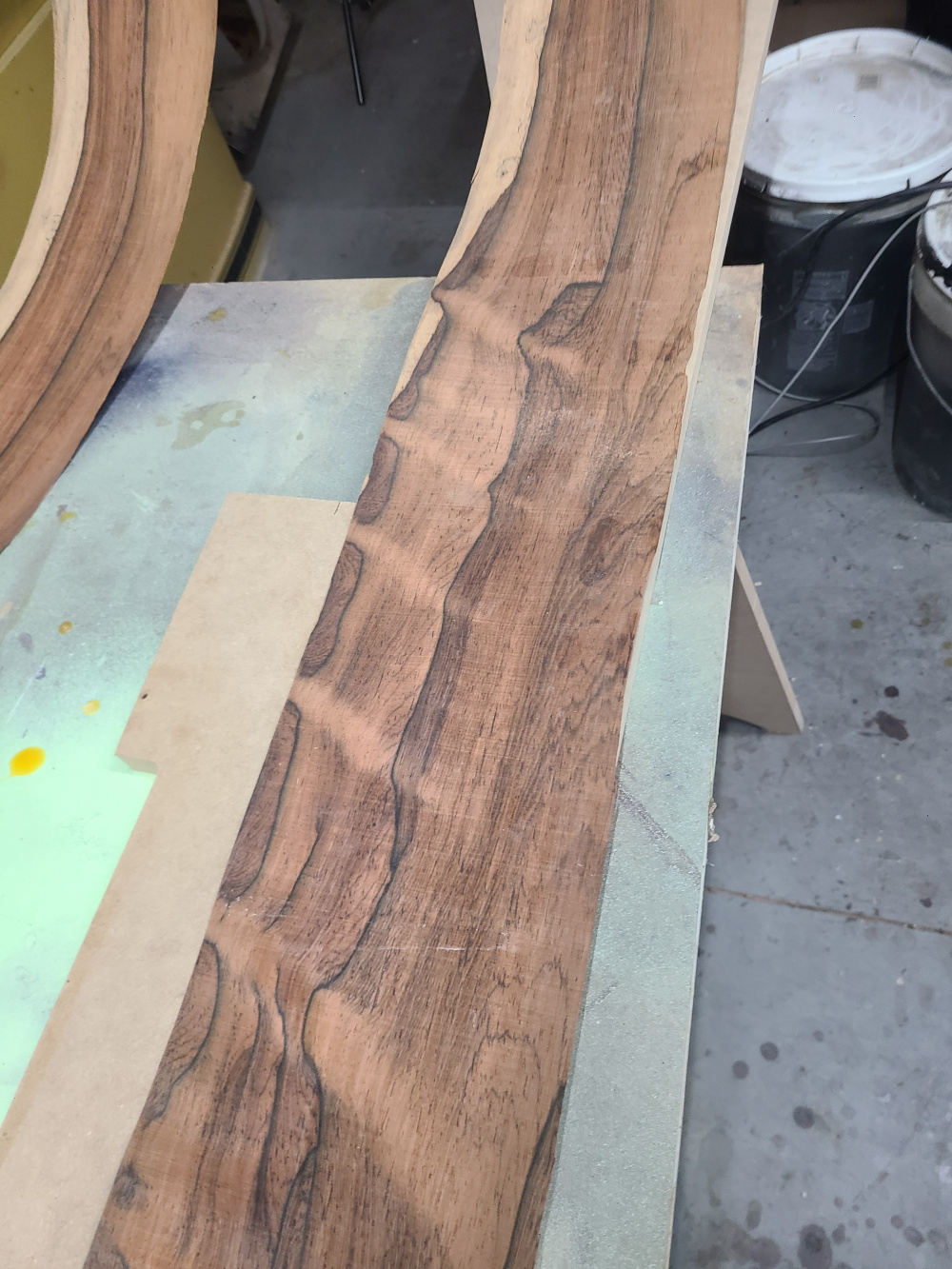

  • Sweet find and love that piece of walnut - great spalting/staining in that one.
    R-Carpenter

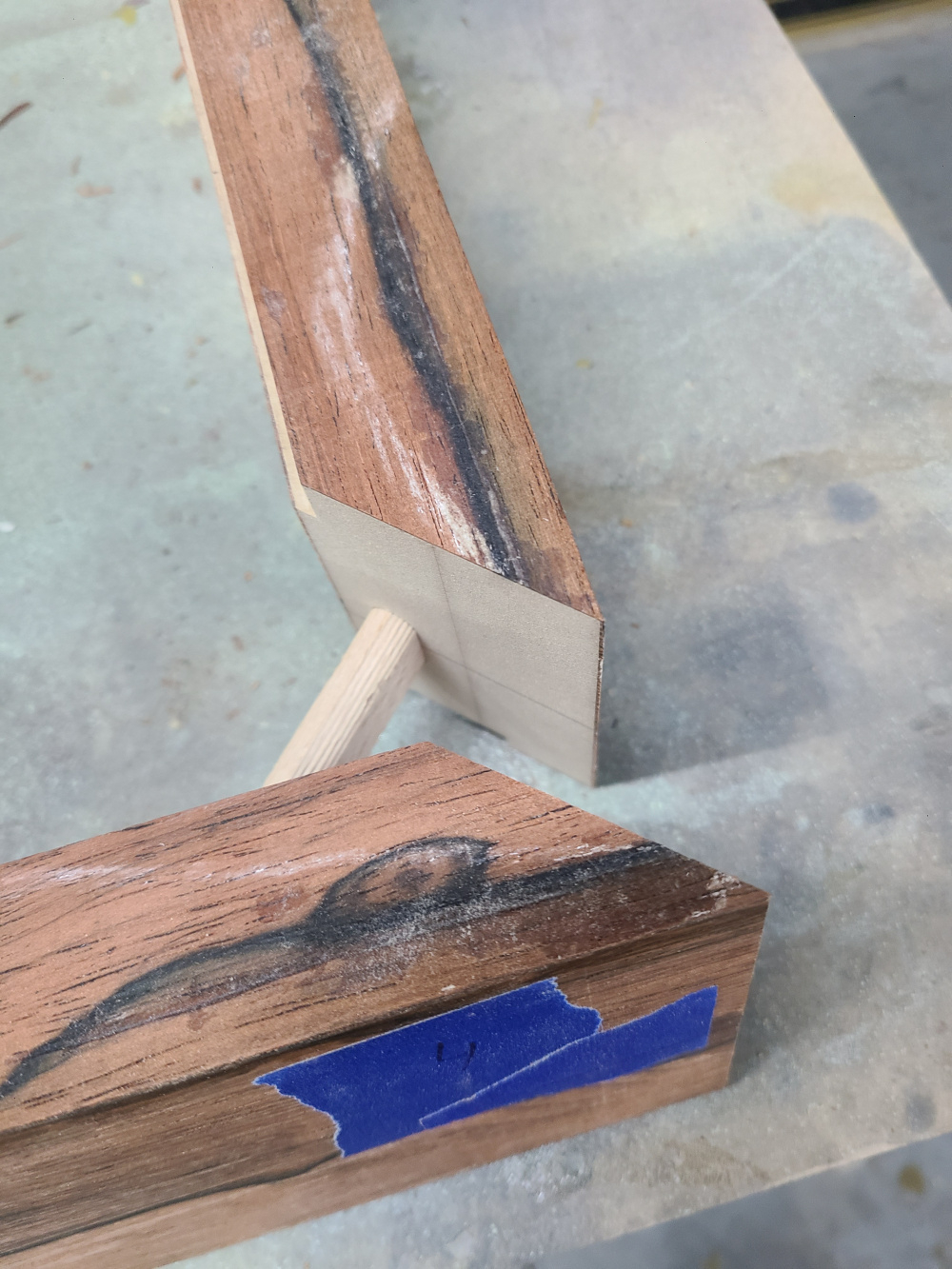

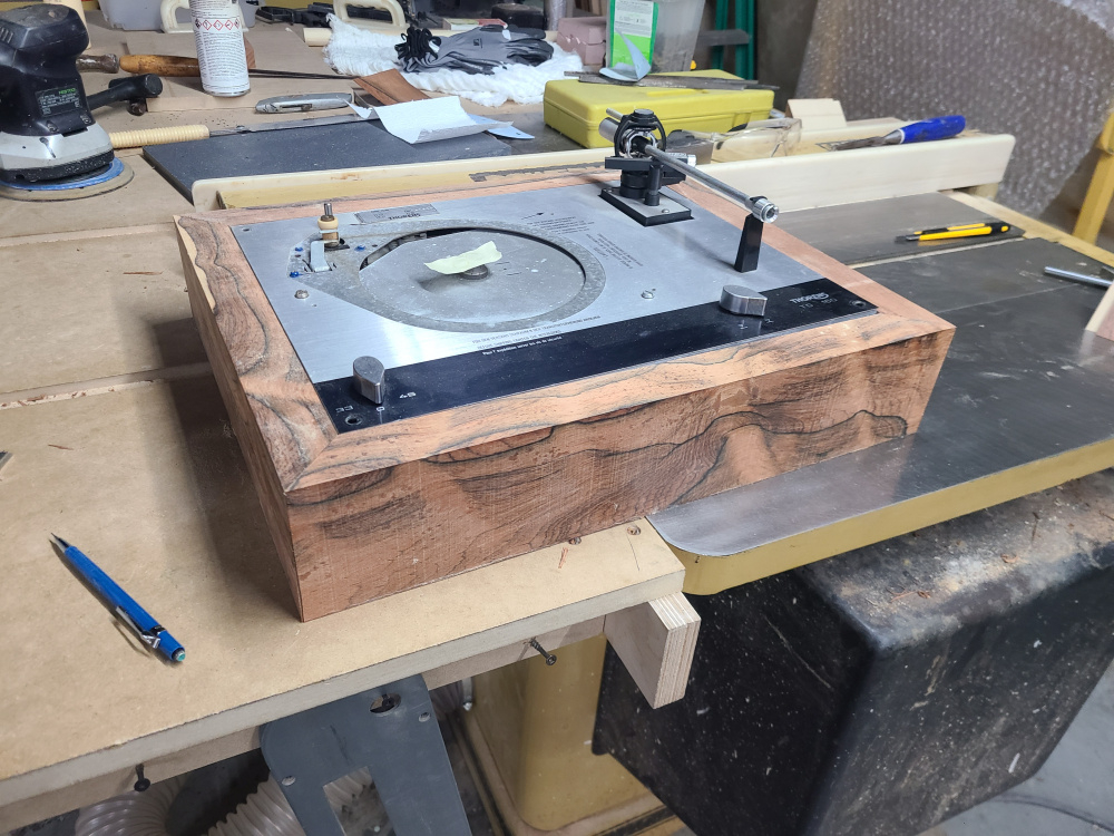

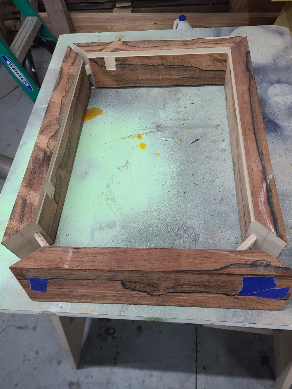

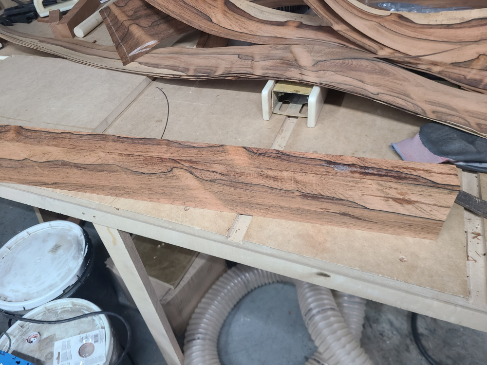

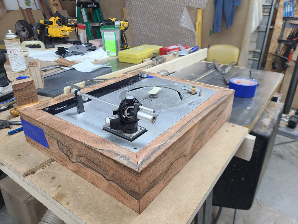

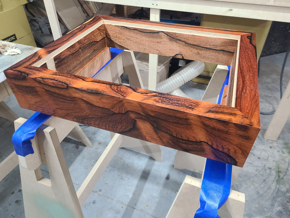

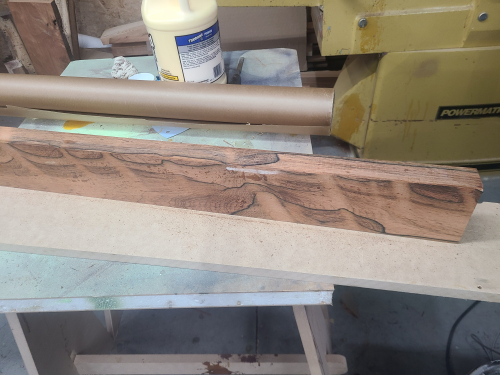

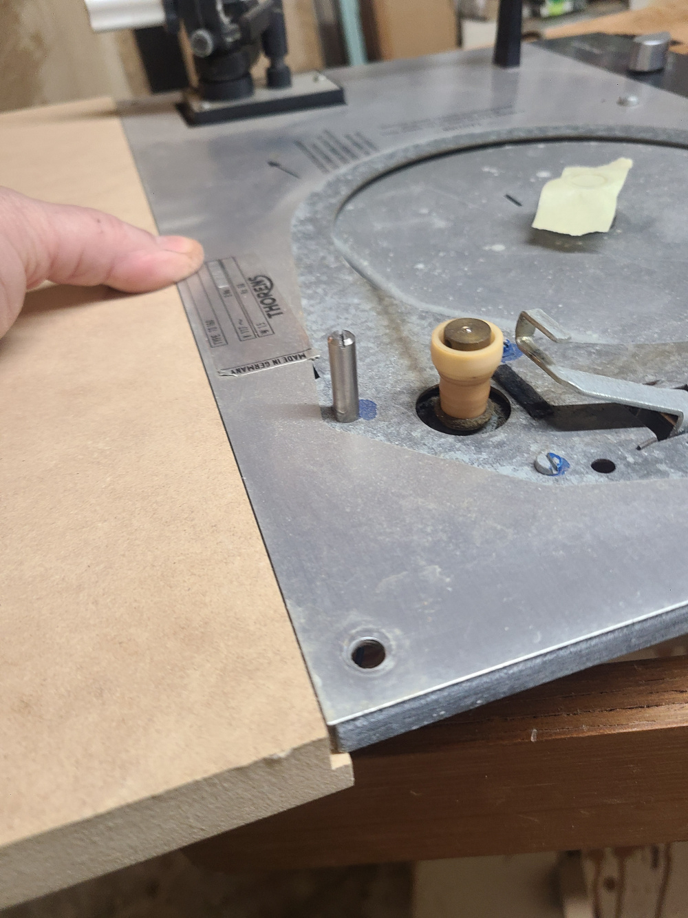

  • I have had a stash of Rosewood from 1950s. Just a few leaves left. But enough for this plinth and may be another one down the road. Core is a double thickness TruePan+ which is something of a HDF type but still, I can lift half a panel. I've decided to have the aluminum rest on the L-cut around the plinth instead of just 4 corners as original mounting.
    Thanks Steve. It's not Walnut. It's a very rear Rosewood veneer. I'll post a few picks as I update.

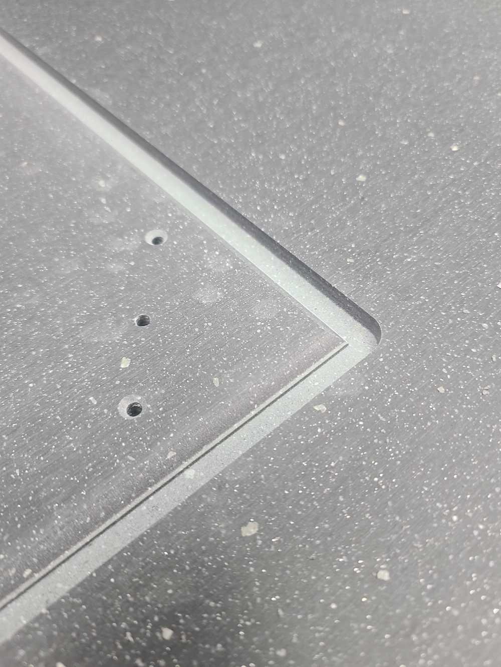

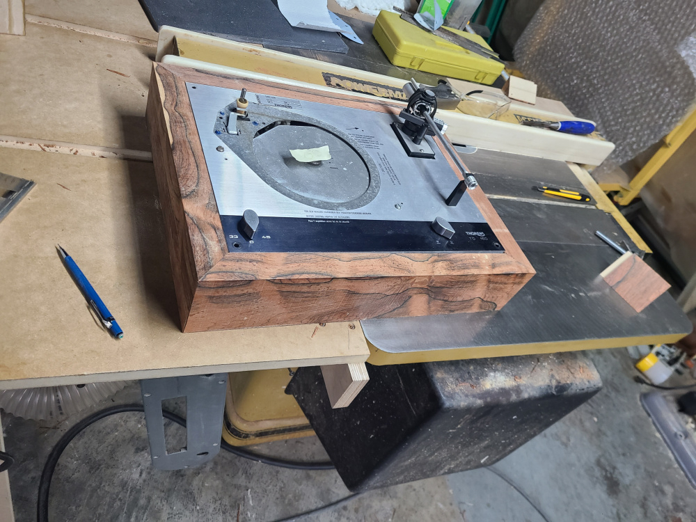

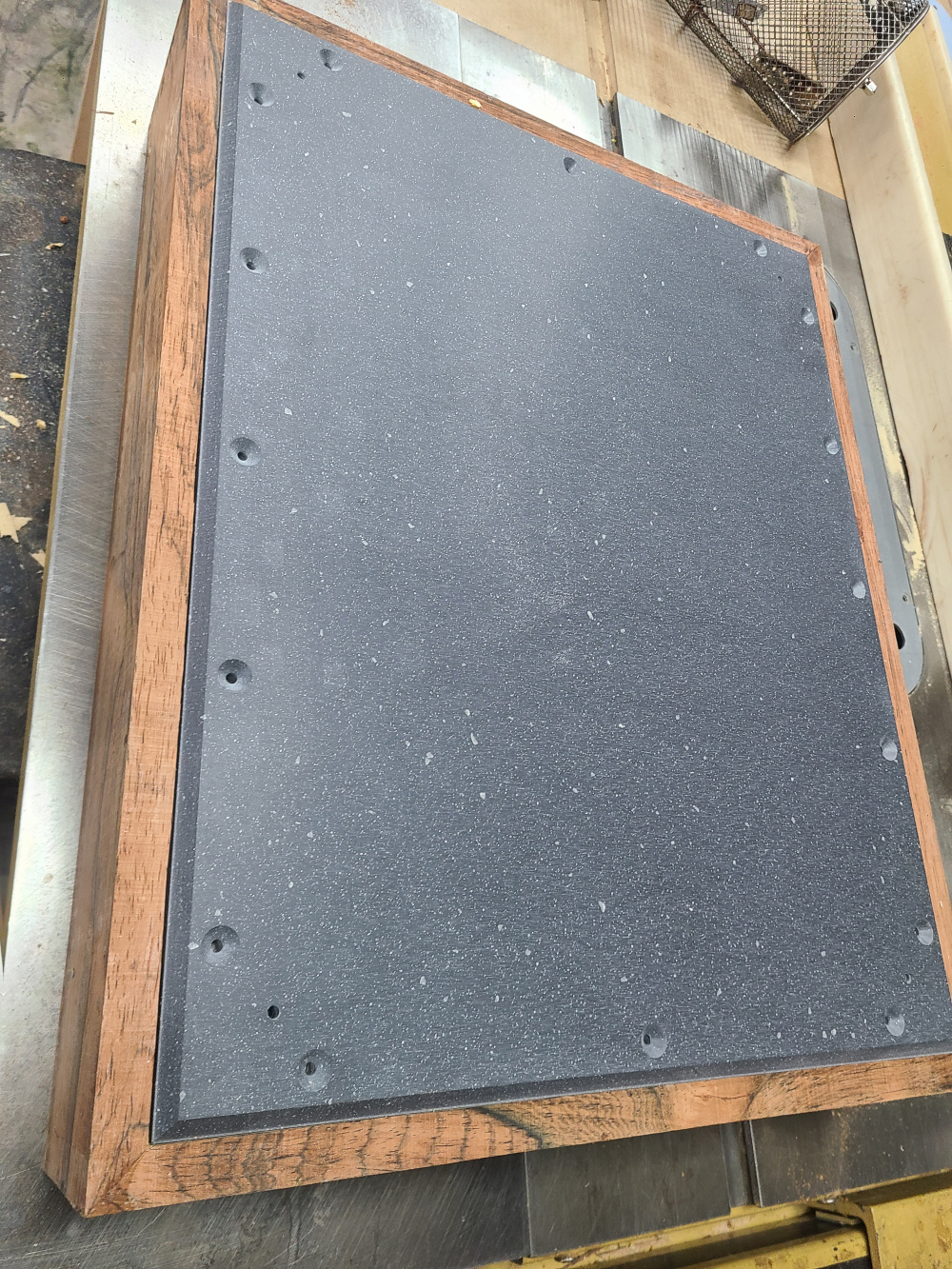

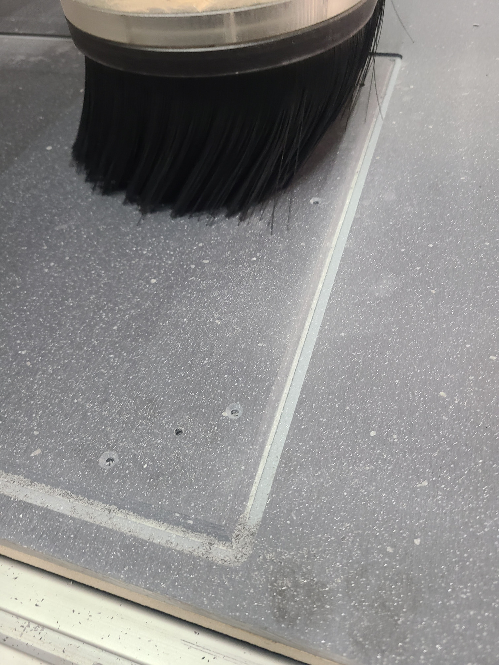

  • CNC to the rescue. The bottom is made in Meganite solid surface. I had a few scraps left over from the commercial work. So, why not. I am planing to thread the feet which I have yet to design.
  • Good old gloss nitrocellulose lacquer.

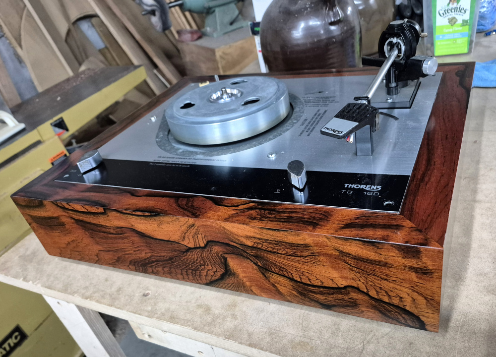

  • So, this is it for now. I need to finish lacquering, do a little polishing and start on putting things back together. Got new belt, OEM shell and new banana plugs.
    6thplanetSteve_Lee
  • Wow! That's going to be one of the best looking TD-160s on the planet. Great job on the restoration!!
  • Now, that's craftsmanship ^ right there . . .
  • Definitely a nice use of that wood. Beautiful👍🏻

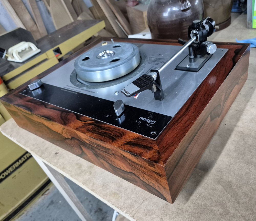

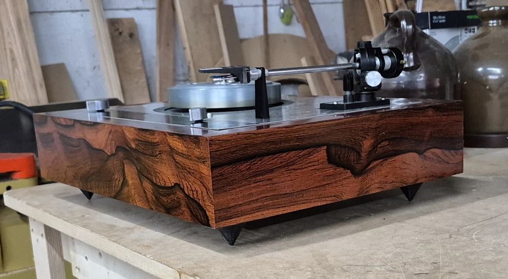

  • A little bit of progress on the table. I ended up doing semigloss finish on the plinth. Decided to 3d print the legs with sort of vinyl motive. Cleaned out the bearing.
    tajanesrjj45Steve_Leeugly_wooferD1PP1NTom_Skenrhodes6thplanet

  • very, very nice
  • Totally😍
  • What cart are you going to mount up?
  • That's gorgeous
  • Thank you thank you!
    Ortofon blue.
    I have Shcit audio Mani for a phono but may get Audio by van Alstine.
