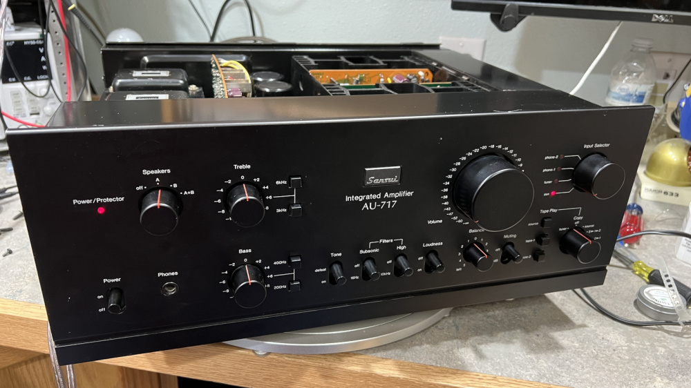

  • New (to me) amp on the bench! A Sansui AU-717 that needs some TLC. No sound from the amp section. It turned out to be open fuse resistors on the amp boards, which is really common with these. I'm replacing some caps while I'm in there and scraping off all the corrosive glue they used to hold them down. Once it's up and running again, it'll get a full restoration. There's more glue and probably some heat damage on the power supply board.
    kenrhodesjr@maccharlielaubSteve_LeeDirk
    Oooooh, that is a REALLY nice integrated amp! Very highly rated...
  • Being a Pioneer guy, I had no idea this 717 was one of the most popular & higher rated Sansui models. I did some minor work on a friend's 517 and thought it was a great sounding piece. This one is not in perfect cosmetic shape, but it's perfectly presentable.
    I got both of the amp modules running, but the preamp section has some minor issues. The R channel has some distortion and the power supply needs some work too. This glue on the PS board is killing me! I've already spent 90 minutes slathering on the acetone & scraping and I only have 40% of it removed.
    6thplanetTurn2

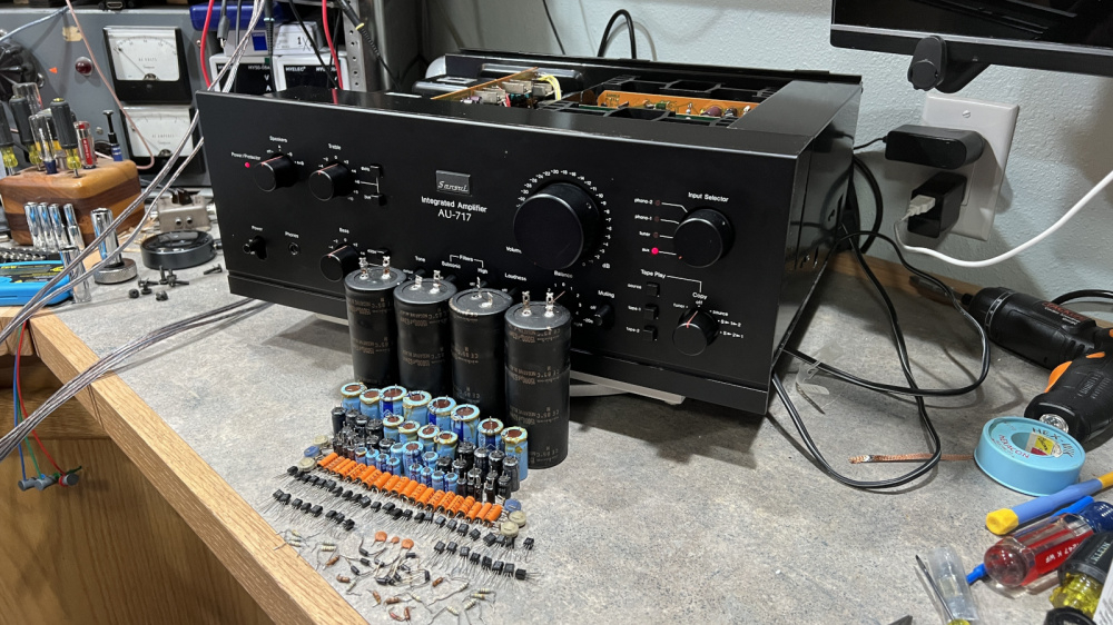

  • This Sansui is the gift that keeps on giving! I finally got the power supply board scraped clean and recapped it. I had to replace a few resistors and diodes too because the glue had started to corrode the leads. Then I attacked the tone/flat amp board. I was seeing what looked like crossover distortion on the pre outputs.
    Luckily there was no glue to deal with. I replaced all the electrolytic caps, transistors and a few more fusible resistors that had gone bad. You can see R37 & R39 got hot enough at some point to change from gray to white in the middle.
    The PreOut/PwrIn switch is another known issue with these and mine definitely has a problem. I went take the board out, only to find they glued the plastic pin fasteners on the inside! I tried acetone and that didn't do a thing. The Dremel tool was just making a mess. I ended up drilling them out with a pin vice. That's where I'm at now - it's running and sounding good, but I'm waiting for 4 new main filter caps from Mouser (get them now before the are NLA!) and some plastic fasteners from Amazon.
    KornbreadSteve_Leeugly_woofer6thplanetTurn24thtry

  • I got a box of parts from Mouser today. They are serious about packing! The 4 main power supply caps were in 3 nested bubble wrap pouches, wrapped in 3 more layers of bubble wrap.
    jr@macPWRRYDSteve_Leetajanesugly_woofer4thtryR-Carpenter
    Nice set of caps. Kemet are high quality units with very long spec sheet life ratings. I downloaded the spec sheet and noticed that these have a life rating of 26,000 hours at 85C. A couple years ago, I picked up a pair of 12,000uF, 200V Kemets from Mouser for my Heathkit AA-1640 power amp project. They are the ALS71A series and have a life rating of nearly 20,000 hours at 85C. And because the new caps were available in much smaller sizes than the original 7500uF, 100V caps that came with the amp, I was able to find 200V drop in replacements to give me a better safety margin as well as nearly double the original capacitance. The rails in my AA-1640 are running at +/- 91 volts DC.
  • That Heathkit amp is a brute! I just looked at the schematic and see 8 output devices/channel! That's an amp you could probably use to arc-weld. =)

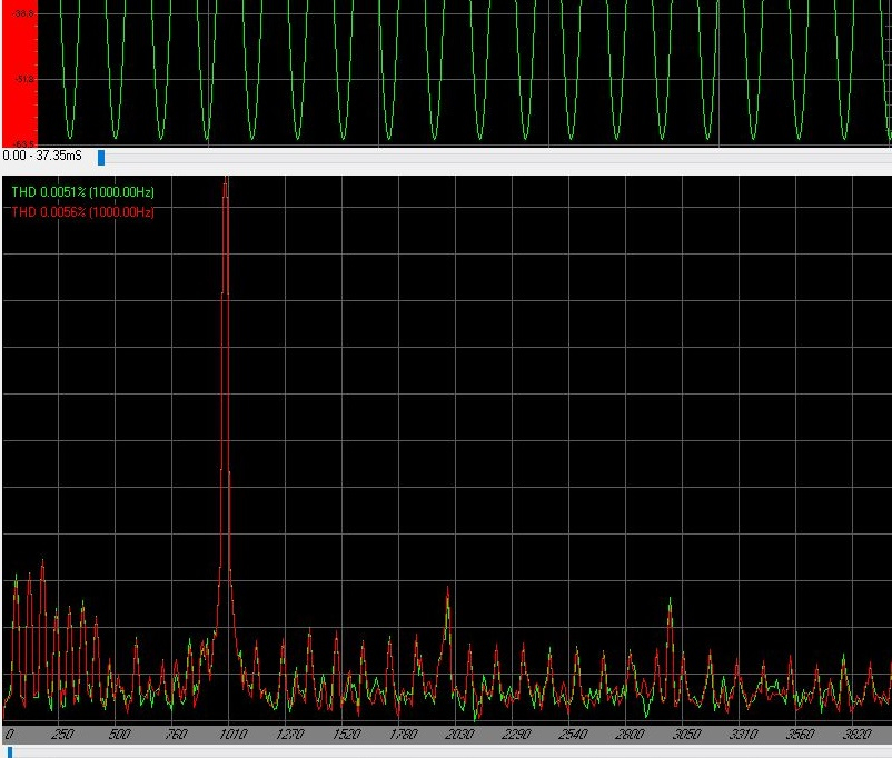

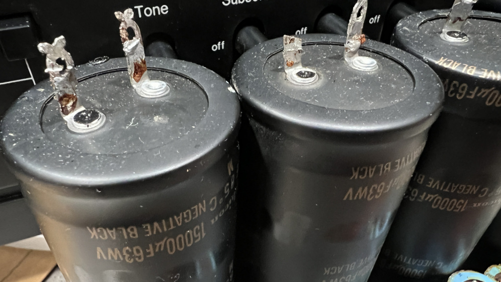

  • I finally got the Sansui finished up last night. This thing had multiple issues and I'm glad I bought those big main filter caps. You can see the a vent just starting to pop open under the gasket on one of the originals. I made a few stupid mistakes along the way, but luckily none produced smoke. I replaced a grand total of 150 parts, some due to being in contact with the glue. It hits 105W/ch at 1K into 8 ohms. Distortion at 2.88v is ~ 0.05% THD at the speaker outs. It sounds great on the bench with my little TCP115/XT speakers and despite a few dings on the faceplate, it looks really good - well, at least for a black-faced vintage piece.
    ugly_wooferPWRRYDtajanesColonel74thtryScottSEggguyTurn26thplanet
  • edited April 15
    I missed a 0 on the THD - it's 0.0051/0.0056.
    ugly_woofer4thtrySteve_Leejohnny5jz6thplanet
