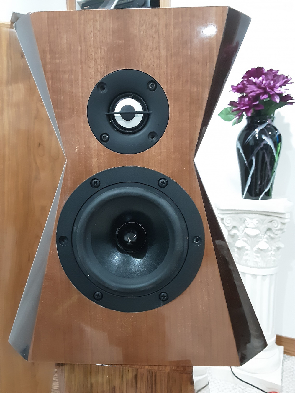

  • I finally got some clear on this sub.
    jr@macWolfSteve_LeehifisideNicholas_236thplanetTurn24thtry
  • I have a bad w4-656 mid woofer. Something got into the gap and now rubbing, so I had to find a driver with the same diameter basket. The only viable option was the Dayton RS125P, so that's now what I'm using. Of course the crossover is different, and I'm trying to get it finished before Indy.
