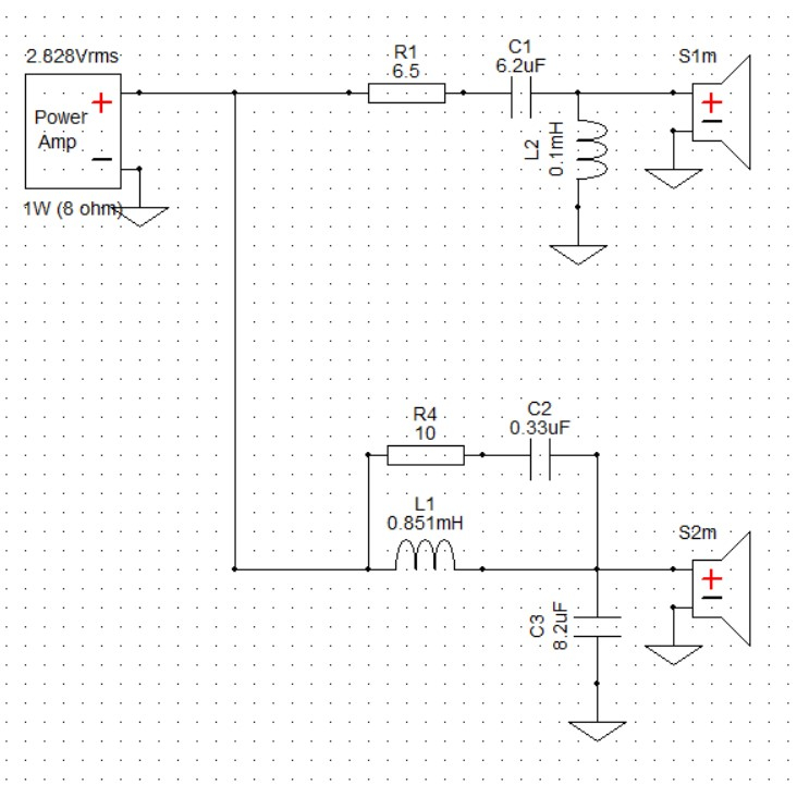

  • I have a bad w4-656 mid woofer. Something got into the gap and now rubbing, so I had to find a driver with the same diameter basket. The only viable option was the Dayton RS125P, so that's now what I'm using. Of course the crossover is different, and I'm trying to get it finished before Indy.

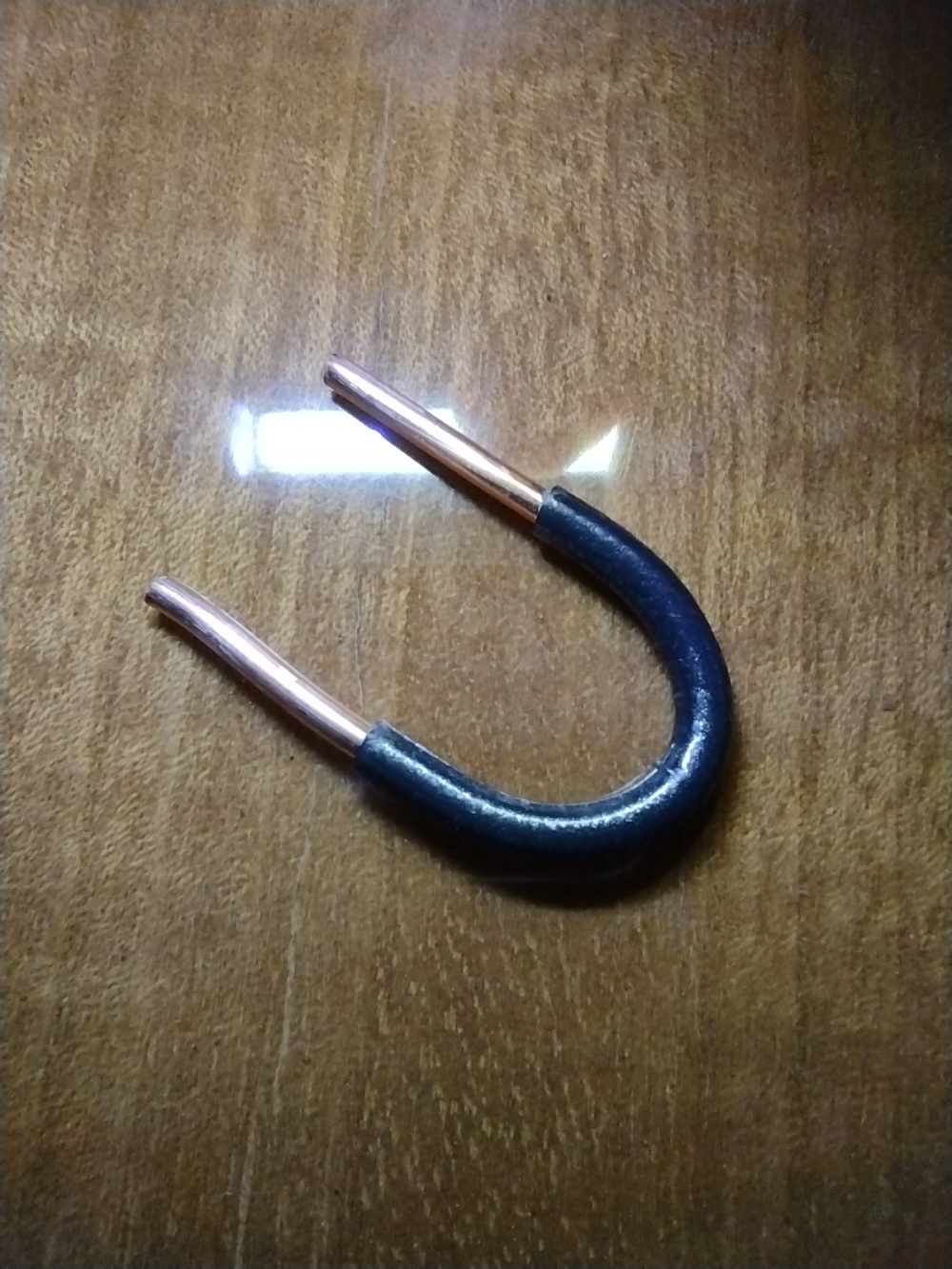

  • I was playing with tweeter levels and came up with this in order to short out a resistor. It's a pair of 2mm banana jacks meant for meter probes and I found that a #12 solid wire fits nicely as a jumper.

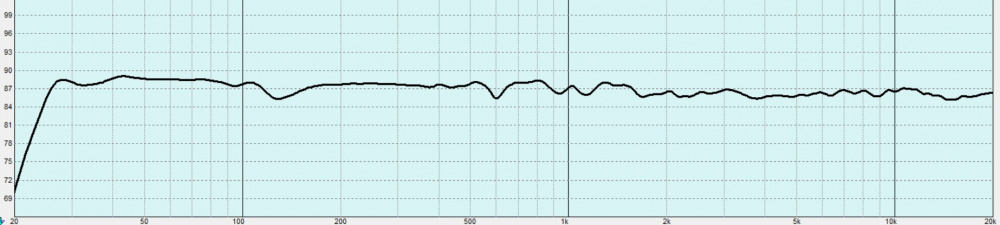

  • Here's all the near's and far's combined.
    tommytunes50tajaneskenrhodes4thtry6thplanetSteve_Lee
  • Picture perfect 👍

  • This is the final crossover, it's less complex than the one for the TB mid bass.
    jr@mactajanes4thtryPWRRYDkenrhodes
  • Elegant, love it!
    tajanesugly_woofer
  • That is impressive results for the low amount and value of components.
    ugly_woofer
  • Sometimes you just get lucky.
