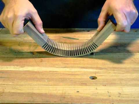

I remembered seeing someone doing kerf cuts to bend sheets of wood so i wondered if MDF would be a good candidate for it.  It ended up working really well!  I placed kerf cuts at the areas that needed to bend.  The baffle will be hardwood of some kind.  I will cover the MDF with a wood veneer or paint it.

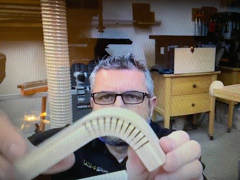

  • I am not sure what you mean.  Kerf is the thickness of the saw blade.  I knew my tightest radius was the top portion.  So i did a test board to figure out the spacing between cuts.  You can see on that 1/2" MDF it is about 1/4 of an inch between each kerf cut.  I found this good video on the process.
  • This seems a lot easier than bending sheets of 1/8. I've played around with kerfs on scraps of mdf and was surprised it didn't break. Do you plan on filling the slots to increase rigidity?

  • Kerfing Plywood Jintani Speaker Project

    I just did my first kerf project with 18mm Baltic Birch ply. Used Gorilla glue to fill the kerfs, and had some problems filling all the voids, but resulted in a very strong bend.
  • How are you guys calculating the curf.  Are you adding up the angle of each cut and depth to reach the desired angle?
    I've heard (Javad S) that there are kerf bend calculators on the web, but I haven't found any.
    You've got to play around with some scraps to figure out spacing and depth.
    If the depth is not enough, bending is really difficult - if the depth is too deep, you will get cracking or splitting.
    I found that about 1 1/2 layers of Baltic Birch worked well for me. One nice aspect is that once you have your jig set up,
    the cuts can go very quickly.You will need some strap clamps to make the bends on your production box.

    In any case, it doesn't look like Chad did any calc to determine the bend radius, just closely spaced the cuts so he has more than he needs, and the bend radius is determined by the board it's wrapped around. This may actually have some benefit, as cuts with a wide spacing may make for a less curvy bend with points where the kerf cuts are.

    When I started to look at kerfing, every example showed bends where the inner part of the cuts all touched.
    I felt that the bend would be plenty strong if filled with Gorilla Glue even if the inner parts were not touching,
    and allowing for "extra" bending capability gave a little more leeway when gluing up the bend.
    That looks like a correct assumption.
