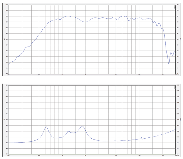

  • Ben, you might be right but Im hoping that it remains smooth. I'm hoping that it easy to work with, the graph looks promising.

    I wonder if that dip in the response and the spike in the impedance around 2k is a resonance of the the back cover. It looks like the same plastic cover you see on alot of CDs. Maybe try silicone on a heavy washer as a mass damper?
  • That took me down a rabbit hole...
    The Rosso vs the Bianco, the Rosso is clearly better but this isnt an all out build.
    It seems the exit angle and the cast back are the 2 mechanical differences. The replacement elements are a different part number as well but couldn't find why they were different.
    The back chamber is probably where the most improvement could be made. Since the anomaly is in the impedence plot it makes me think I could isolate it with some trial and error and testing with DATS.
