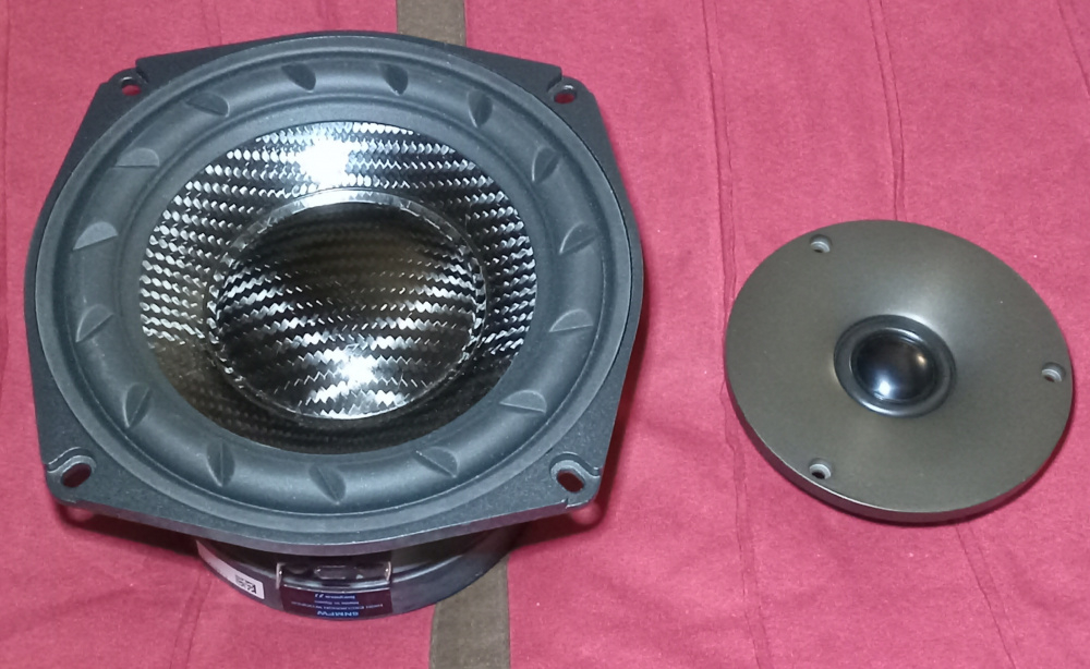

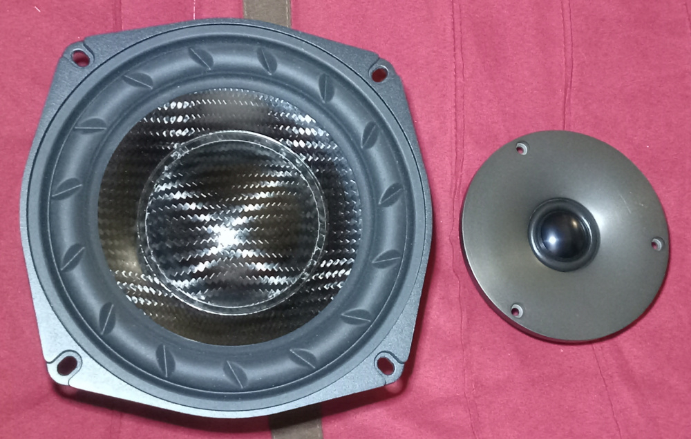

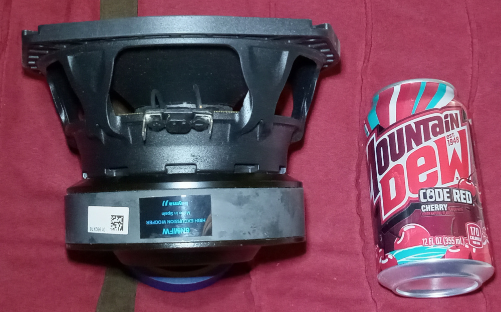

I have not decided on a name yet, but had to post some images of these great looking drivers. Thoughts are currently Monarchs or Plus Ultra for a badge. They sure seem to exude the Plus Ultra Spanish mantra. That is for sure.

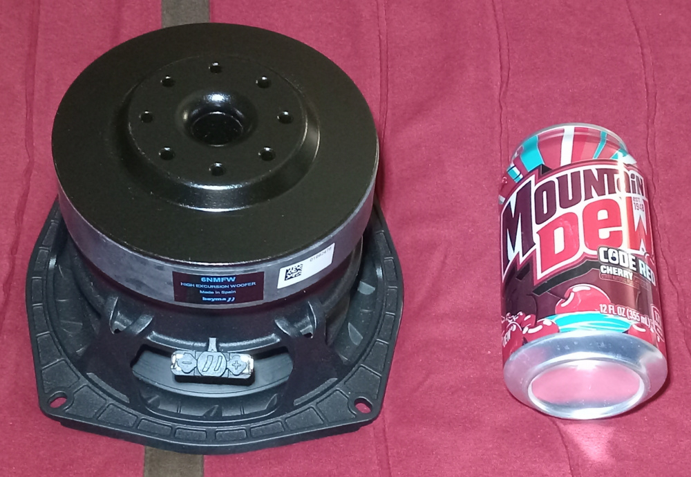

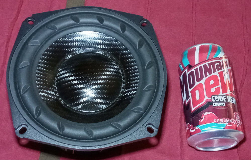

The woofer has to be the beefiest 6-6.5" nominal driver I've ever had or used. Frame curve to curve is about 7", but mounting hole center to center is 7.5". By Dayton measurements, even with the pincushion cast frame, I would call this a 7.5" woofer (7" nominal, not 6" as it is labeled). Other features include a 2" VC, double spider, Maltcross and 3 venting paths for a cool operation, 3 shorting rings, 9mm xmax and 43mm p-p xmech, a resonance reducing surround, and a stiff carbon fiber cone.

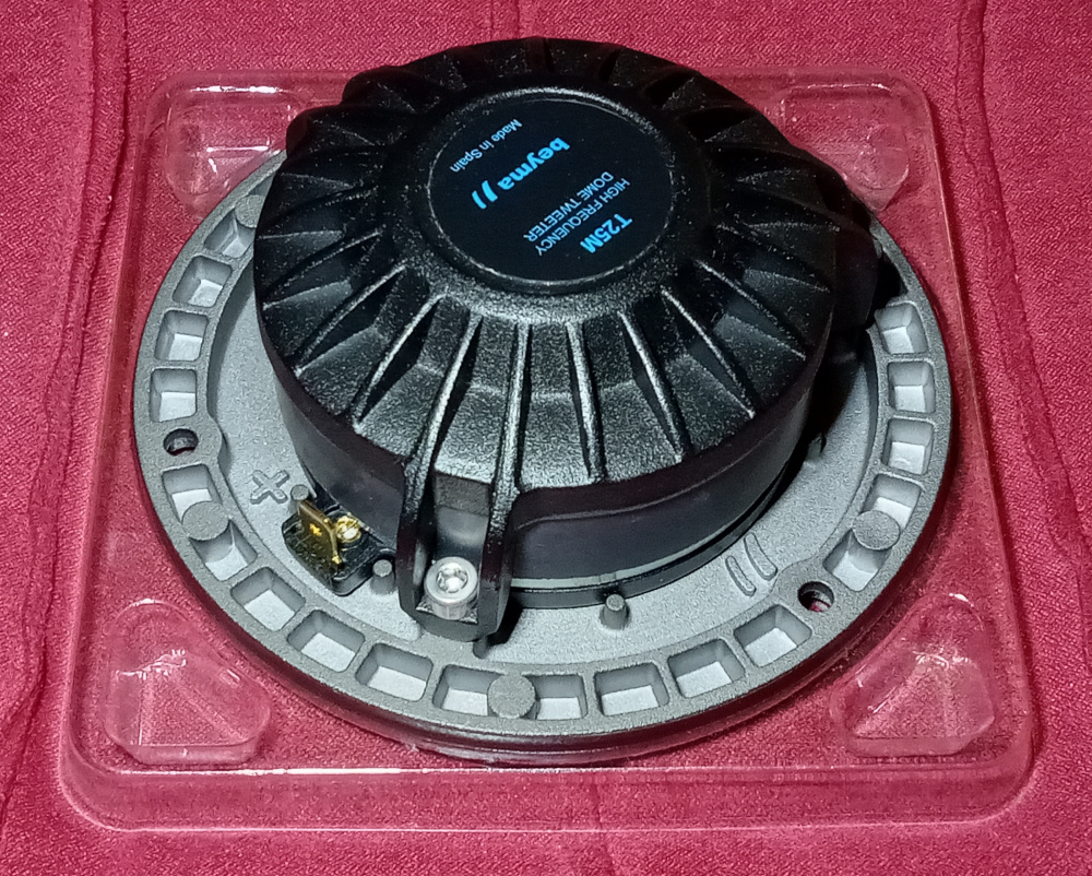

The tweeter is an Al/Mg dome with a polymer surround in a thick cast waveguided faceplate, bolted to a cast aluminum chamber. Fs is well damped, and Vance says it does not use ferrofluid. The color of the waveguide appears to be finished compared to the other side being natural as it is closer to a pewter shade.
Feast your eyes...

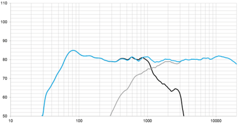

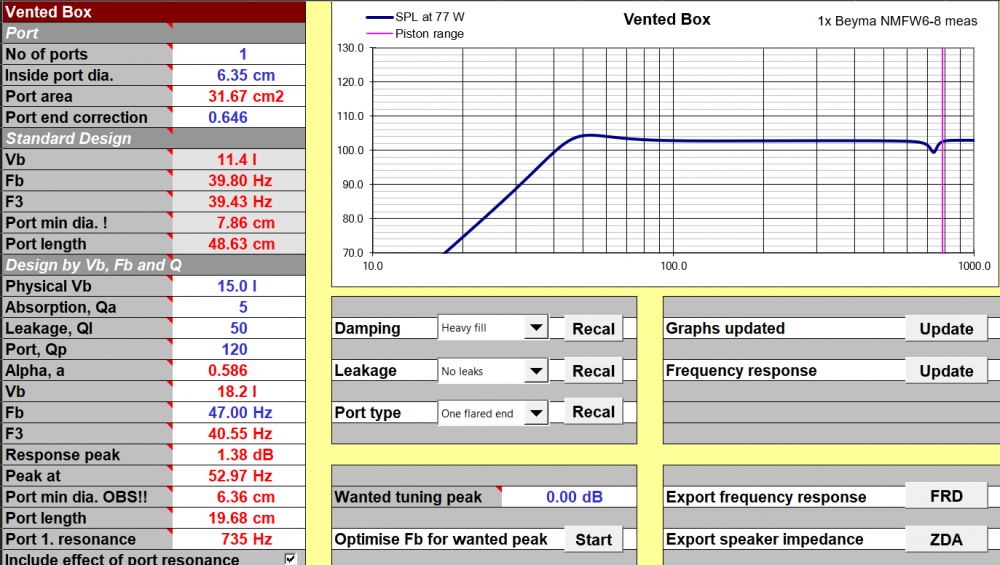

    There is a build note from Beyma, including a modeled xover for both M and S tweeter versions, and a set of cabinet dimensions and such. I've attached it here for reference.
    I will be trying my own methods and see where I end up. My thoughts are to suppress the tweeter breakup, and see if a smaller cap flattens response first and go from there. I will likely try to suppress woofer breakup a little more, as that is my usual MO.

    Like me some Al/Mg domes. My naive look at the freq response in that pdf implies serious chest thumper - though know that for their xover, overall speaker design

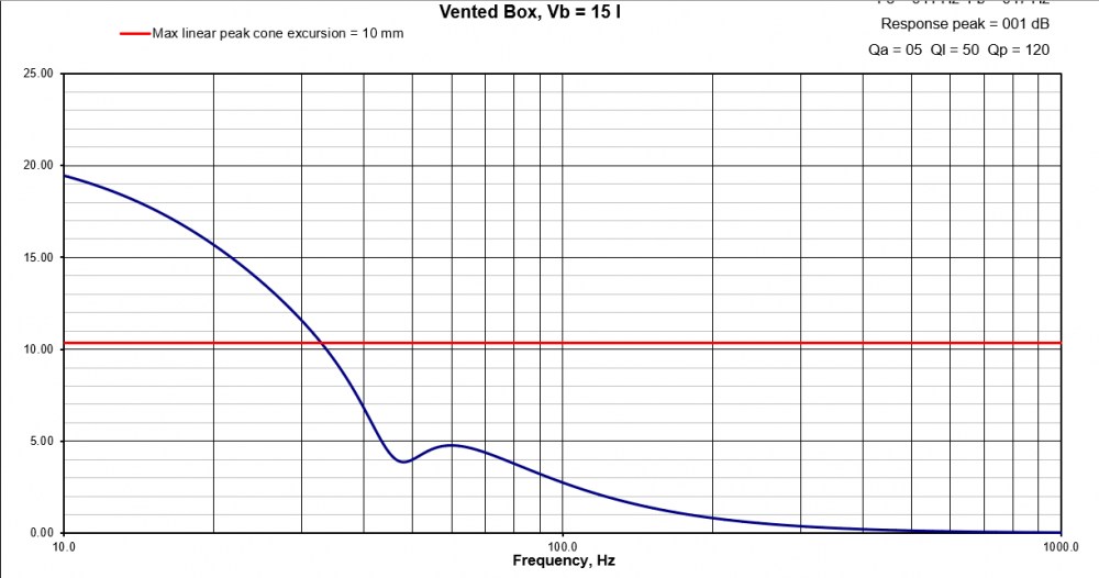

  • I've never build with Beyma - but you gotta love having Xmech be 3-4 times Xmax
  • Me neither, but I'm looking forward to it!
  • Excuse my ignorance, why would you find this attractive?
  • @Gowa said:
    Excuse my ignorance, why would you find this attractive?!
    I'm betting Ben gets the port tuning corrected...
  • That might be a measurement artifact, uncorrected nearfield.
  • edited August 13
    Since you are perusing the Beyma notes; You'll also notice then that the 2 different tweeter builds have different bass Fb tunings according to the system impedance plots. This does not match the FR of the woofer in the 2 different systems, as one should be peaking and one should be flatter, yet, they are the same as shown with the same baffle, xover and woofer. That doesn't add up. It could also be a nearfield bass curve too (JR beat me to it).
    My thoughts are that the 47Hz tuning is flatter than shown, and that both system FR show the woofer tuned to 52-55Hz or so. It just so happens my VersaBox is tuned to 47Hz, and most any 6.5" woofer thus far has performed splendidly well in there. I'll find out my preferences.
