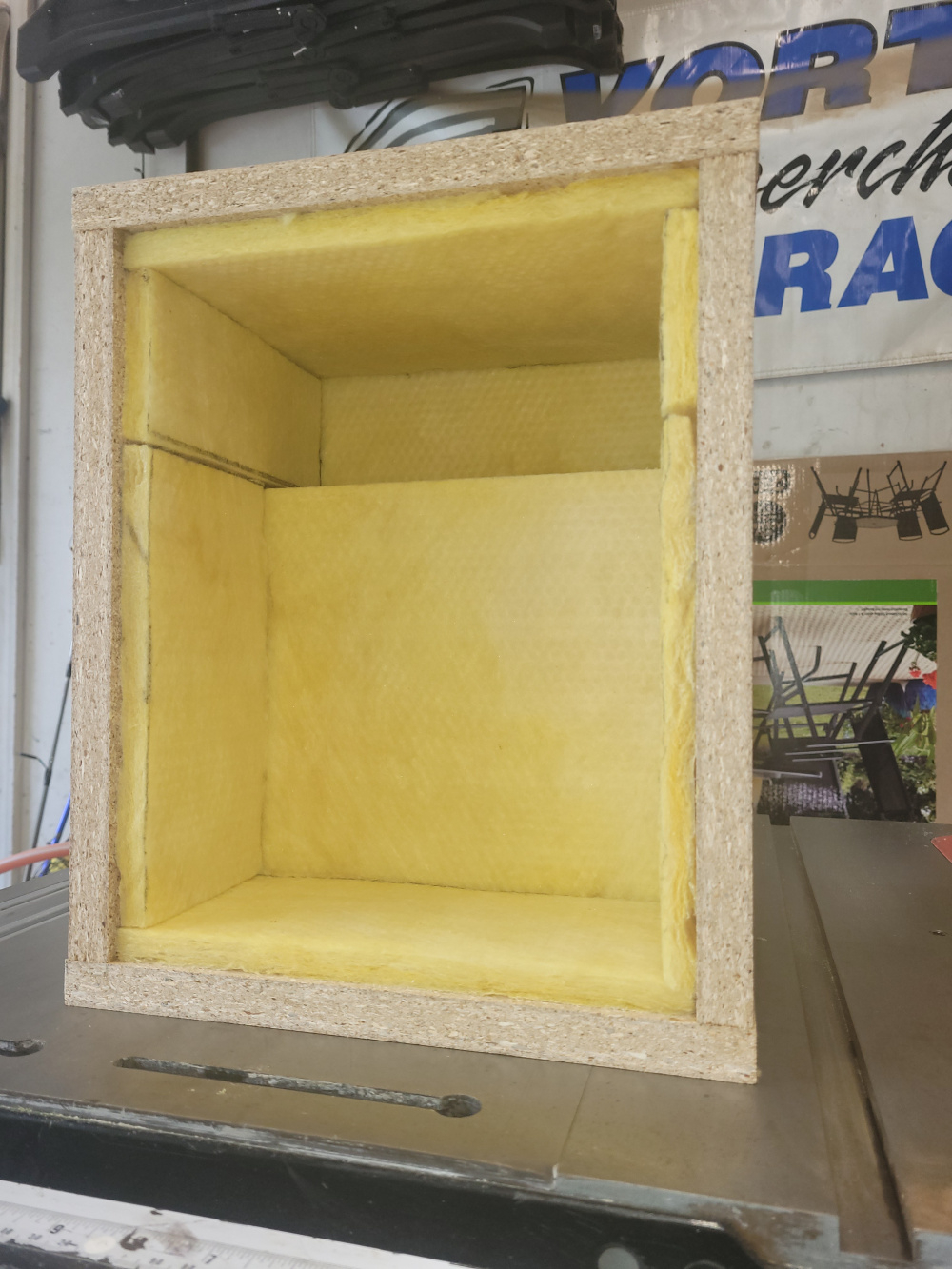

  • I posted this in Nick's thread. These are the MT boxes:

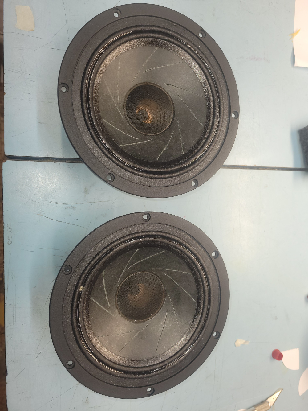

  • Those PM180 drivers are supposed to have very good sound quality - there was some use of them some years ago modified by slit cone technique. I've got a quad on the shelf now for a future project.

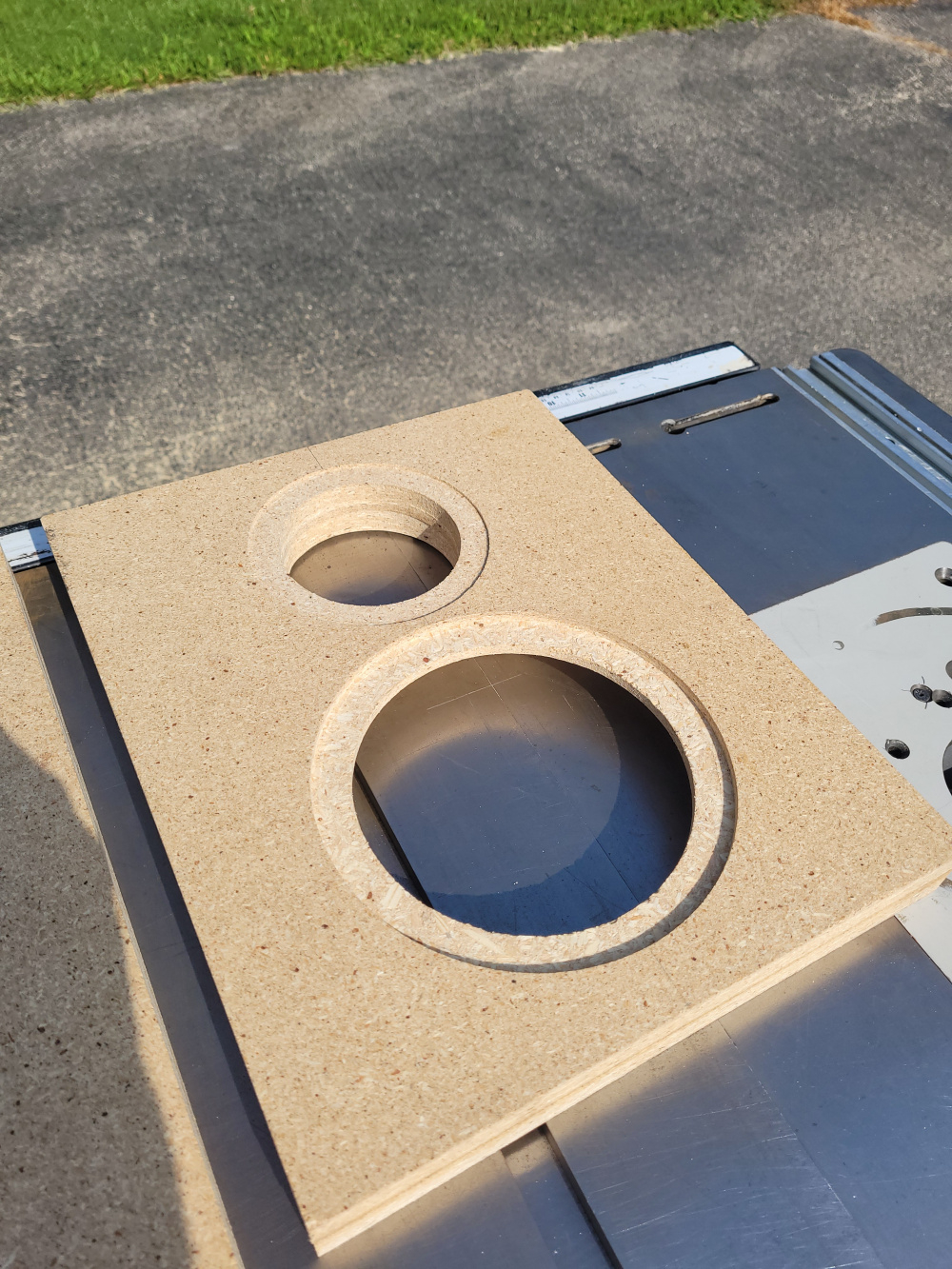

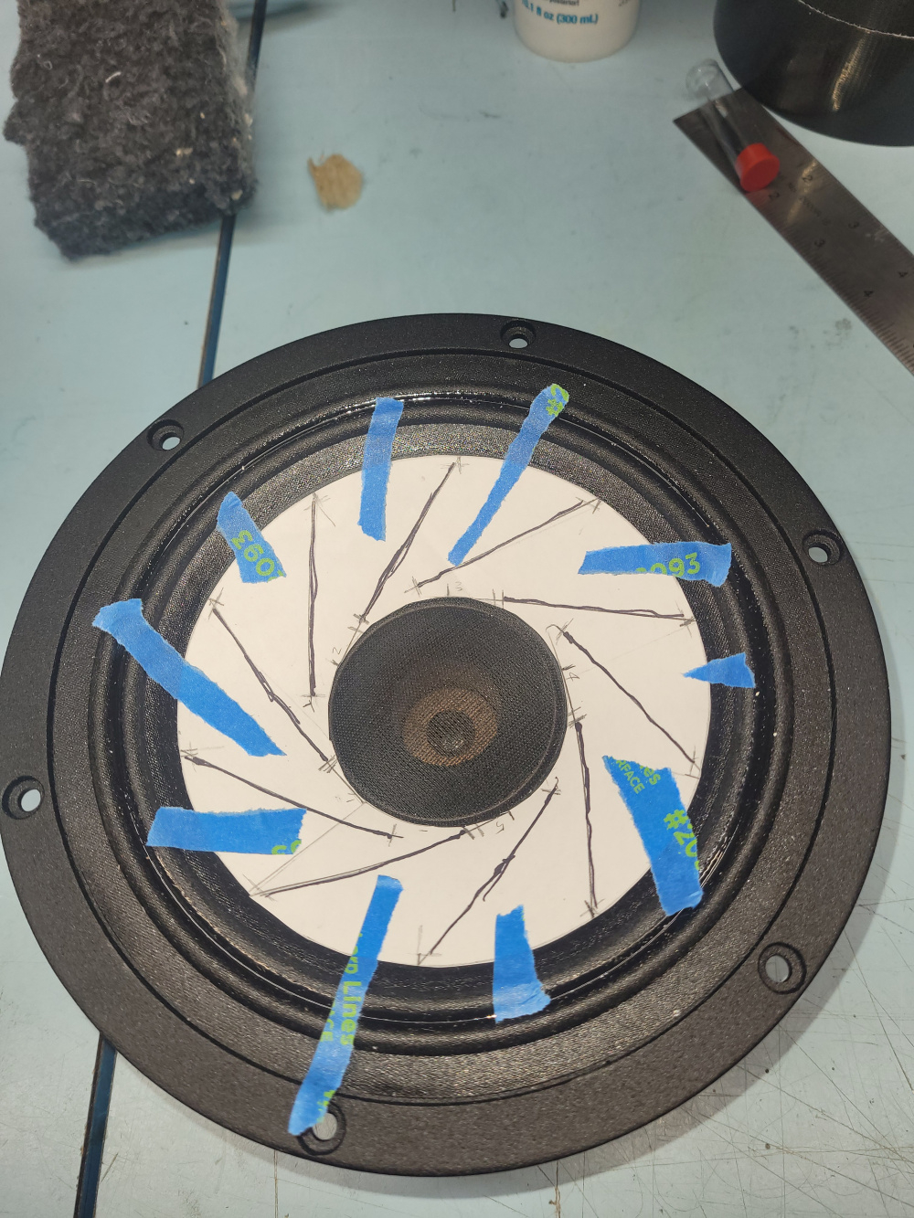

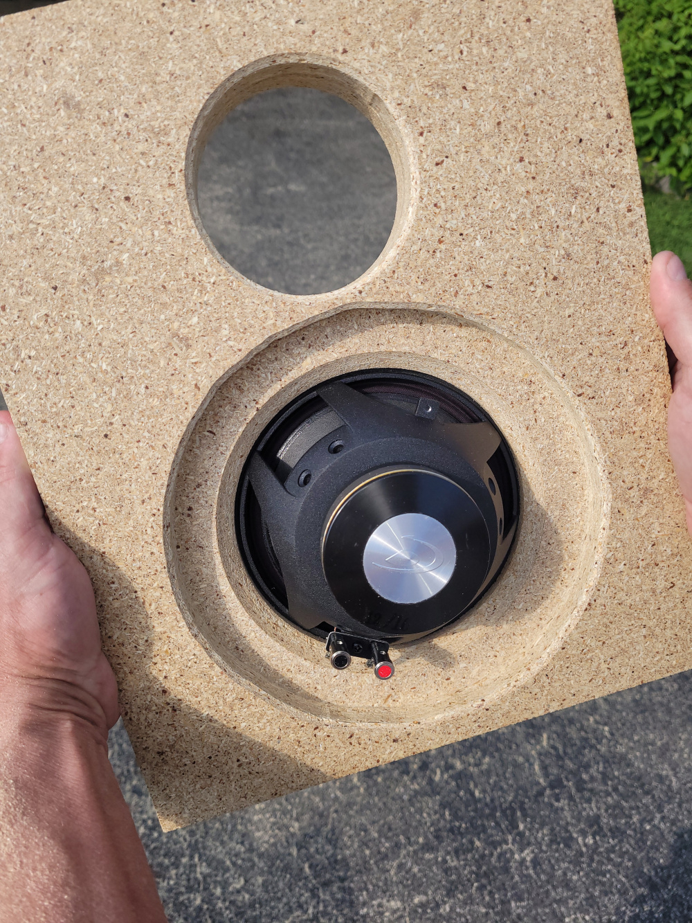

  • I do plan on modifying my pair. Seriously hope I don't screw them up. Baffle rebates and through holes completed

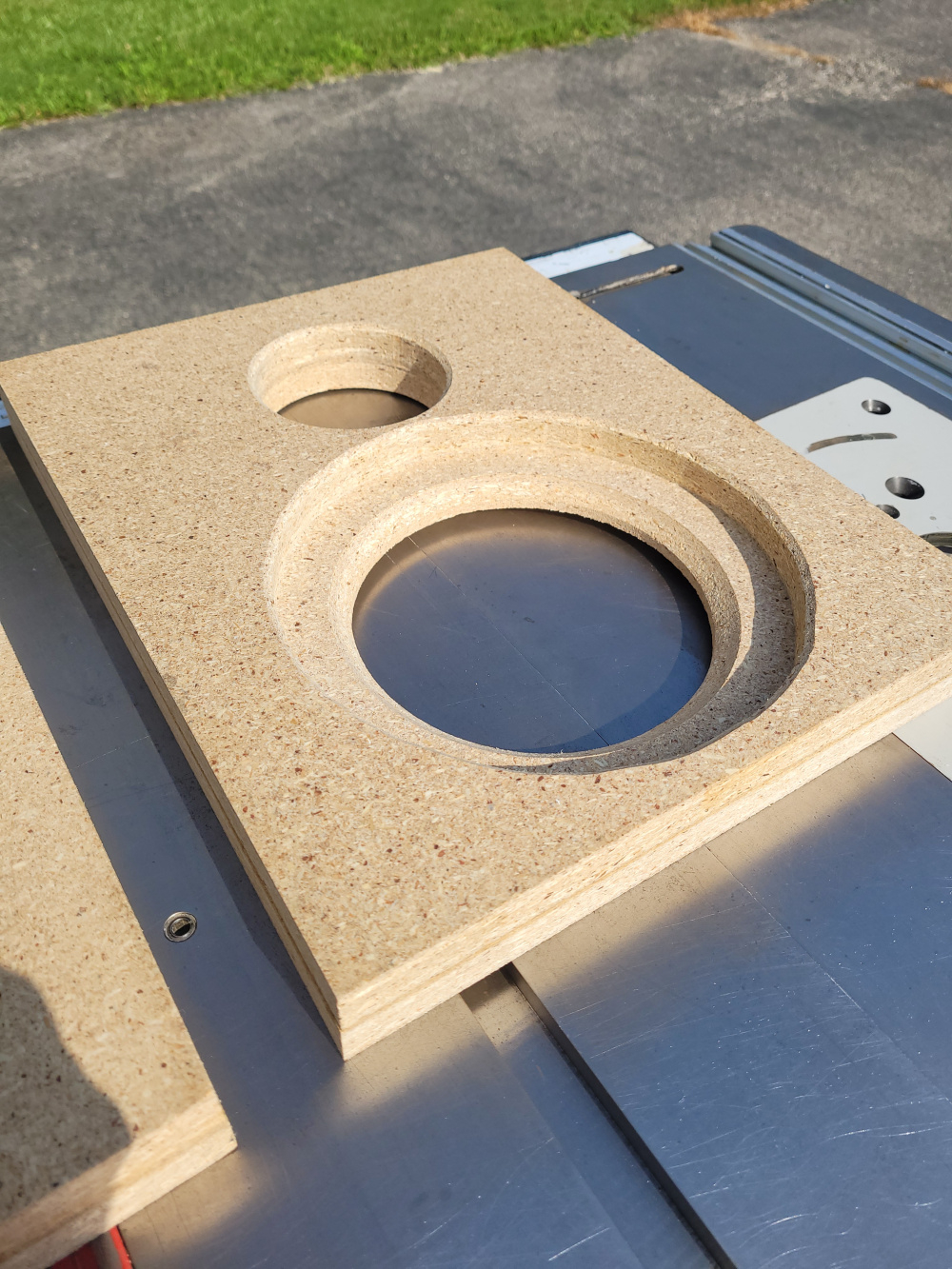

    More baffle pics:

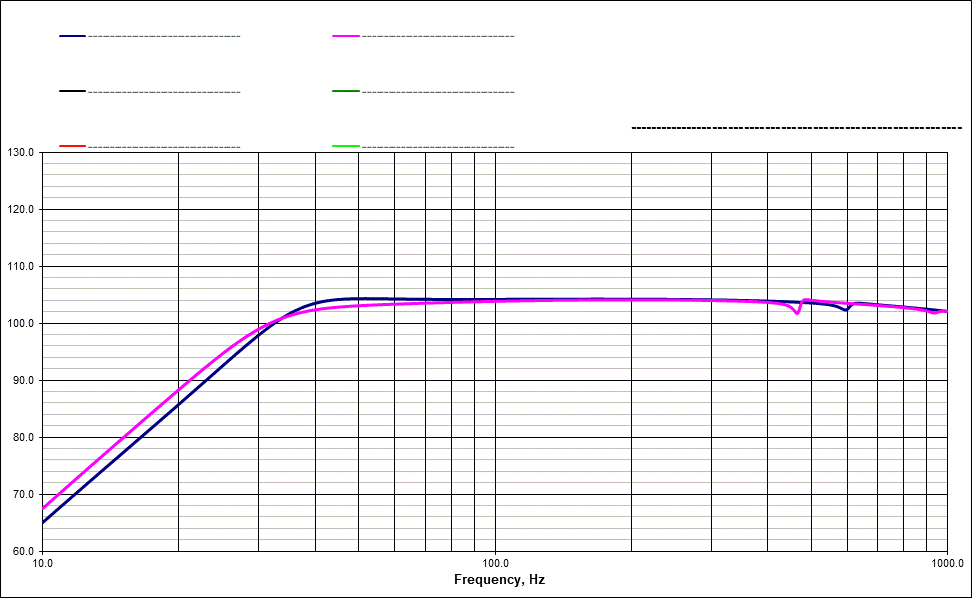

  • Currently the bass bin is 38 liters and tuned to 34 Hz. I'm going to try a lower tuning frequency and see if I like how it sounds. Blue is how it models as is and pink is tuned to 28 Hz.
    tajanesrjj45
  • It'll probably be fine, you have to factor in room gain, so a mild roll off from a lower tuning usually works pretty well in real life.

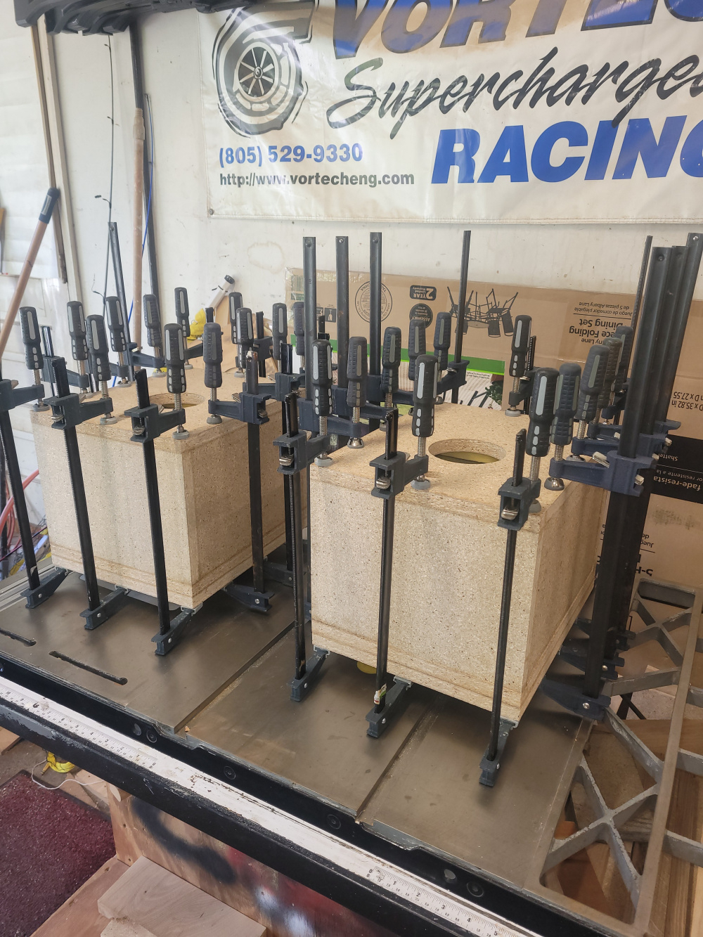

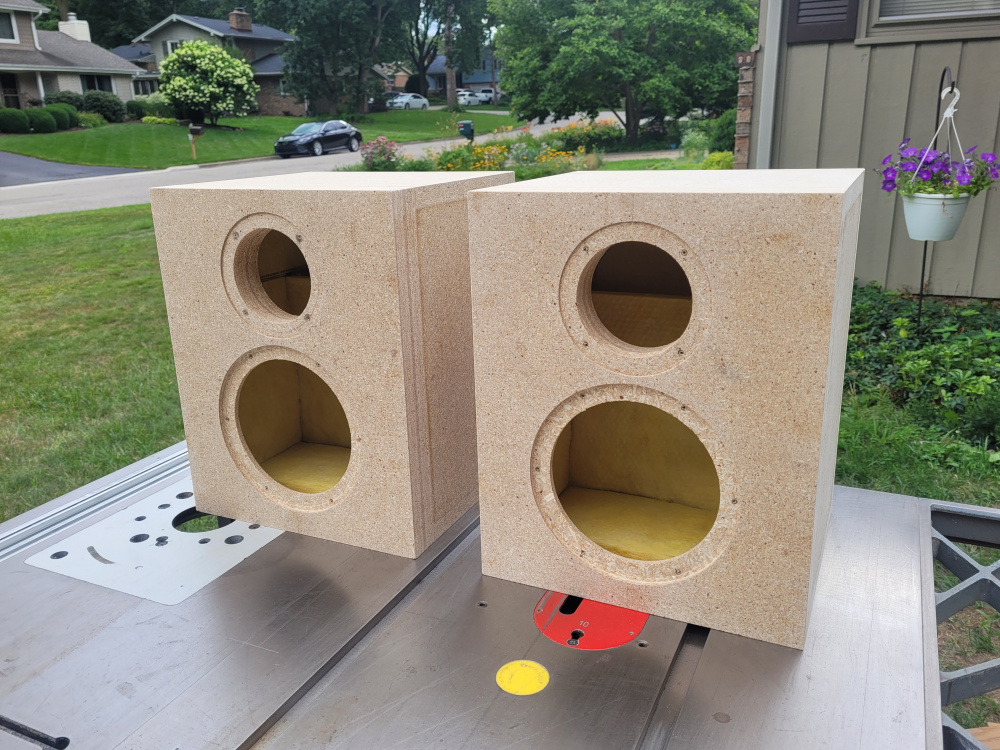

  • Just clamped the baffles on:
    tajanesjohnny5jzsilverDrjj45jr@macTom_SSteve_LeeWolf6thplanet

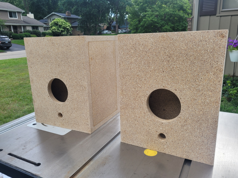

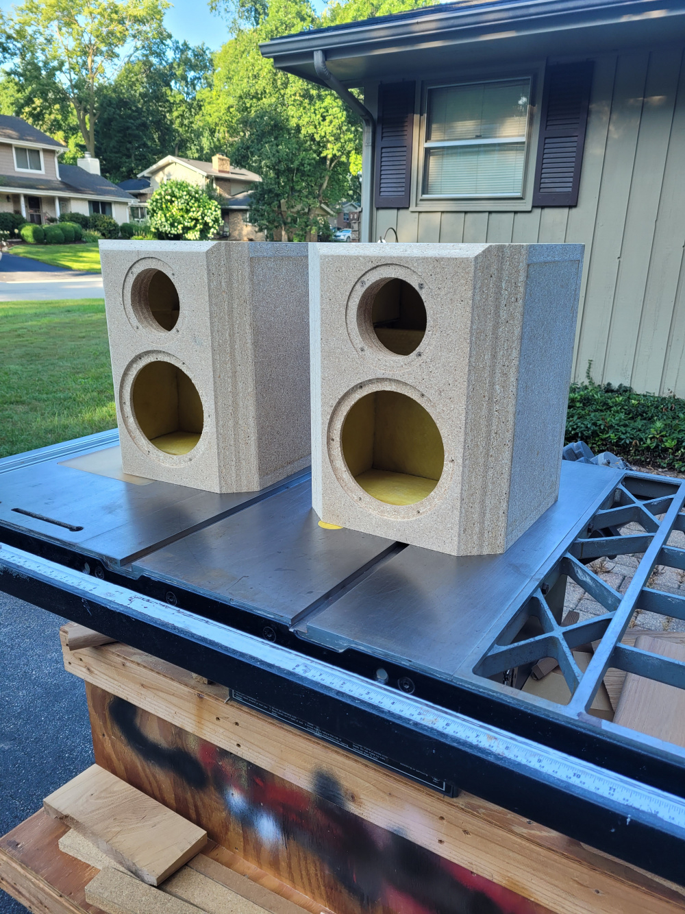

    I was able to flush trim the cabinets after work today. I realize they look really short and squatty right now. I think their proportions will look way better after I machine the 1-1/2" roundovers on the baffles' sides.

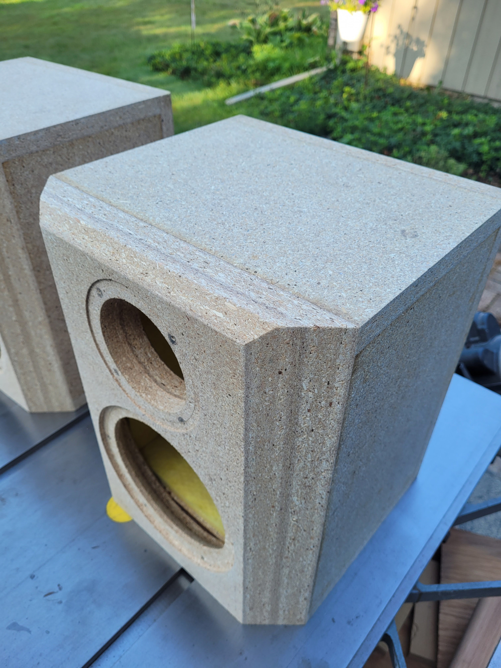

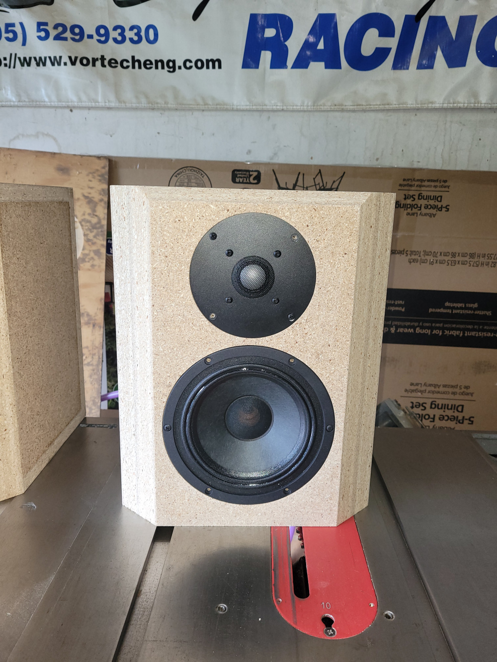

  • I used that monster 1-1/2" roundover bit yeasterday and got the sides edges done. I really expected it to have a more striking look. So this morning I tilted my saw blade and made 37.5 deg chamfers instead.

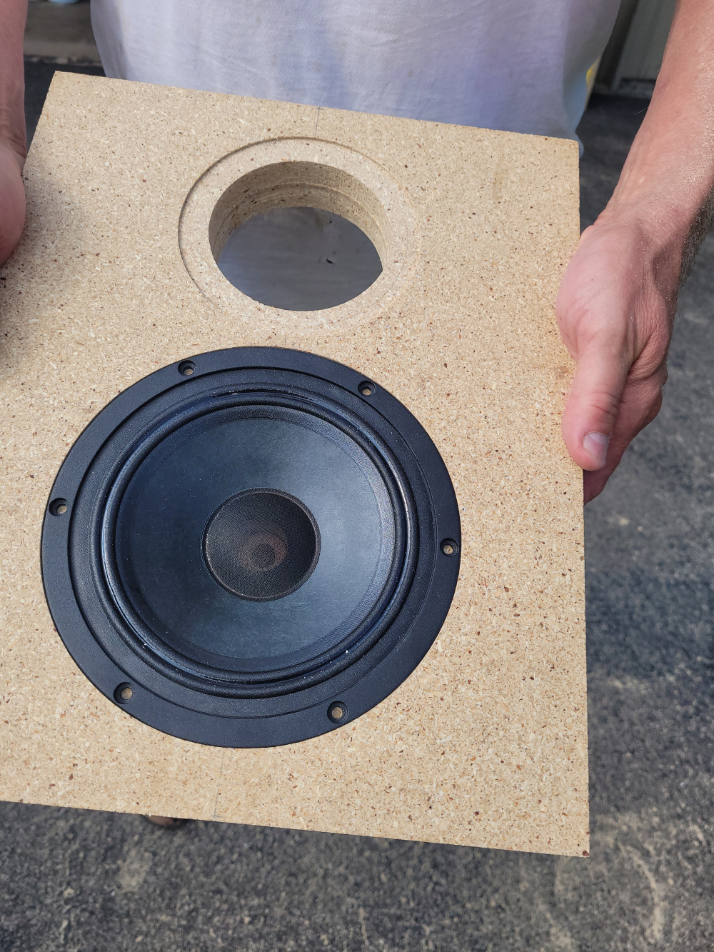

    I'm going to install a tweeter and mid with a couple screws just to see how they are going to look.
