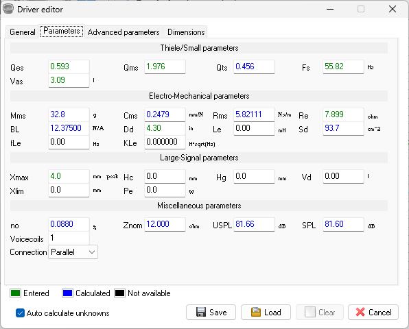

Do some modeling with this 5-1/4" and see what you think!
This is an OEM driver from the Infinity Primus line-up from the early 2000s.
Tom_S
  • In about 5 liters and ported I come up with an F3 about 42 Hz! Are these available somewhere?
