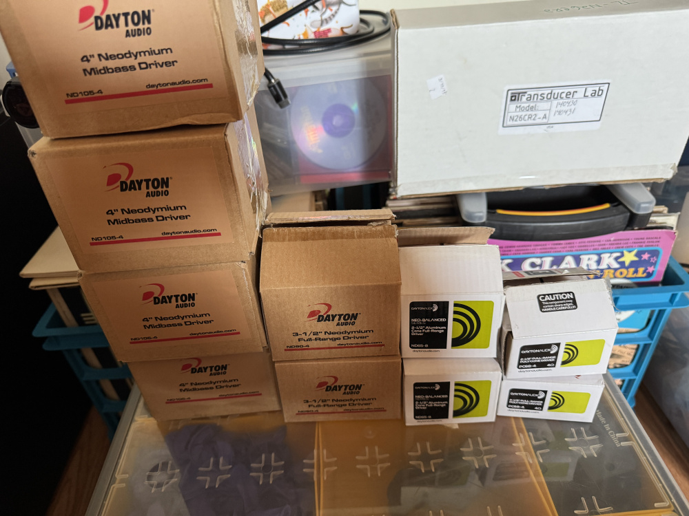

I have a few small drivers on hand. I was wondering if there are any “legendary” designs using them? Any builds at a diy event that stood out with these drivers? Looks like many cheap tweeters on PE are on back order so that’s probably going be annoying. I have a set of tweeters there too but I won’t be using them for this build lol.
4x nd105-4
2x nd-90-4
2x pc83-4
2x ND65-4

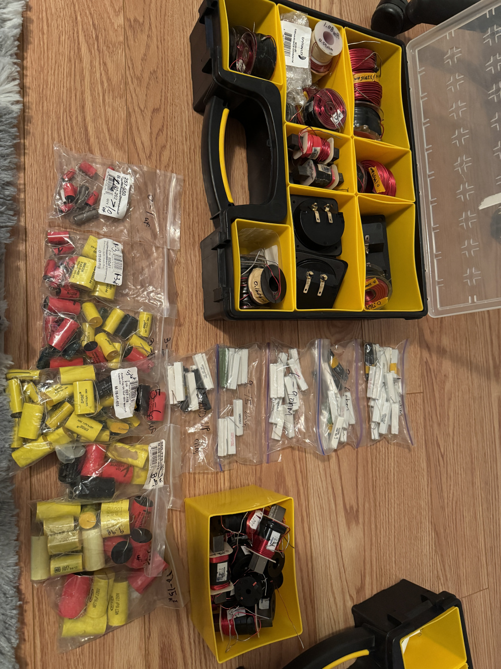

  • I moved semi recently and I found my crossover parts stash. Thanks for jogging my memory Scott. I figured I would have sold these or something. I have a lot of parts for a shit designer! I’ll need to order the tweeters and some stuff from JF but this knocked the majority of the price down.

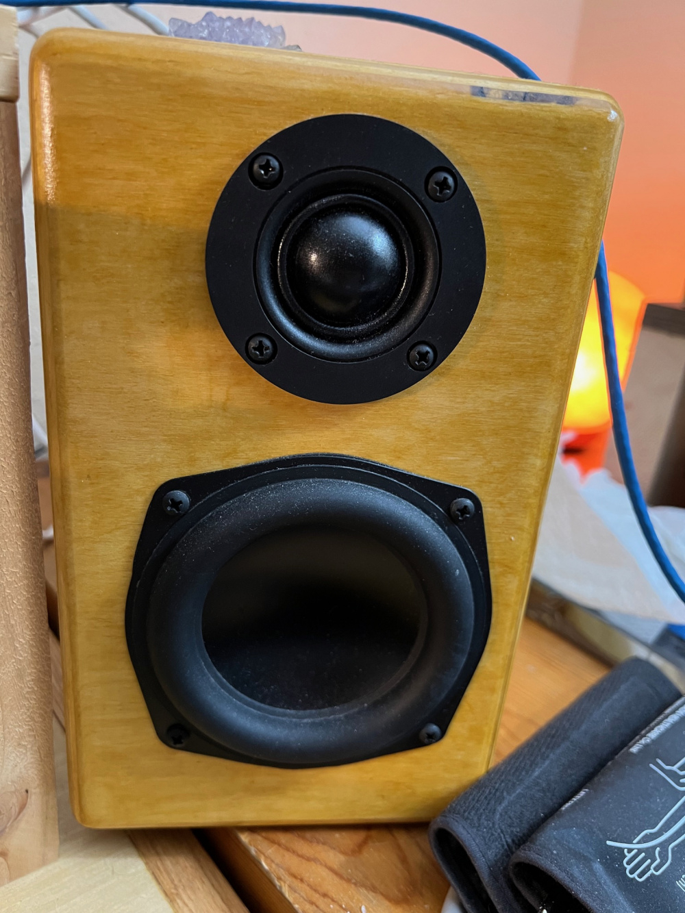

  • I built the lithiums in a Bluetooth radio format (got tweeters from digikey), impressive TM.
