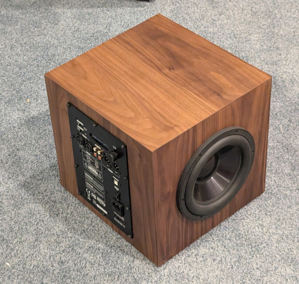

The Build Consists of: 2 x RSS210HO-8's in parallel on a Dayton 250W DSP amp.
The RSS-210HO-8's are mounted on opposite sides of the enclosure.
2x the output and it is vibration cancelling.
This WORKS awesomely, ladies and gentlemen! The sub didn't move on the Telarc 1812 Overture Cannons.
The rig was at -14.5dB on the volume dial. Wendy not home level
This "opposing sides" driver orientation is a highly useful idea and should be seriously considered on a sub build.

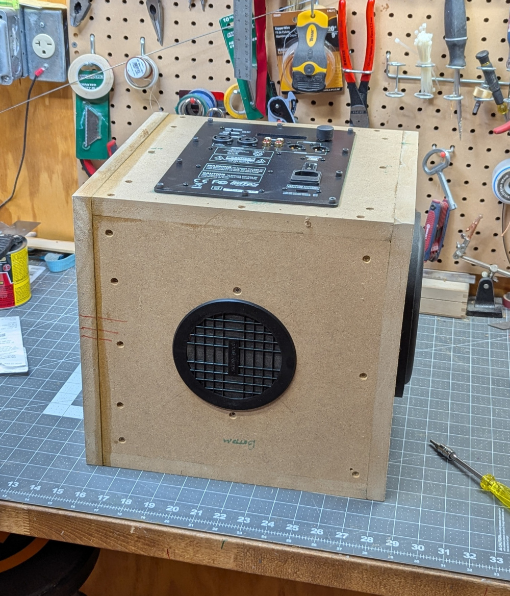

Sealed Box Specs:
0.7 Qcb sealed enclosure with Scan Speak AP Vent on the bottom (epoxied in).
Enclosure volume after bracing is 0.68ft3
Fs/F3: 53Hz
I added the AP vent to let the cones do their thing a little more easily and add a little bias towards music.
If your intention is Home Theater or heavy, heavy bass, you may want to leave it out.
I also tried out Acousta-Blue (not really necessary but I can't help myself on damping enclosures).
You can glue it in with Tite-Bond, nice feature.
Also packed with Acousta-Stuf at the end.
T-Nuts are epoxied in.
Cabinet is heavily braced 3/4" MDF with 1.25" Poplar corner blocks c/o Menards.
Additionally, there are a pair of Oak Dowels bracing the enclosure top - bottom.
The weight with drivers and amp makes them little back-breakers.

How does it sound? Goes deep deep deep! The 1812 cannons had lots and lots of boom/crunch.
With 2, there will be significant room pressurization.
I used TrueRTA with a calibrated UMIK-1 mic (nice toy) to level up the room.
NAD C.399 XO at 50Hz (18dB/Octave, a little unusual in onboard electronic XO's).
Sub volume to flat and 15 degrees of phase shift - I LOVE this, wish I had it back in the day. Makes dips and peaks go away.
A 3dB touch of parametric at 30Hz to bring the bottom up flat. Nice amp.
Haven't tried the DSP yet other than manual adjustments.
The ZRT's can utterly scream with the bass under 50Hz away and 180WPC from the NAD.
I think I actually got some power compression on the 1812.

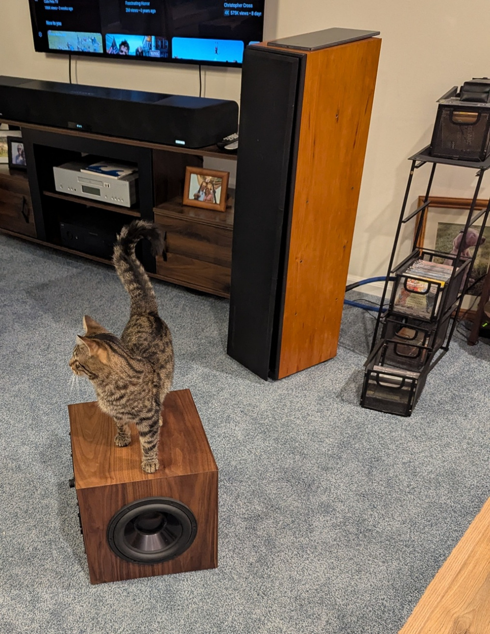

Below are pics including Feline Disrespect. As usual.
