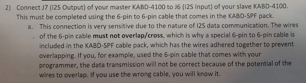

  • OK, I have a basic idea of what you're doing now, one board (the master) to drive both L&R for the two MTMs and one board (the slave) to drive just the sub. I assume you have the cable for the I2S lines between the 2 boards installed and you're getting at least some output from the sub. Right?
