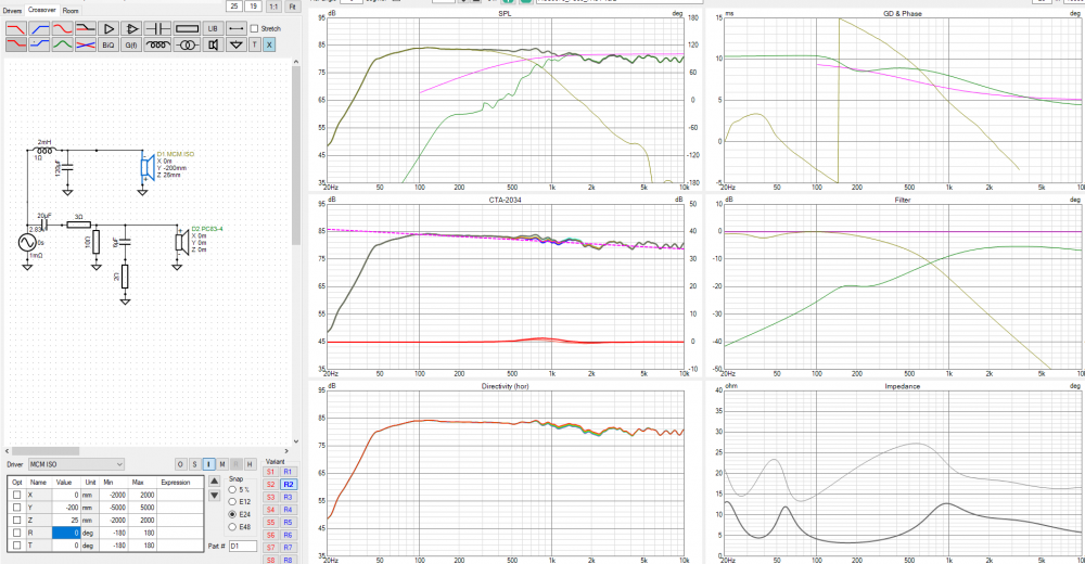

May run isobaric on the woofer to pull the ~40 Hz F3 out of 18 liters and closer to 4 ohm load:
I'll probably start with the single woofer version and see how I like the sound.
May move to the ISO version if all sounds good.
Any advice or thoughts other than build it and see?

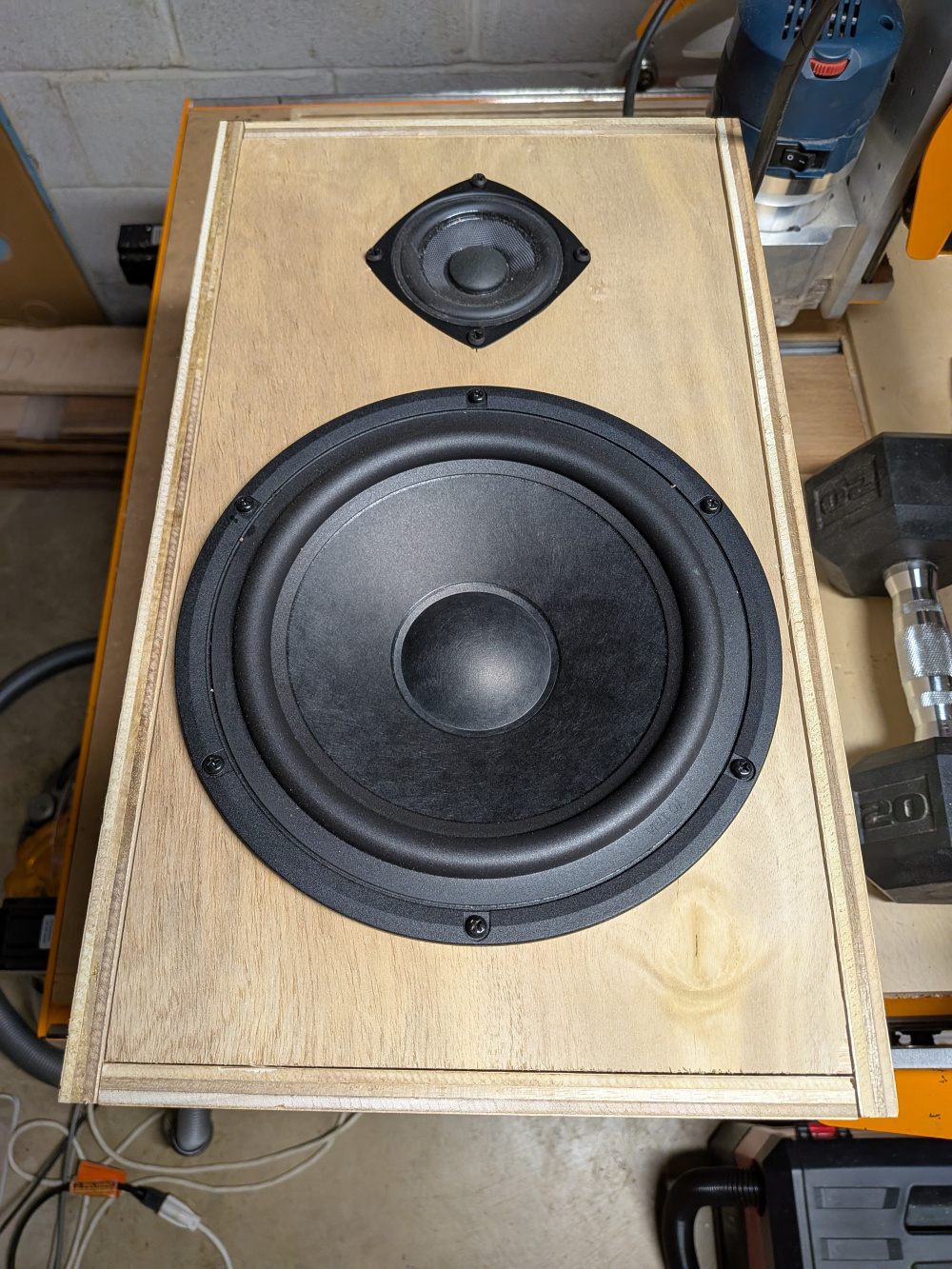

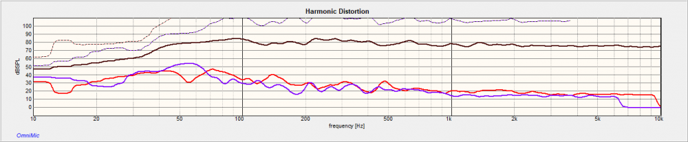

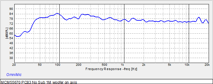

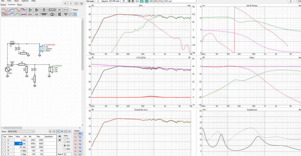

Some progress. No iso yet.
