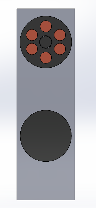

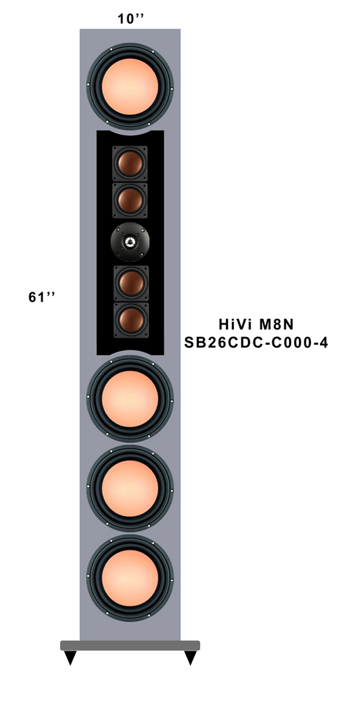

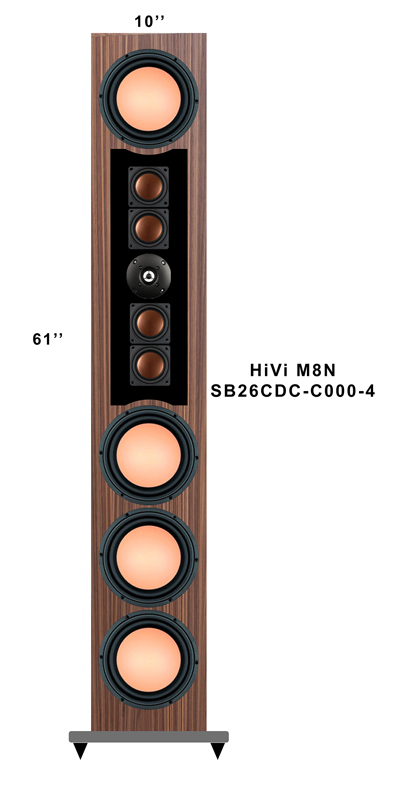

I have 8 HiVi B3S drivers laying around that I want to find a use for. I have a couple of ideas, but am open to try some other ideas. I am looking at both conventional ideas and maybe something a little crazier. Below are 2 ideas I had been playing around with.
The first is a Tekton style array. I would have to buy 4 more, but they are on clearance at Madisound currently. This array would have a small format SB Accoustics tweeter in the middle with an 8” below.

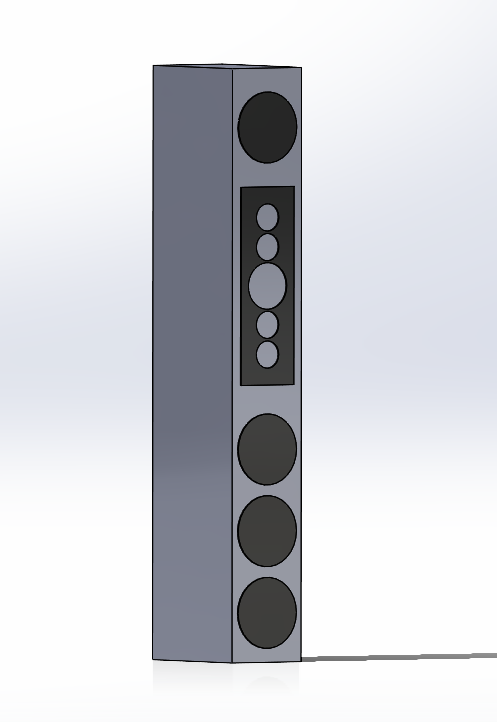

The second is a more conventional approach. Again, I was thinking a small format SB Accoustics tweeter in the middle with an 8” below, but in a mmtmmw. I have it drawn as a wmmtmmwww and had thought about using some MAC06 drivers.
I vote for option two. Would be a striking look with excellent performance.
I like the funky tekton style one. But experimenting with cheap stuff is kinda my jam.

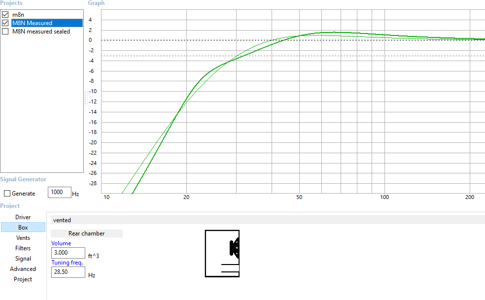

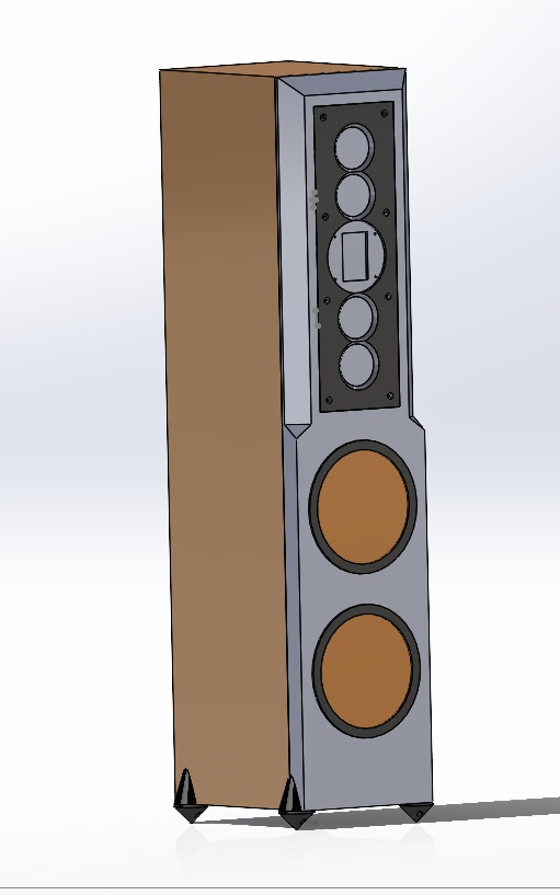

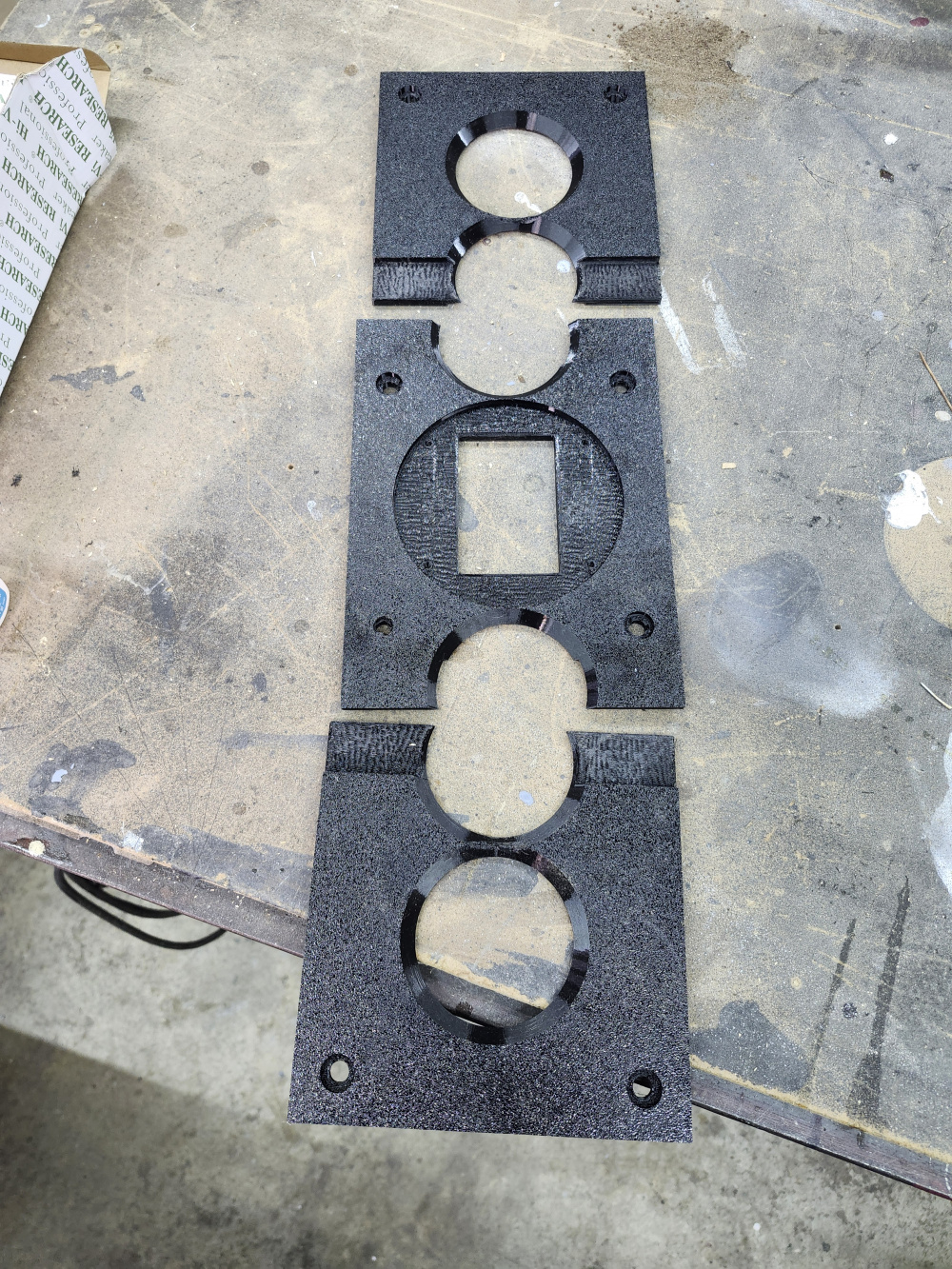

I modeled up 4 of the M8N, and the box gets a bit to big, and even with 8 of the B3S, I don't think they could keep up. I also modeled up those MCM drivers that are on sale at Newark, and they just don't go low enough for my taste. I then modeled up 2 of the M8N in 3 cubic feet, tuned to 27hz, gives an f3 of 30hz with a fairly shallow roll off. I also have really wanted to try that SB ceramic tweeter. I may look at doing the speaker that Gowa modeled, but with only 2 of the M8N. I am going to 3d print the black portion around the mid and tweeters so that I can rear mount the B3S. I will start playing around with that first.

So far I am leaning to 2 M8Ns. Now I just need to make sure which tweeter i want. Another option is the HiVi RT1.3WE if I wanted to keep it all Hivi.

If you haven't used the Seas Titan 27TAC/GB yet, I'd add that to your list of possibilities. SB CDC is really nice too. I just don't think these have enough sensitivity to keep up in this particular case. A planar or ribbon is likely your best bet for output.
Possibly place two on the back, slightly offset to the outside and run without a LP filter (i.e. mid on up)?

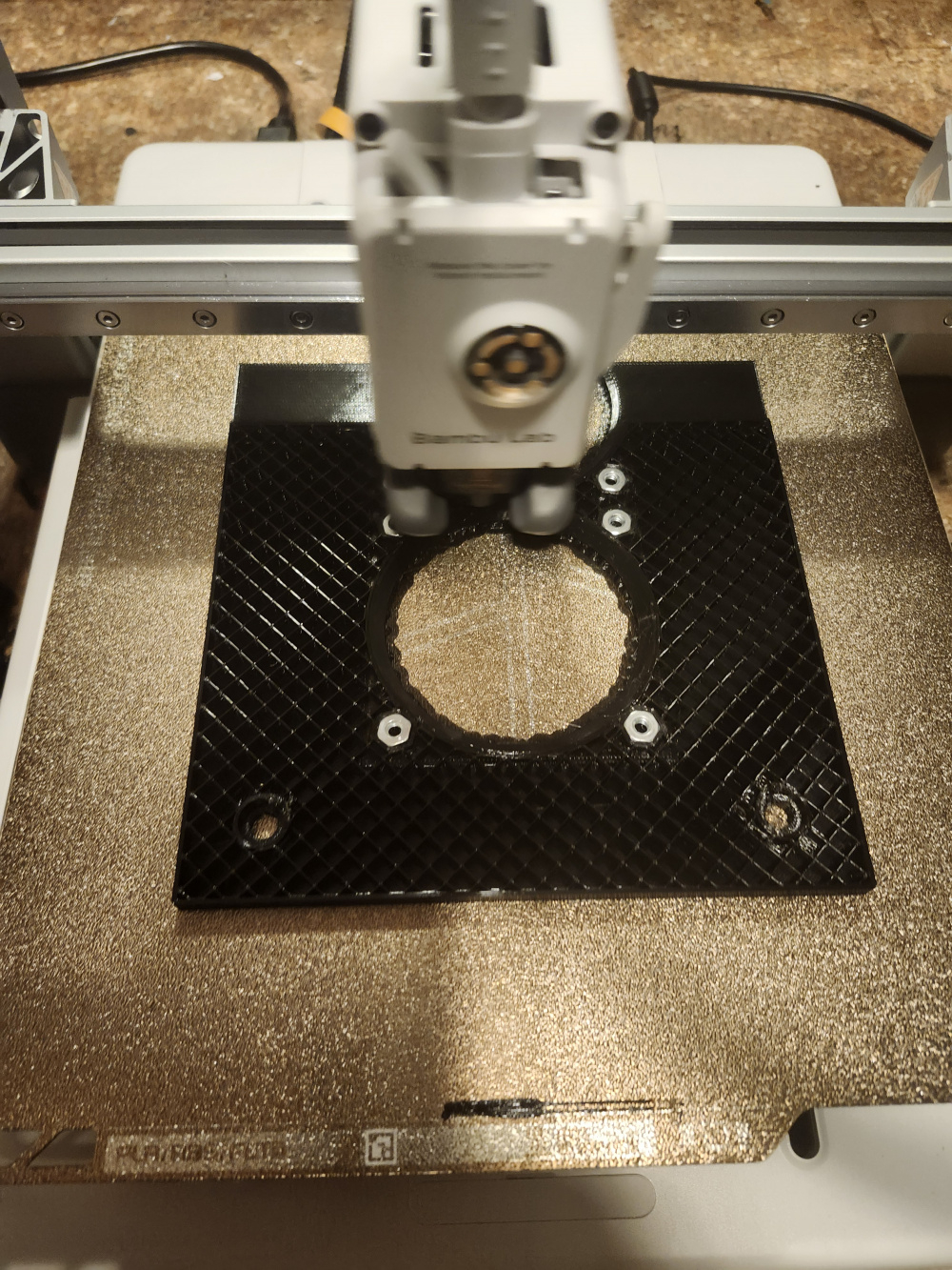

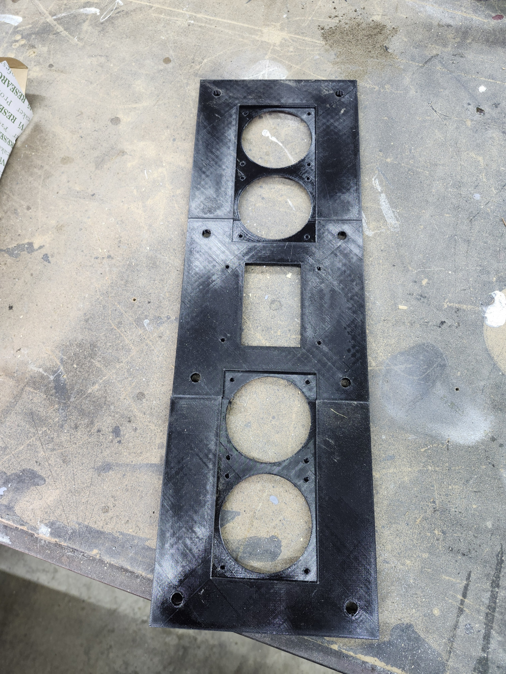

I printed out a plate to rear mount the B3S drivers. I just need to save up for the 4 M8N and Hivi RT1.3we tweeters.

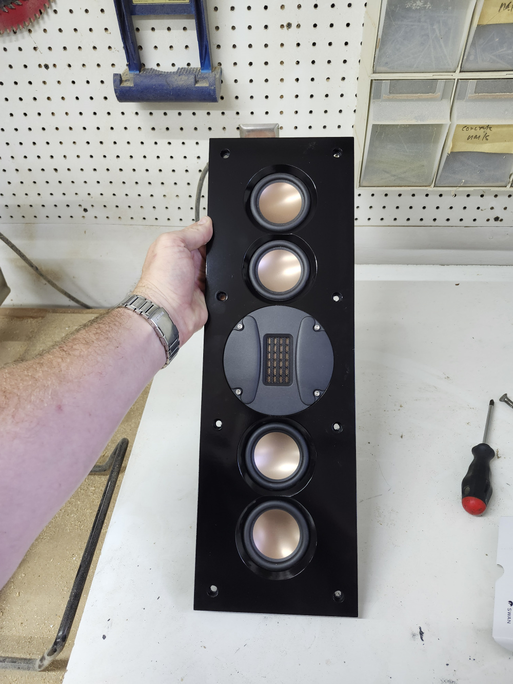

I got my 3d printed parts painted and assembled. Now I just need to order the M8Ns. I ended up embedding nuts into the print to secure the B3S drivers.
That looks amazing!
Are you going to fill the inverweave with silicone, or something?
The picture of the print is when I paused it ho install the nuts. It is smothe on both sides.
That looks amazing!

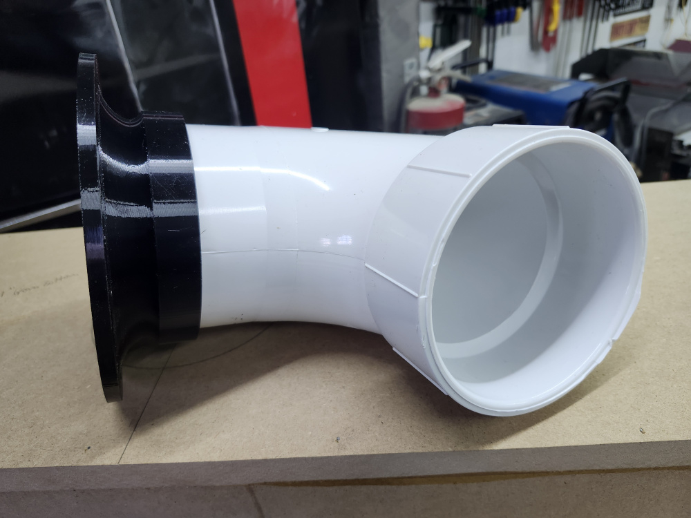

That is really sweet looking. How did you glue the 3 seams together? Also, how are you liking your Bambu labs A1? Any complaints?
I used a 2 part gorilla glue epoxy meant for plastic. I then used a filler material, sanded and painted. So far the bambu A1 has been amazing..I use the carbon X1 and H2D at work, and this prints every bit as good.
