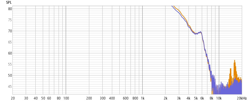

Something I run across rather frequently is peaking at the very top end of a midrange (12khz+). Usually it's down low enough I don't concern myself with it too much. But this time it was something I was borderline concerned about. This is using a M4N as the mid but this problem isn't exclusive to this design/driver.
For reference the tweeter level is about 88db in this frequency range for this measurement, so this high frequency peaking is around -30db down. However I can knock it down to about -40db with a LCR across the mid. I guess my questions are two fold:
1) Would you bother treating it when it's -30db?
2) Is there a better way to address this than with the LCR? I haven't been able to defeat it with otherwise with just component value adjustments so far.
The LCR is only like $5 in parts that I have on hand, but I was trying to keep parts count to a minimum as this is just a little two way I'm doing for my wife. But my questions are both in relation to this design and more generally as well.

  • Listen is always good advice. If you wanted to know more about that breakup mode and how much attention it needs by measurements alone you should measure distortion and waterfall. If that is ringing like a bell or is a huge distortion spike the notch might be a really good investment.

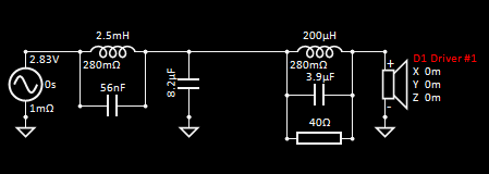

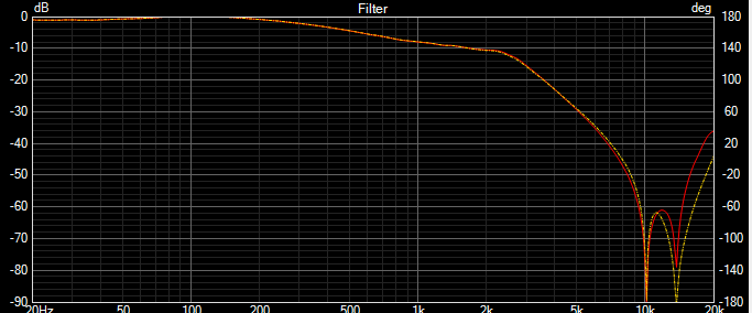

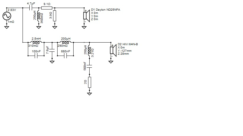

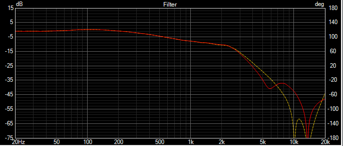

  • The primary breakup of the M4N is really at 6kHz, I'd address that above anything else. Use a parallel notch rather than series, as the last components before the driver, it will perform and sound better, trust me. You filter response as-is is -60dB at 10kHz, there's not much point in doing much more there. The LCR addition in your circuit isn't doing a whole lot, the upper frequencies are already notched by the two LC combos you have there.
    Filter response with and without the LCR:
    I'd go with something like this:
    Comparison of filter response, yellow dashed is your filter above.
    kenrhodesSteve_LeeEggguyR-Carpenterrjj45Impious4thtry
