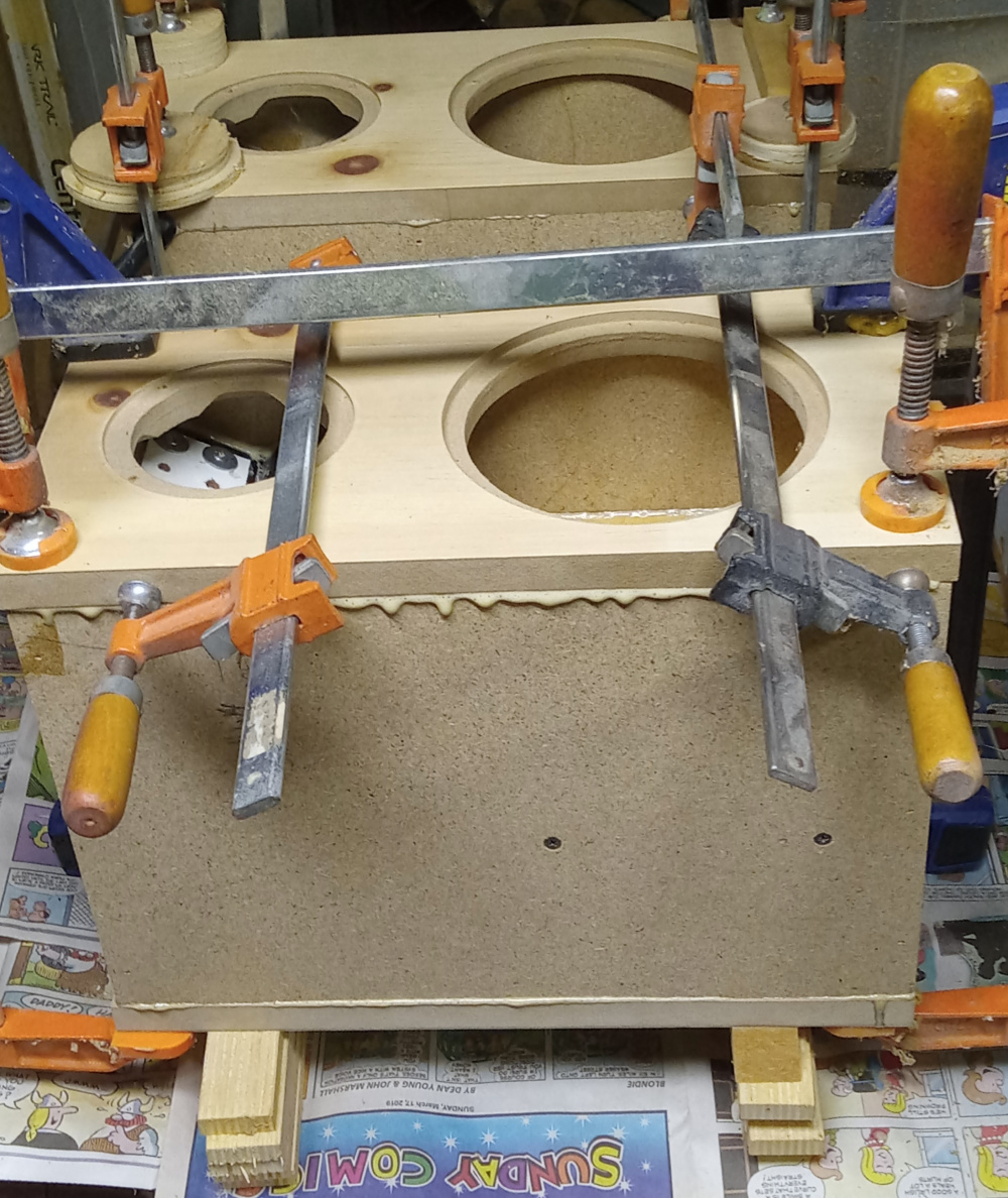

"Toxicity", my InDIYana 2025 entry...

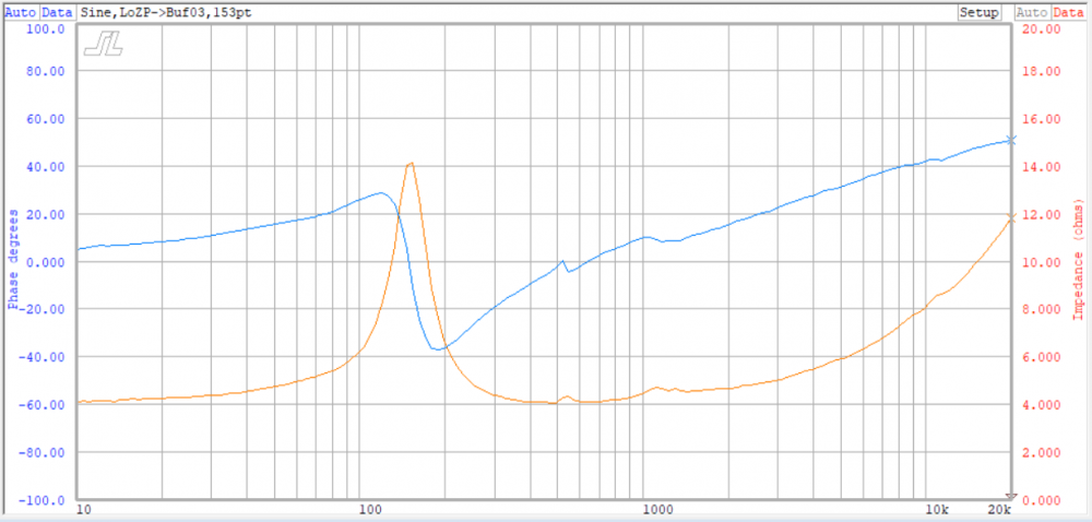

  • The other one measured...
    6thplanet4thtry

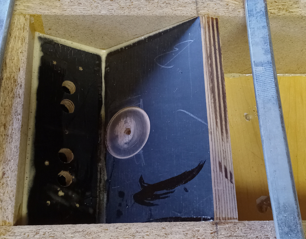

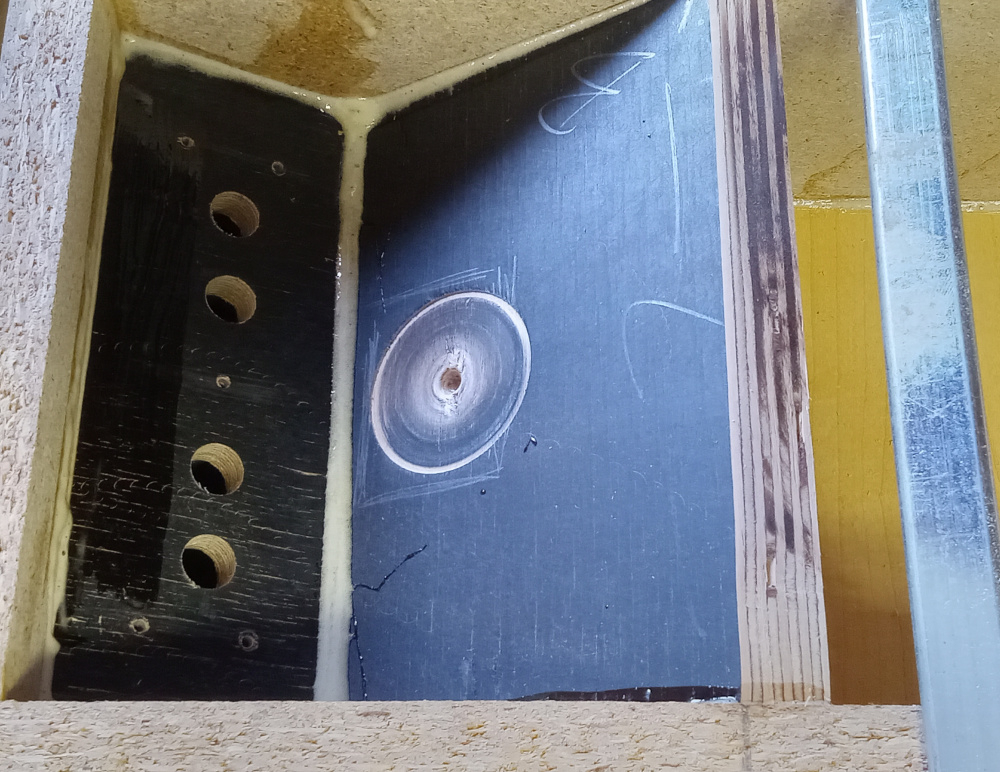

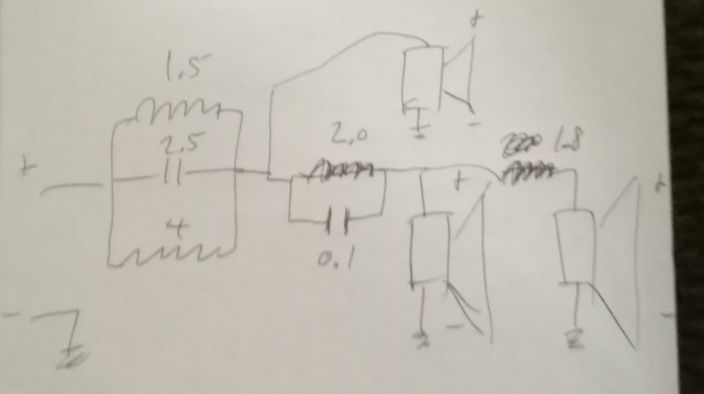

  • Just buttoned them up as simmed, no listening yet. Need a couple feet for coil clearance, but otherwise playable. Definitely riding the 2 ohm net train, and wired as a 1.5.5-way. Ended up with 6 parts, believe it or not, and the freq response and phase was fairly easy to manage.
    See you all in about 8 hours...
