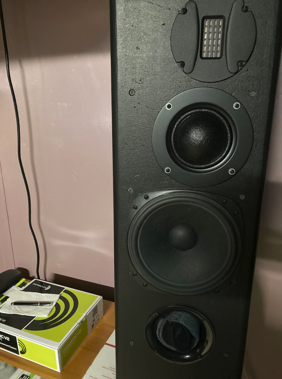

    See that sock stuffed in there? . . .
    Speaker is up against the front wall:

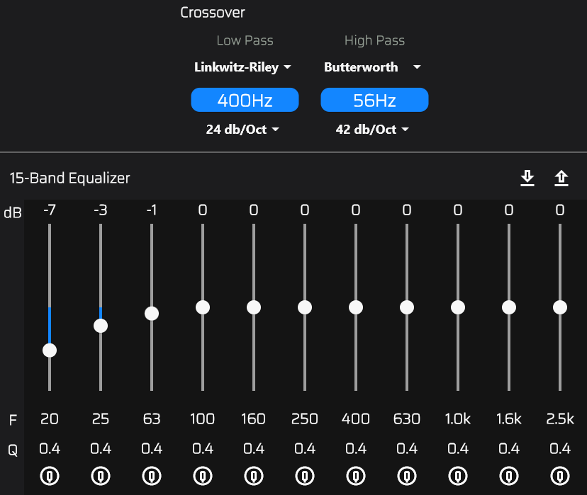

  • Acoustas DSP Amp settings for sealed bass concerning the above response [hope it is germane]:

    For me I've been leaning towards preferring sealed over ported for its smoother and controlled rolloff, could be my room and/or my less than perfect ported woofer builds (and many I've listened to) have that 1 note cliff sense. I did find the partial sock port method with my single Eclipse worked wonders (high tech tuning method- ha).

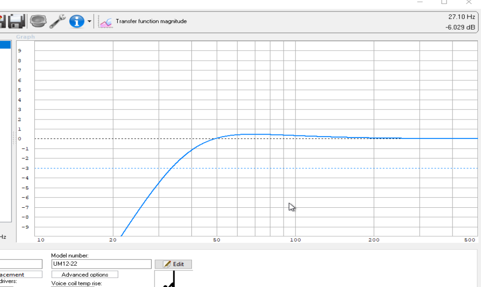

    Bought a pair of the PE UM12-22 woofers, and they modeled very nicely in a 1.5ft^3 sealed box - F3 at 33Hz, F6 at 27Hz , even without the capacitor boost. Modeled with 300W power, never got close to exceeding Xmax. I may still build those.....
    Having built many ported designs, I am leaning towards sealed these days. It may have something to due with ported woofers unloading below Fb, or it may be interaction with room boost.
