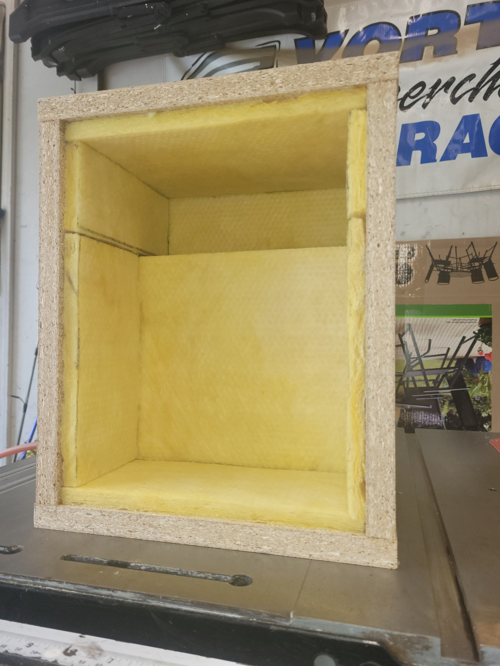

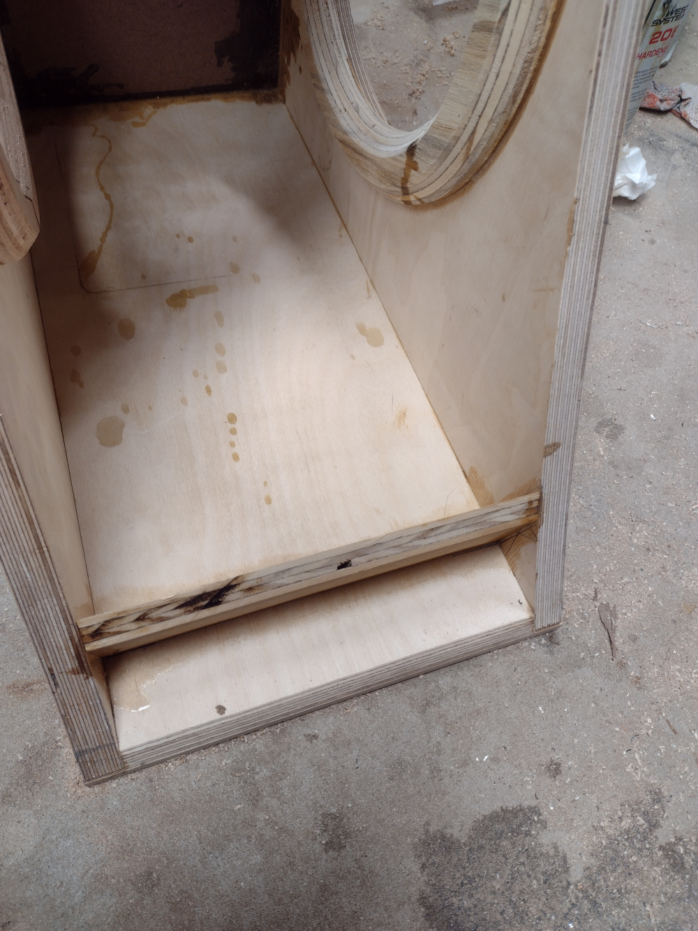

  • I mocked these up in order to get the volume of the subwoofer section. I just use packing peanuts and boxes to fill it then put the contents into a box which is a much simpler calculation to figure.

    Very creative way to measure net volume of a non-std box !
    Curious, how did you go about cutting the curved indent track for the back (darker board) ?
    ugly_woofer
    I just used an auxiliary fence on a router with a 1/4" but an followed the front edge.
    Steve_Leetajanes

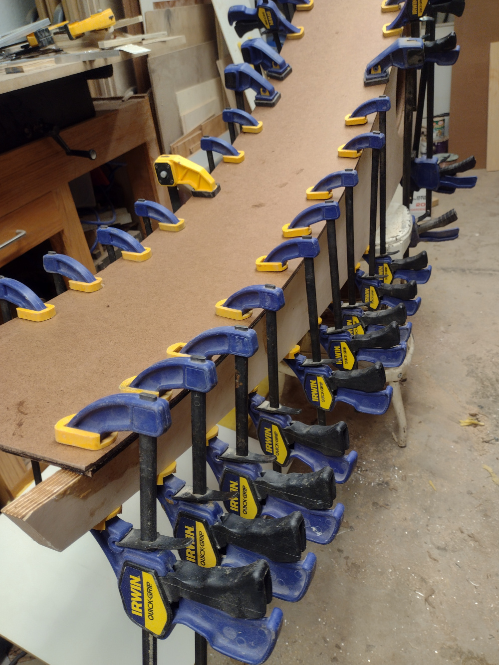

  • I just glued in a second layer with lots of epoxy and a fancy clamping system.
    hifisidetajanesjr@macPWRRYDrjj45Steve_Lee6thplanet
  • You should patent that - the Gravity Assisted Clamp.
    Bonus points for the big-ass transformer!!
    ugly_woofer6thplanetEd_Perkins4thtryrjj45
