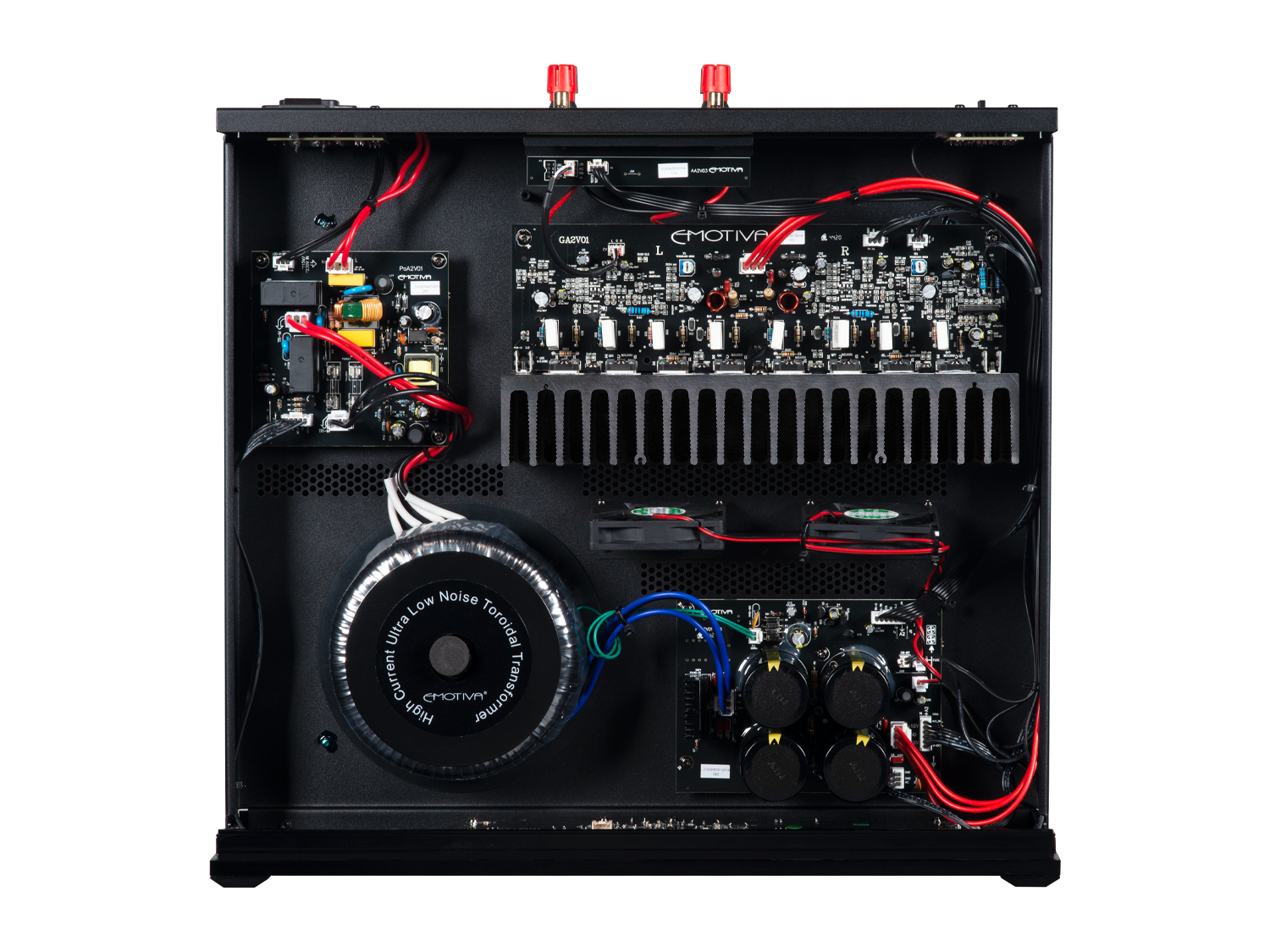

I found a pic of the amp internals on their site. That looks like a small switch mode supply just for the turn-on circuitry.
