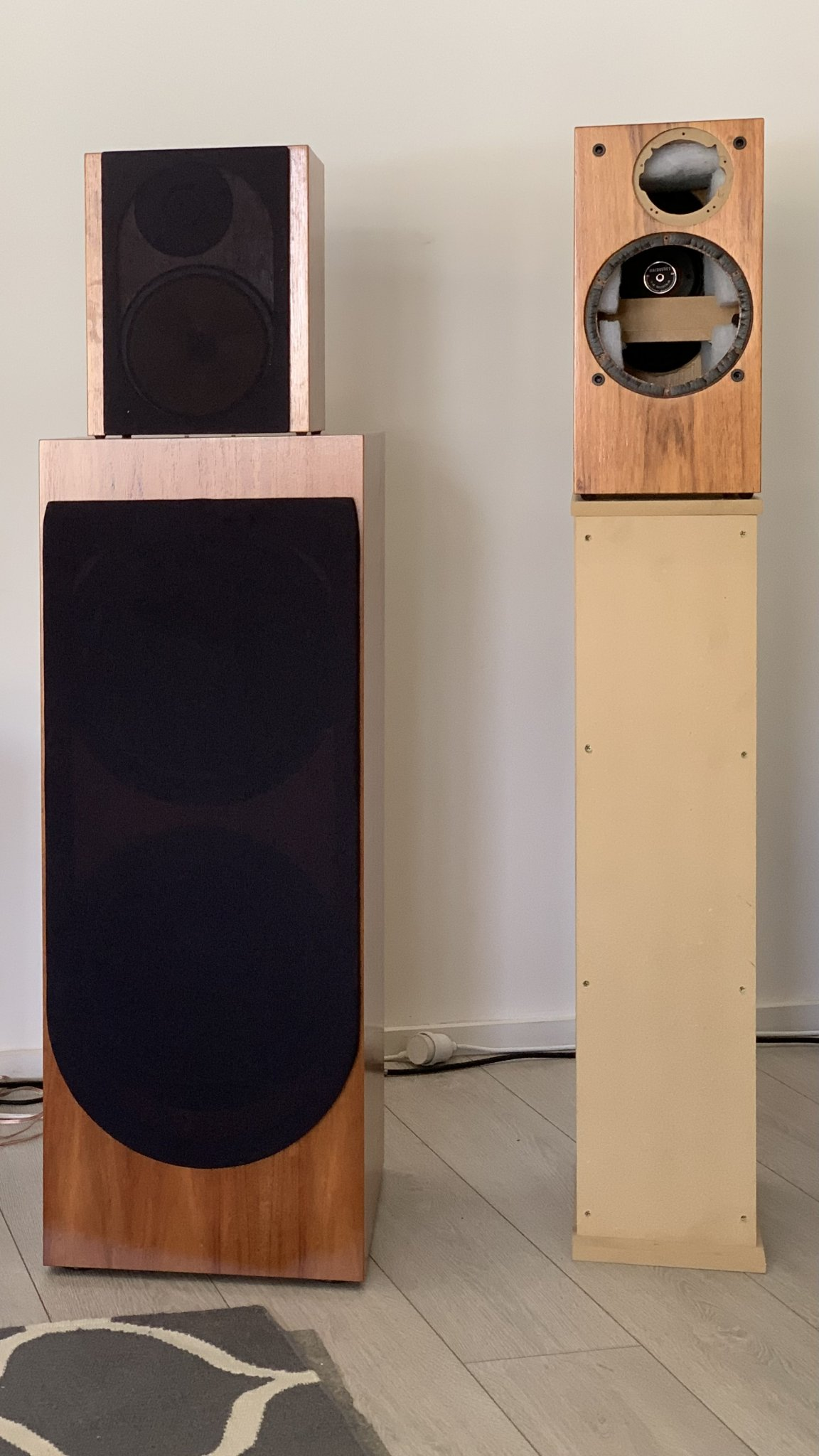

  • This is the look I am going for.
    Steve_Lee6thplanetTurn2
  • I like how you are thinking...
    Steve_Leejohnny5jz6thplanet
  • I like that!! And can probably do something like that.
