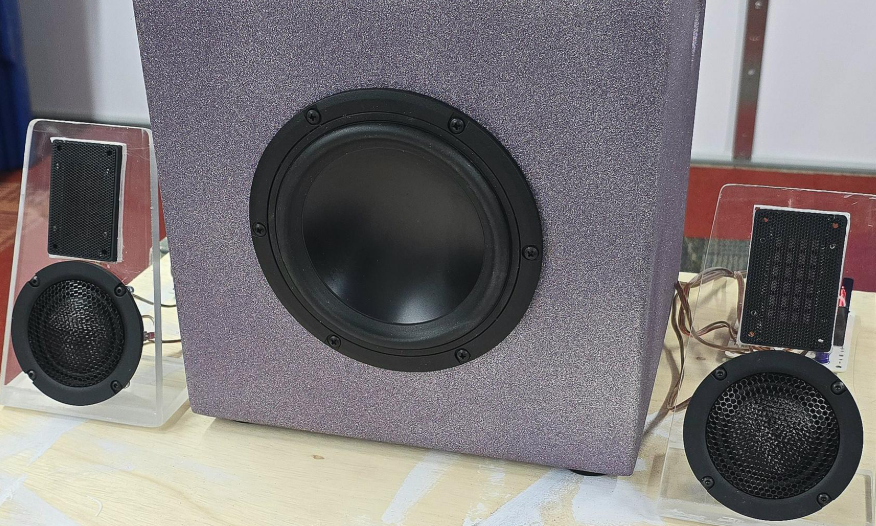

  • After some testing in open air of a bunch of driver combinations tonight I settled upon the Wavecor WF168WA05 midwoofer (NLA), the Dayton PC83-8 and the Beston RT003C Ribbon tweeter for the compact 3-way build to replace the NS10M's in the drum recording station.
    They all have great response/extension and tone used together (not very scientific but just my critical ears after a lot of mixing sessions with a known good reference monitoring system (SSA-VSX).
    More as it progresses . . .

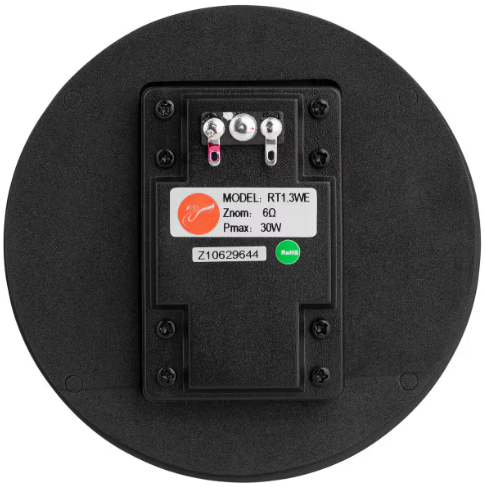

    It appears that the faceplate on the HiVi RT1.3WE can in fact be removed if I am seeing this correctly -->
    https://www.parts-express.com/HiVi-RT1.3WE-Isodynamic-Tweeter-297-421?quantity=11
    Look at the screw holes on the back/pics . . .
    Edited to correct product link
  • I have removed the faceplate on the HiVi RT1.3WE
     John H, btw forum has decided I don't get emails
  • Makes it dimensionally smaller and shouldn't make much difference in FR/Dispersion if used nearfield I suspect . . .
