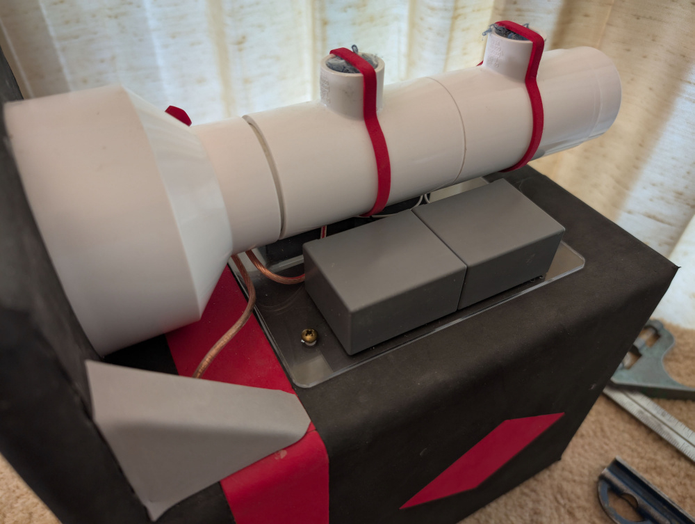

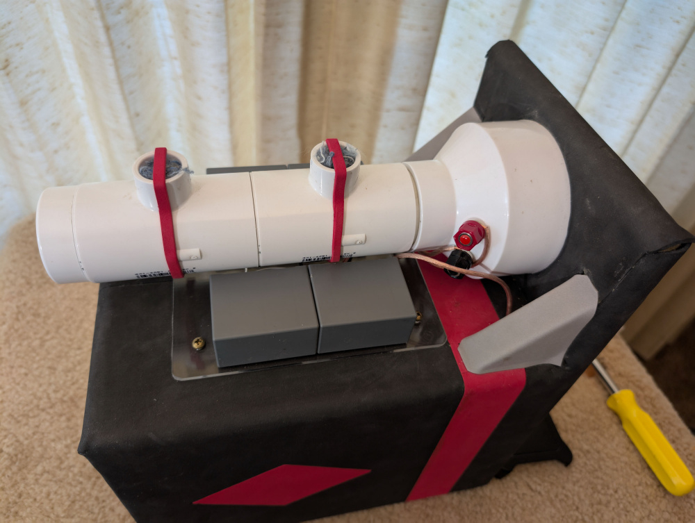

I made some covers to hide the pipes inside. Speakers should be rule compliant now. I think. The covers will be friction "press fit" into position using foam rubber inserts. Plan is to rattle can spray the covers flat black when the weather gets better. Still too cold and humid in my garage for painting right now (30 to 40F).
If you look closely, you will notice that the covers hang off the back edge by about 1 inch. This is an intentional and is intended to prevent internal pressure build up that could "de-tune" the two small "variovents" located on top of the internal coupling pipes. So, it is now a triple vented system of sorts.

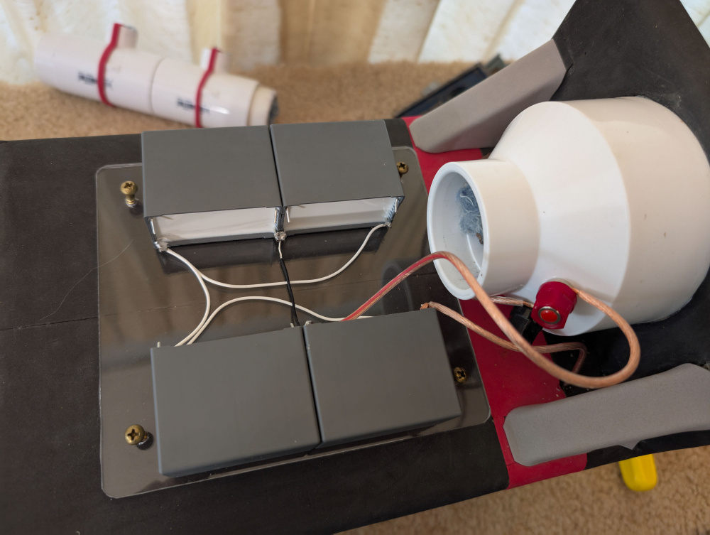

In prep for next month's Speaker Design Competition (SDC), I modified my xover to roll off the deep bass going to my PS95-8 wideband drivers. I glued four 55uF PP caps (paralleled up for a total of 220uF) onto a piece of plexiglass. Then I bolted the plexiglass to the top of the cabinets with 4 brass screws and wired the caps in series with the driver plus terminals. This should help to improve midrange and treble clarity somewhat on tracks with lots of energy in the 20 to 50Hz range.
I don't know if this mod technically makes them a 2 way, as opposed to a 1.5 way. Maybe they can be called a 1.75 way, since the lower xover frequency spans a wide band from about 100Hz up to about 500Hz or so.
If you applied a high pass filter to the fullrange driver (the caps in series) then it is a 2 way regardless of how big the overlap is.
