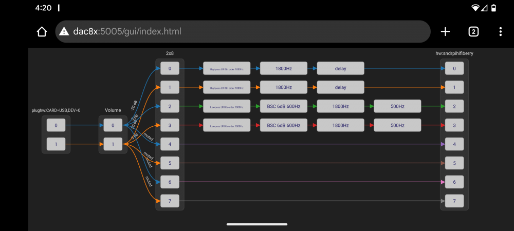

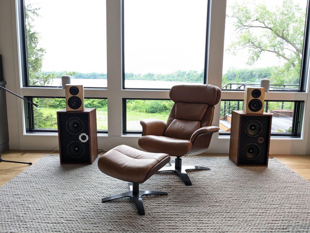

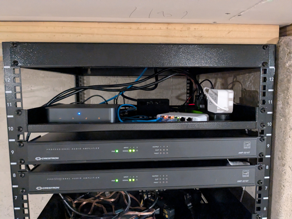

    I swapped in a Scarlett 6i6 (thanks again Charlie) in place of the Hifime S2 Digi (optical -> USB) as I was getting pops and clicks on the right channel when there was no signal. Working great now at 192kHz.

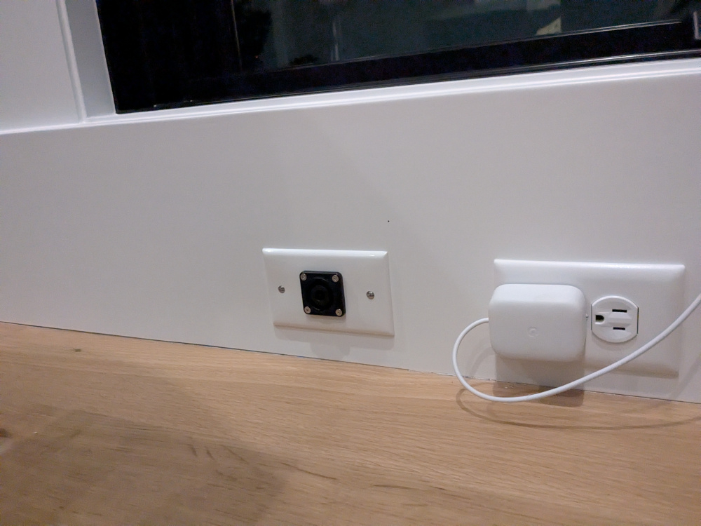

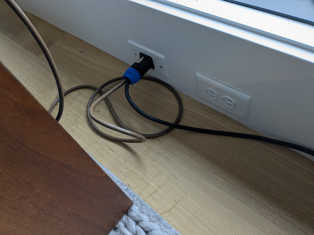

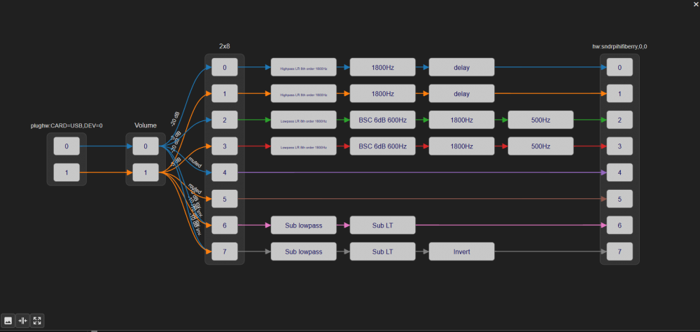

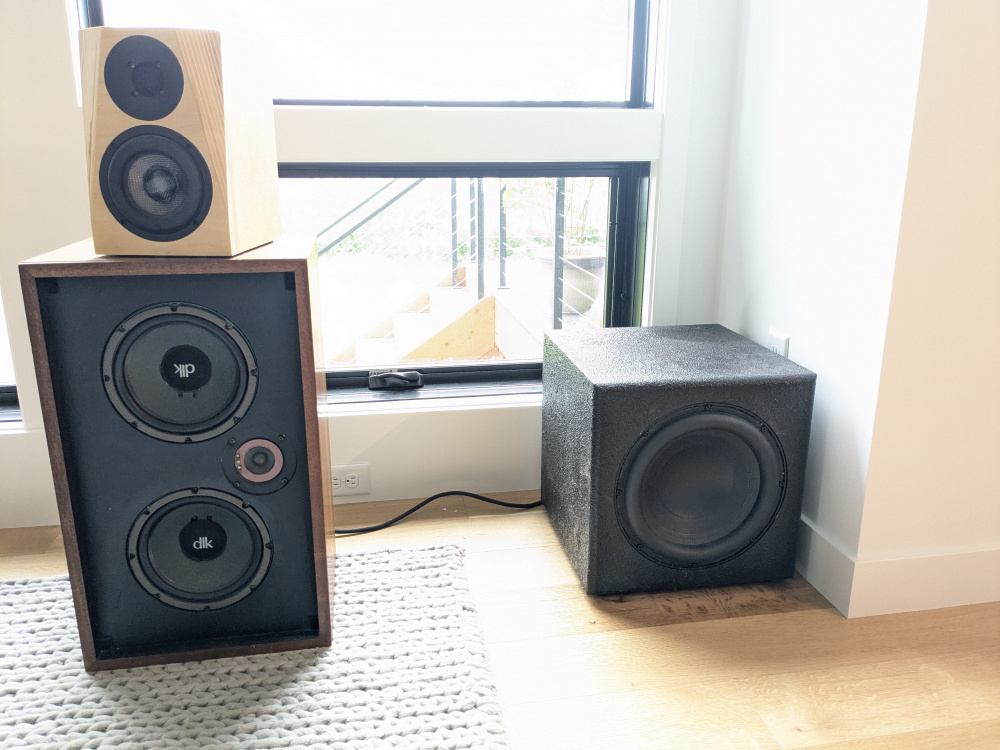

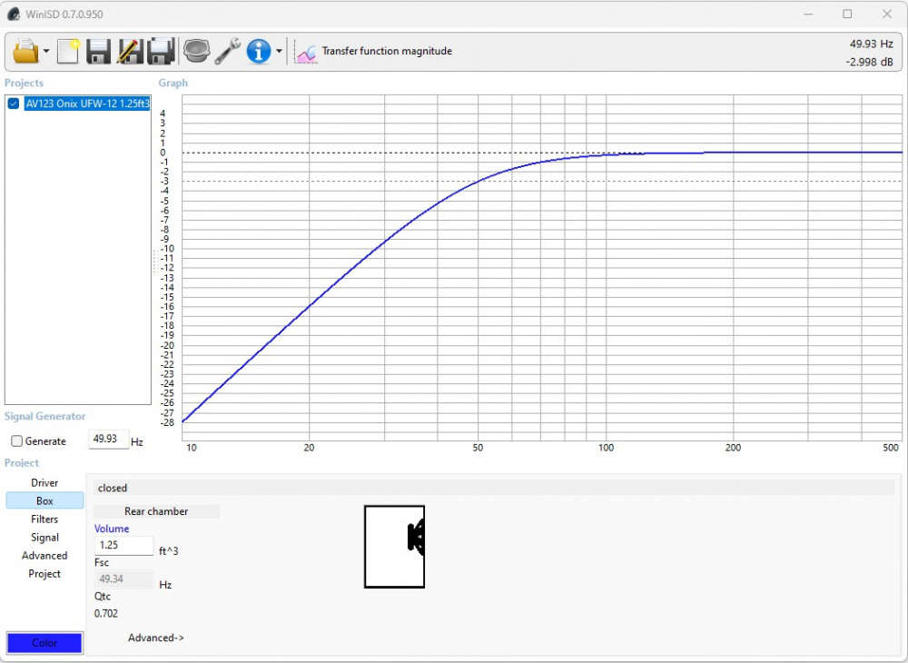

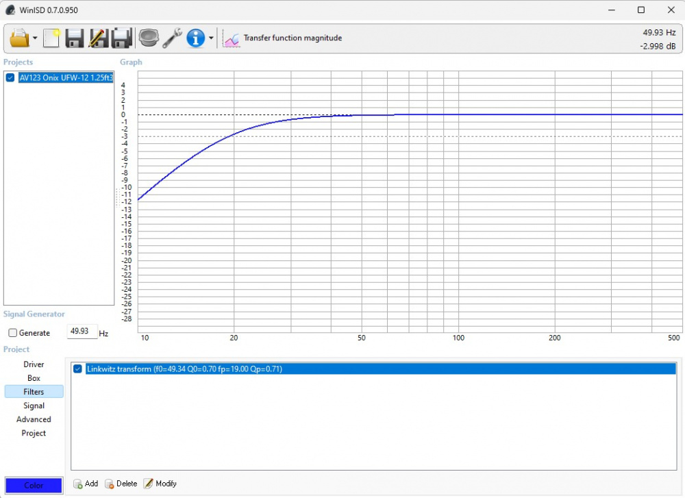

  • Added a 12" AV123 Onix UFW-12 in a 1.25ft^3 sealed cab. It's powered from an ICEpower 700asc and utilizes the 4th pair of connections in the right speaker speakON. I sum the the left and right channels and apply a low pass filter and Linkwitz transform. I send this to the last pair of outputs in the Dac8x in CamillaDSP and I then invert one of them to create a balanced input for the 700asc. A bit of soldering later I have the needed 3.5mm trs to xlr needed.

  • Exquisite roll-off on that sub.
    tajanes
    And the view out the window ain’t bad 👍
