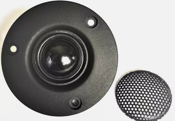

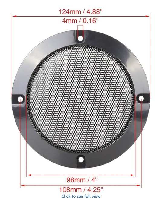

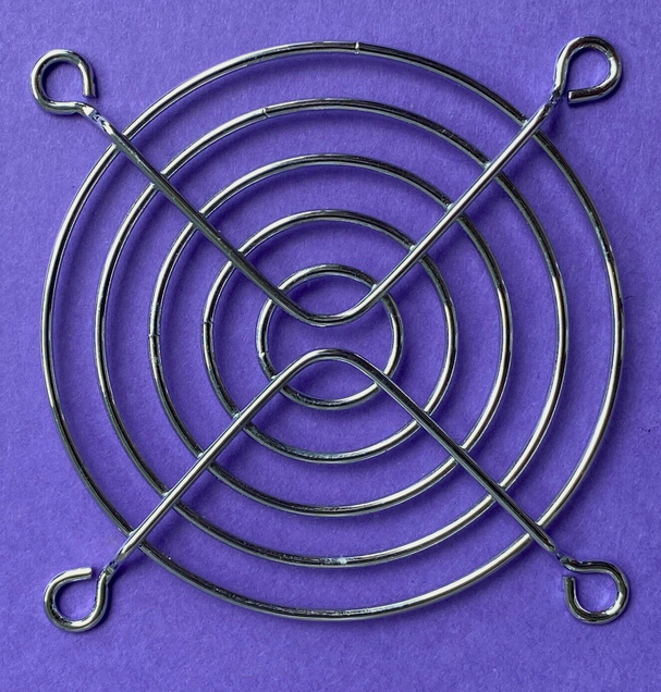

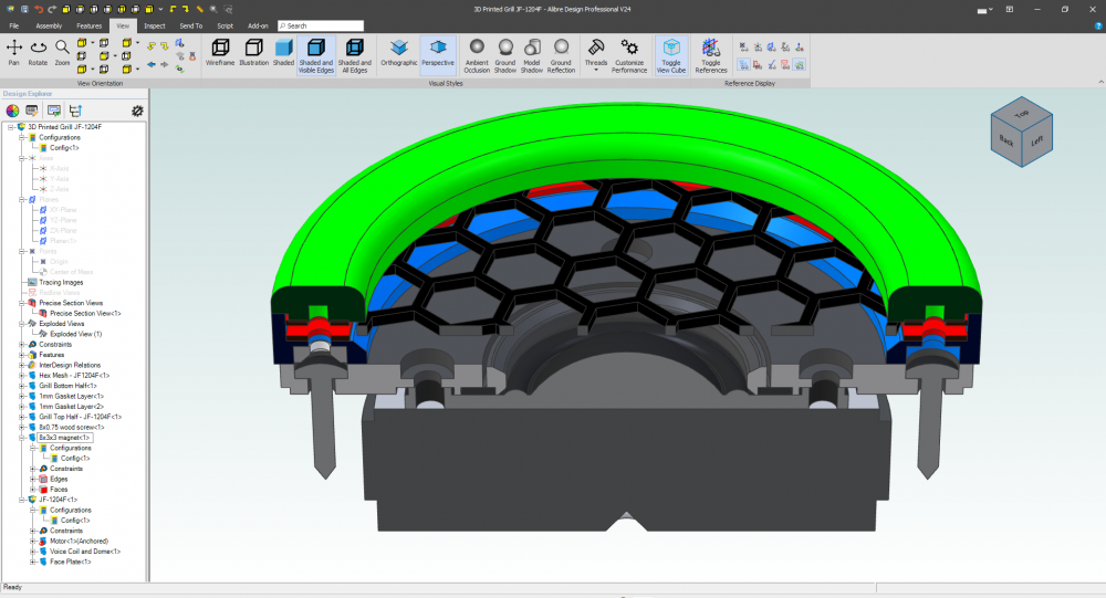

    Hello Gents! I'm batting around an idea for a large portable stereo boombox using the JF1204-F tweeter and MAC 06 woofer. Is there any slick way of adding a grill to the tweeter to protect the dome? I've been doing some googling and measuring the set of tweeters I have, and I'm not 100% sure what direction I would go. I see small grills that are supposed to fit over the dome, but I dont know if that would actually work. On the other hand there's always a 4" woofer grill that's a bit oversized, but should work. What does the crew here think? @hifiside and @jr@mac
  • Sorry I missed this tag. I think the 4" grill might be your best bet. Alternatively you might be able to fab one up with a 3D printer or find some steel mesh at a hardware store?
  • There are some Visaton grills that should be closer in diameter than a 4" woofer grill.
  • Thanks @jr@mac and @Wolf - This engin-nerd has been busy mocking up a 3D print version over the last few days. Two piece grill design that uses countersunk magnets to stick to the mounting screws of the tweeter. Screw portion of the magnet assembly pulls the top and bottom halves of the grill together and sandwiches some grill mesh I have leftover from my PA speaker build a few years back. I want to print this from PETG, which I haven't used before. Gotta tune up the 3D printer for that!
    Steve_LeeRon_Ejr@macrjj45Tom_Stajanes6thplanet
  • PETG prints well, if your printer is doing PLA it can do PETG.

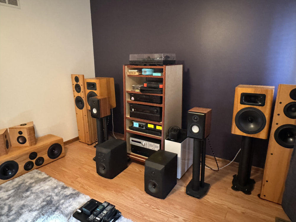

  • Dudes, these Chachos fucking rock. Well done Craig and MAC/JF.

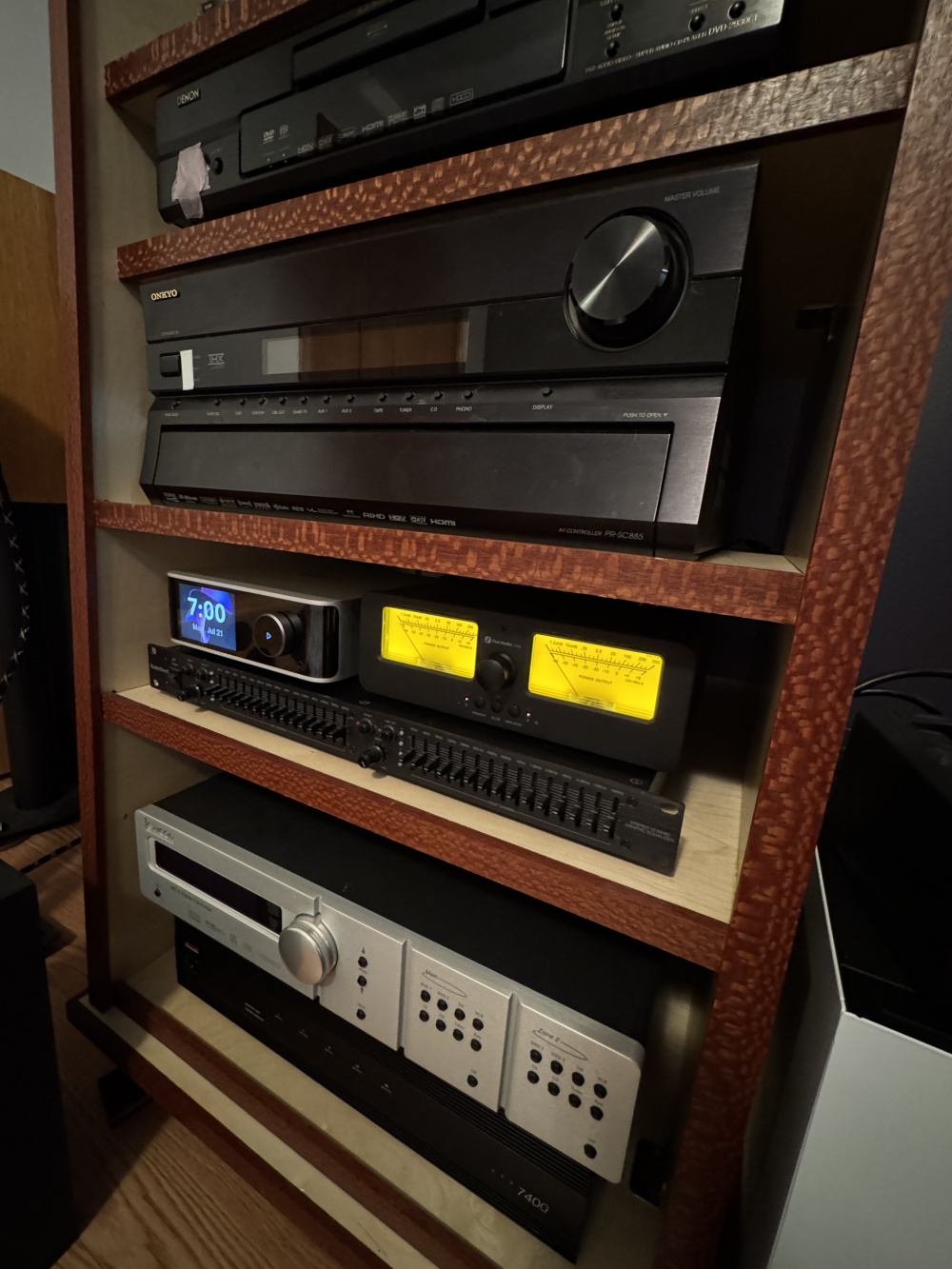

    So curious, what component is that on your shelf with (appears to be) yellow meters?
  • Looks loke a Fosi LC30
    tajanes

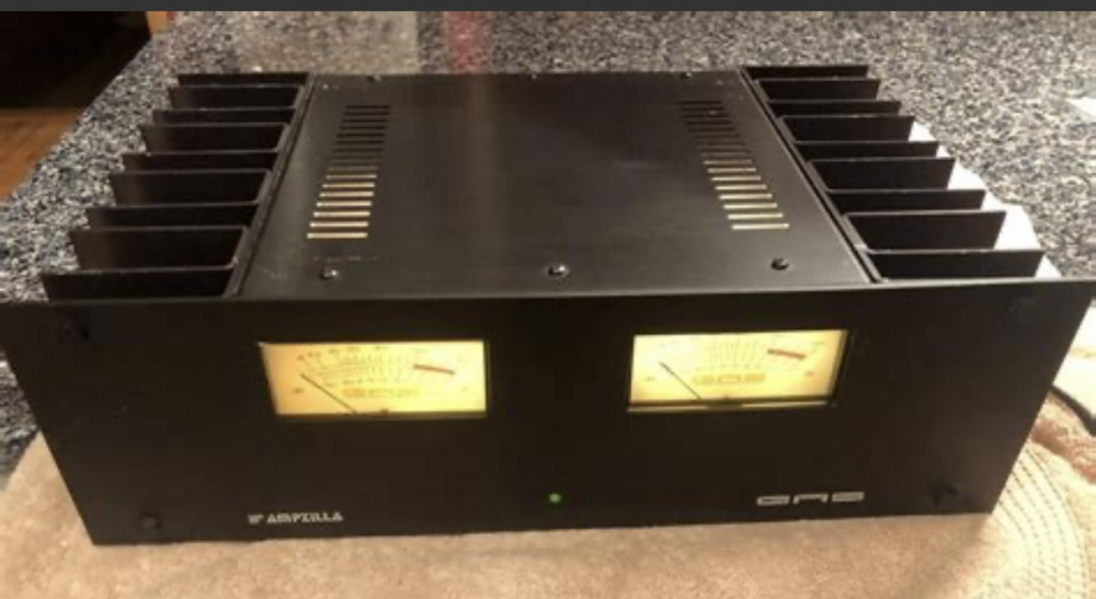

    I’m an old-time fan of GAS son of ampzilla
    D1PP1Nrjj45traw
  • edited July 22

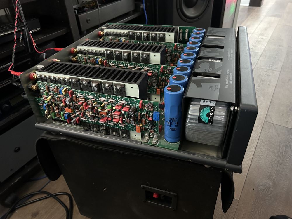

    Yes, Fosi LC30, speaker selector/amp selector. Never mind the tape it’s to block the annoyingly bright leds on the components. I have an adcom 7400 (5-channel amp and an outlaw audio 5000 (5 channels as well). So I can use the “amp selector” to use one of the preamps on the other 2 channels of the adcom. The Onkyo is multichannel preamp (PR-SC885) and so is the lexicon. The onkyo has a good phonostage that the lexicon doesn’t. I think they both sound great but I’ve been using the Wiim ultra as my preamp. There an old radioshackEQ there as well I was using when I was trying to do some designs.
