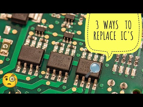

  • Thanks for all the hot air tips. This certainly seems to be the very best way to do this. I'm just trying to get by with what I have on hand. Here is a Mr. SolderFix video showing the method I used for removal (#2) and the method I will be using to install the new chip (#6).
    1) Hot Air removal method: 0 to 3:25 minutes
    2) Two Iron (solder blob) removal method: 3:25 to 5:19
    3) Cut the legs removal method: 5:19 to 8:50
    4) Cleaning the pads: 8:53 to 12:08
    5) Two Hot Air install methods: 12:08 to 16:00
    6) Single Iron pre-load and tack install method: 16:00 to 18:00
