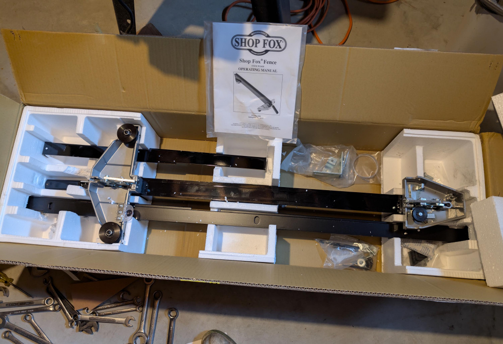

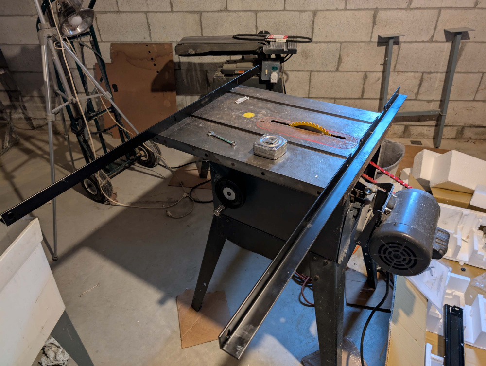

  • Bought a new fence. Installation underway.
    jr@macSteve_Lee6thplanetrjj45Eggguy
  • Sweet! It'll be like using a whole new saw. Did that belt make a difference with vibrations?
  • Fence looks a little like the Excalibur design from Canada, with the wheels...
    Three wheels, two in front and one in back, glide smoothly along the rails after making a few adjustments. The fence edge is machined smooth on both the front and back rail edges to fit perfectly into the track wheels. Not sure if the Excalibur design works the same. I could not find a detailed pic of the Excalibur on-line.

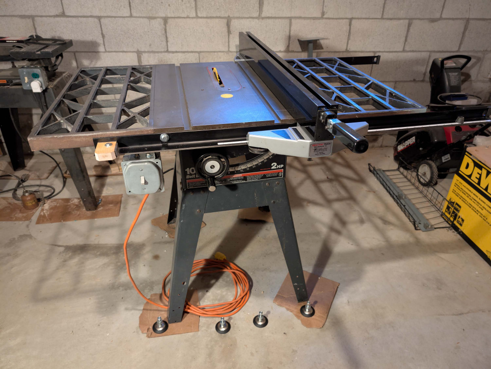

  • ShopFox fence installed, aligned, and tested. It is very accurate, glides smoothly along, and is very easy to micro adjust and clamp down firmly. I cleaned and waxed the table top and wings. When I get it moved into final position, I'll install the four new leveling feet shown at the bottom of the pic.
