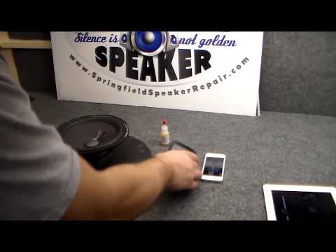

I have never re-foamed a speaker so I could be totally wrong... but I seem to recall seeing a re-foam video and they had to cut off the dust cap and use shims (they used pieces if playing cards) to make sure the voice coil was perfectly centered in the air gap. When the surround glue was fully cured they removed the shims and glued a new dust cap on. Maybe that's not necessary if the spider remains untouched?
correct. IF the spider is remaining, then the coil will stay centered.

I have re-foamed 7 or 8 woofers over the past 7 years or so. I cut out the dust caps and used alignment shims on all of them and have had no problems with rubbing or buzzing when done. I think shimming is the best method, because the shims not only center the voice coil, but they keep the cone from wobbling in the vertical dimension as well. If you try to refoam without shims, the spider will hold the VC in position, but it will not prevent the cone from wobbling off to one side or the other as the glue dries. You have to keep tapping around on the cone as the glue dries to make sure it stays properly centered.
The downside of using shims is that you have to glue a bigger dust cap over the old one to cover up the mess. This changes the TS parameters and high frequency response of the woofer. So now you have to modify to crossover over to fix this problem.
