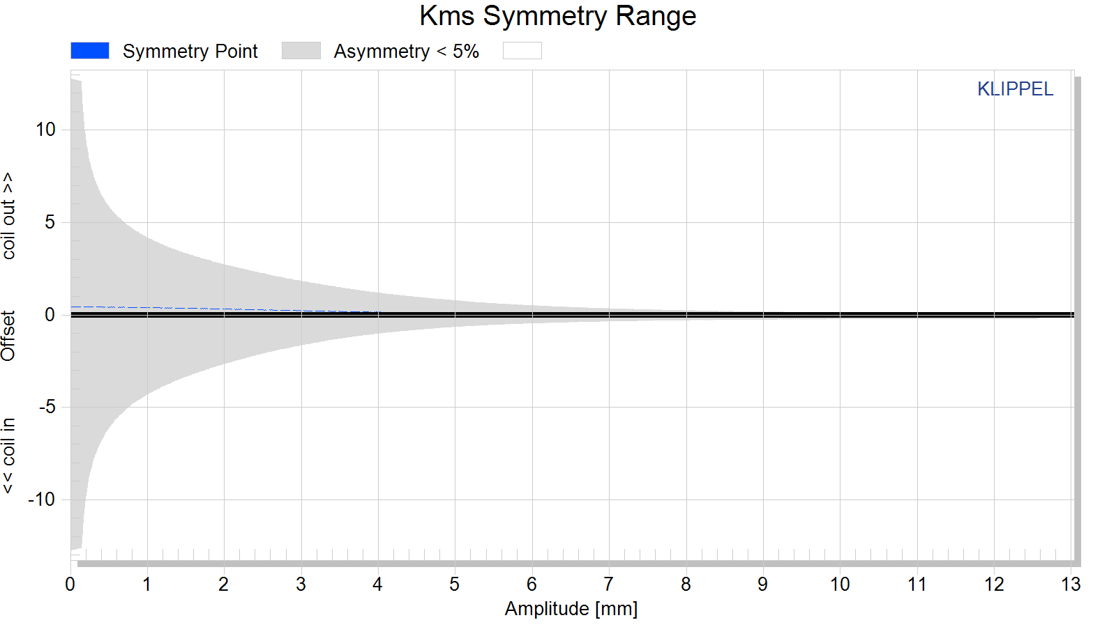

I wouldn’t ignore the late Jeff Bagby’s observation. There may be something to it. Perhaps it related to an underlying phenomena, like Kms(x) linearity, or multi factorial like Fs shift with excursion or Qts change with excursion. Remember, Jeff was working without a Klippel.
Scan-Speak’s 7” Illuminator 18WU/4741T00 has a Qms (mechanical Q-factor of driver in free air considering Rms only) of 7.2
Erin Hardison measured it and when it comes to the Klippel, just knocks it out of the park
https://www.erinsaudiocorner.com/images/Reviews/Drivers/Scanspeak/18WU4741T-00/Kms Symmetry Range.png
https://www.erinsaudiocorner.com/images/Reviews/Drivers/Scanspeak/18WU4741T-00/Stiffness of suspension Kms (X).png
