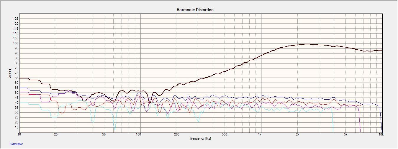

    Since I had my IB test baffle out, I measured the ND25FW.  Same 1/2 meter test conditions as the measurements I took on the Scanspeak and Vifa drivers:
    Honest!  That is 1/24th octave smoothing!  The 2nd harmonic and THD spike is right at Fs (no surprise).  I'd say with a LR4 slope 2kHz should be doable.  Hard to believe this was a only $13 on sale tweeter.

  • I just took the in box measurements for my ND25FW and MCM 55-2669 MTM project.  The measured responses were super easy to filter just as predicted.  I've already sim'd up a nice looking xo that only requires 7 parts...
    jr@macNicholas_23kennykTurn2
  • I'm listening to the prototype xo's now... really nice right out of the design box.  A small tweek to the tweeter padding maybe.  I like this tweeter a lot.  If they go on sale again I'll definitely pick up another pair.
    These are very solid MTM's but honestly they still need a sub to play that last octave.  I have plenty of time to finish their voicing and finish their appearance before InDIYana.  Impressive speakers for $78 worth of drivers and only modest xo parts.
