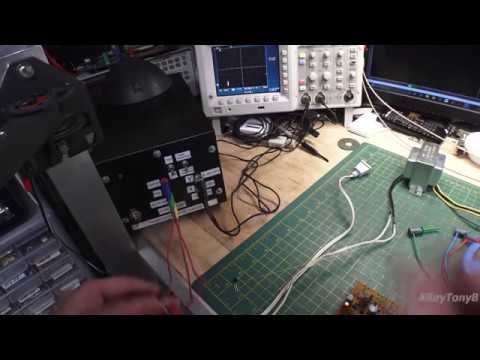

I don't think so. A curve tracer should be able to give me better information about a transistor because it can output a complete set of curves to my scope.
Below is a link to a video by xraytonyb comparing these type of small, handheld testers to his DIY curve tracer. In the end, I should be able to get my B&K curve tracer working for about the same cost as one of these cheaper $20 handheld type units. Or so I hope. It's always a gamble when attempting to restore an old piece of test equipment.
