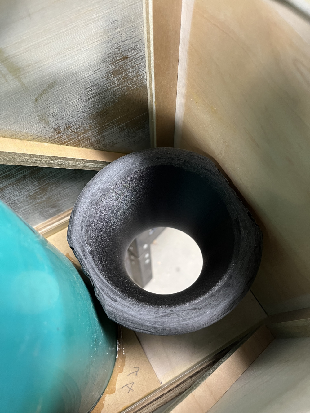

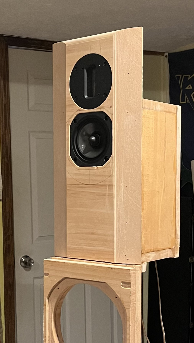

  • Now with all the goodies installed. Audax AM210Z2, HM100Z0, and AC APR2.1. Woofer tuned to 35hz. My frickin DATS took a shit on me. I tried to load a .zma file into it (wasn't sure if it'd do that) and the software crashed. WTF! Now it doesn't work. I don't have the software disk to try a reload, have to get the one at work. Fucking stupid. Anyway, I did play with stuffing the mid tunnel with a bunch of fluffy nonsense. I ran a piece of 1/4" x 2" wide felt around the diameter of the pipe up front to damp junk coming from the driver then stuffed it with polyfill, impedance sweep (before I killed it) showed a nice Fs peak at 395Hz. Probably start getting FR stuff soon, if I don't wreck Omnimic.๐Ÿคฆ๐Ÿปโ€โ™‚๏ธ

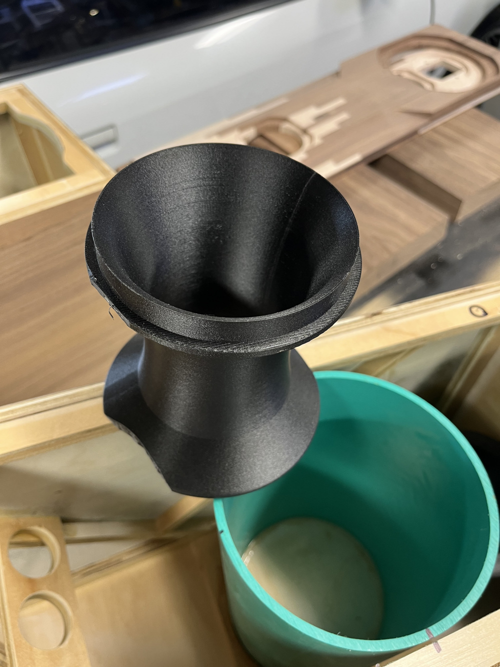

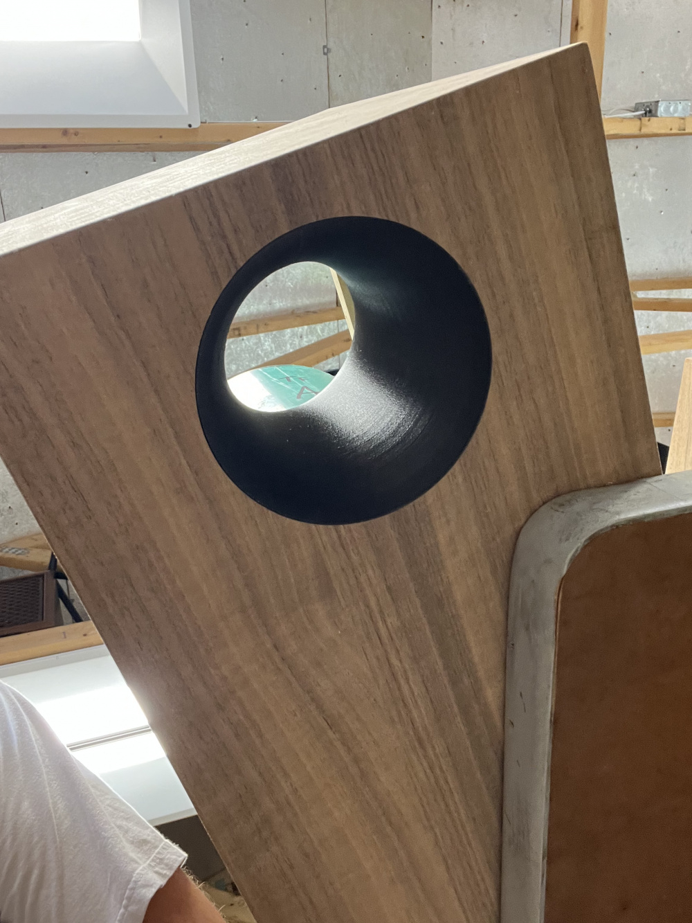

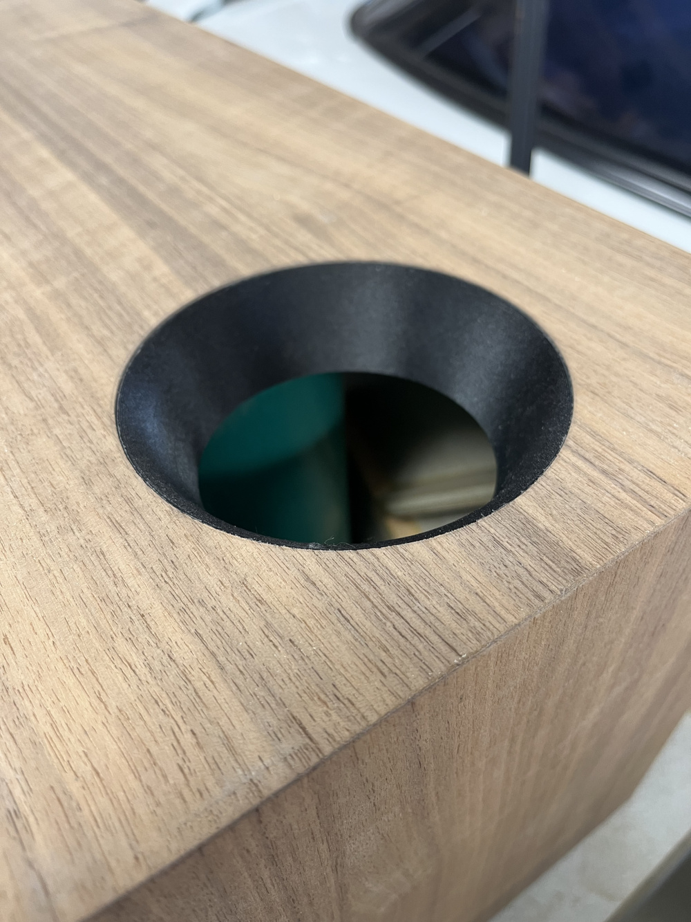

  • Cut the pipe for the mid tunnels. 6" PVC.
    ugly_wooferrjj454thtryjhollander
  • Love the angle cutting jig!!
    (To match the slope of the backside of the cabinet I presume?).
    Open back tunnel or sealed?

    To match the front and open, scroll up and you'll see ๐Ÿ‘€๐Ÿ‘๐Ÿผ
  • Aha! Got it. Thanks.

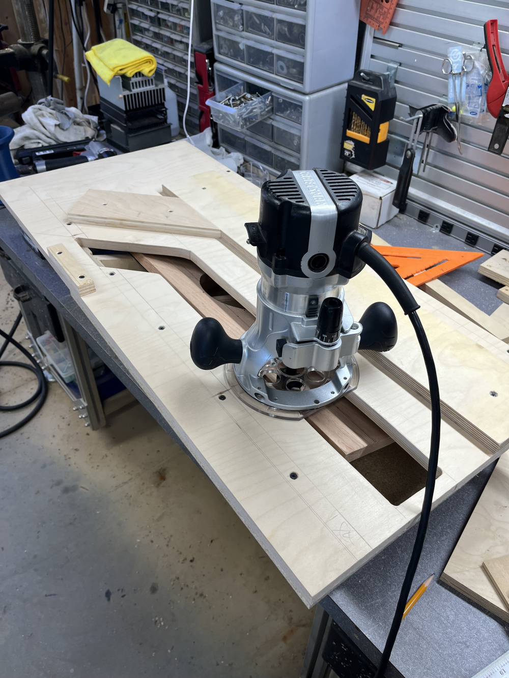

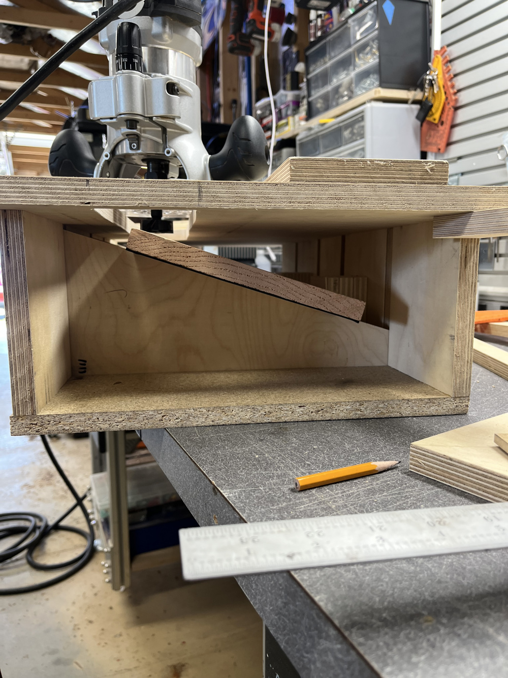

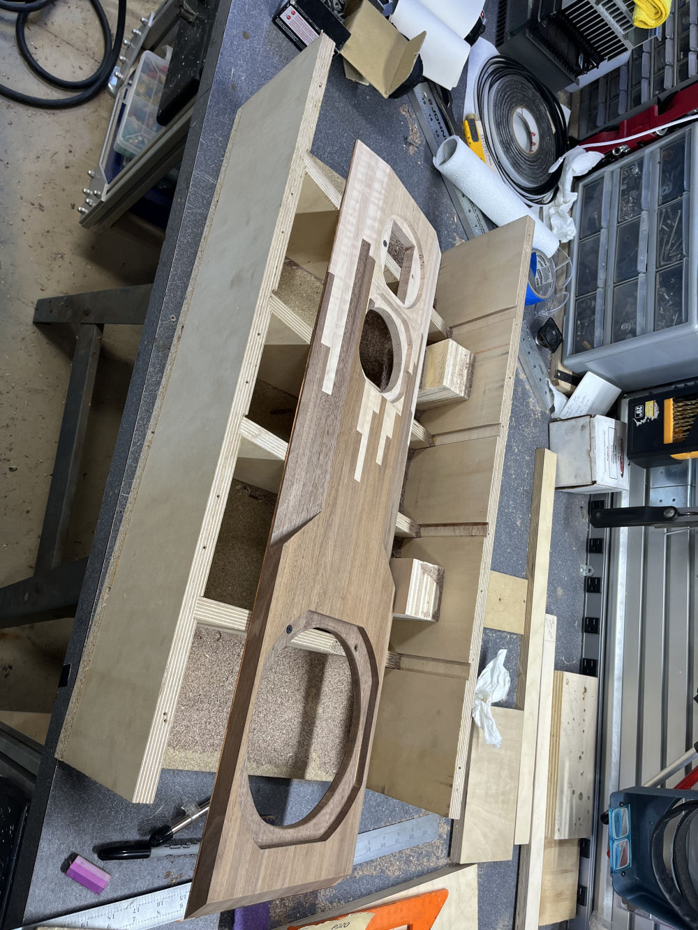

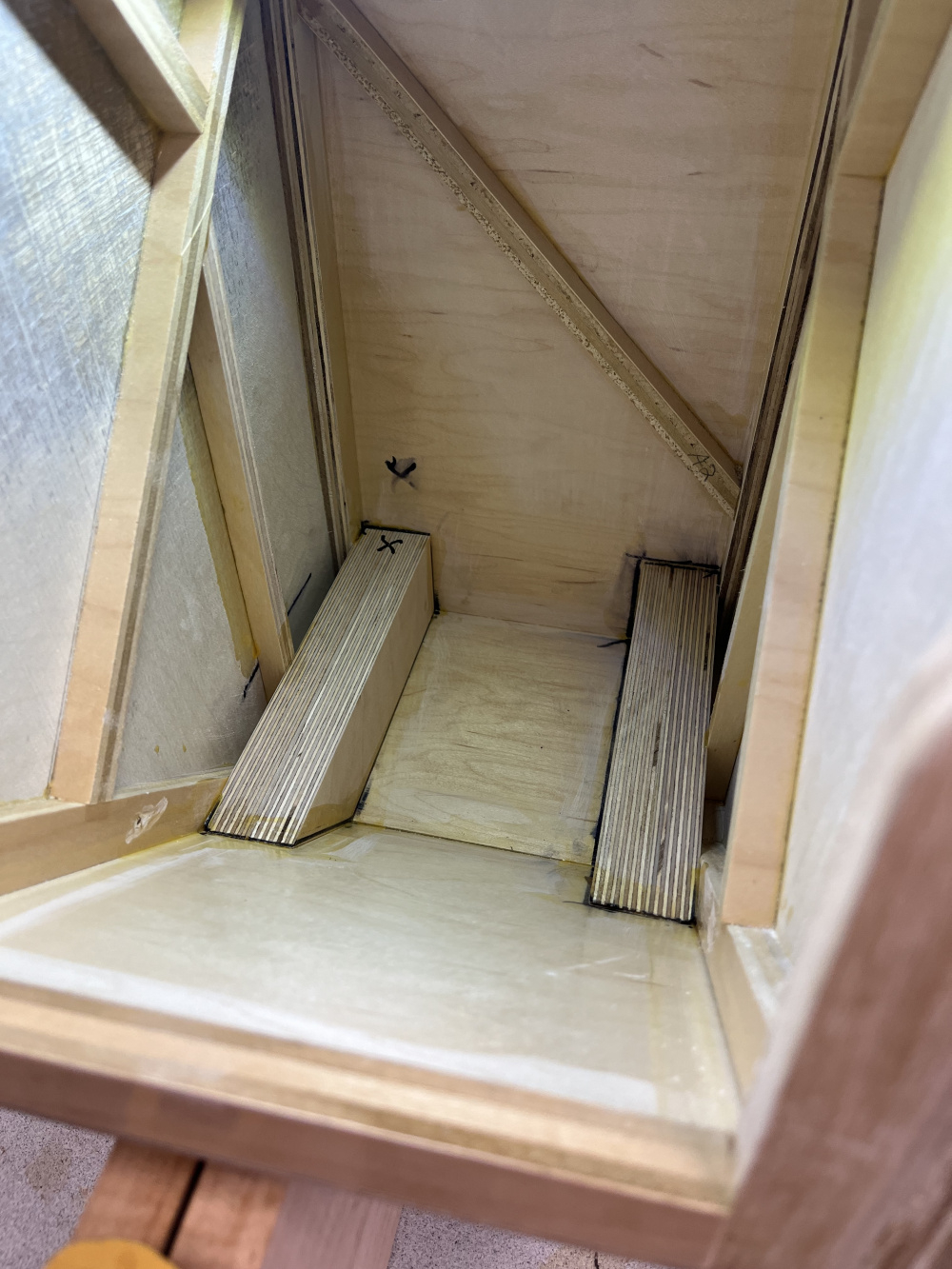

  • With the weather getting crappy, it's slow going. Got the bracing done on the cabs. Built a router leveling jig for the walnut chunks to make the feet.
    4thtryugly_wooferSteve_LeejhollanderSilver1omo

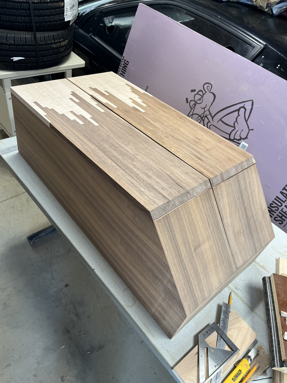

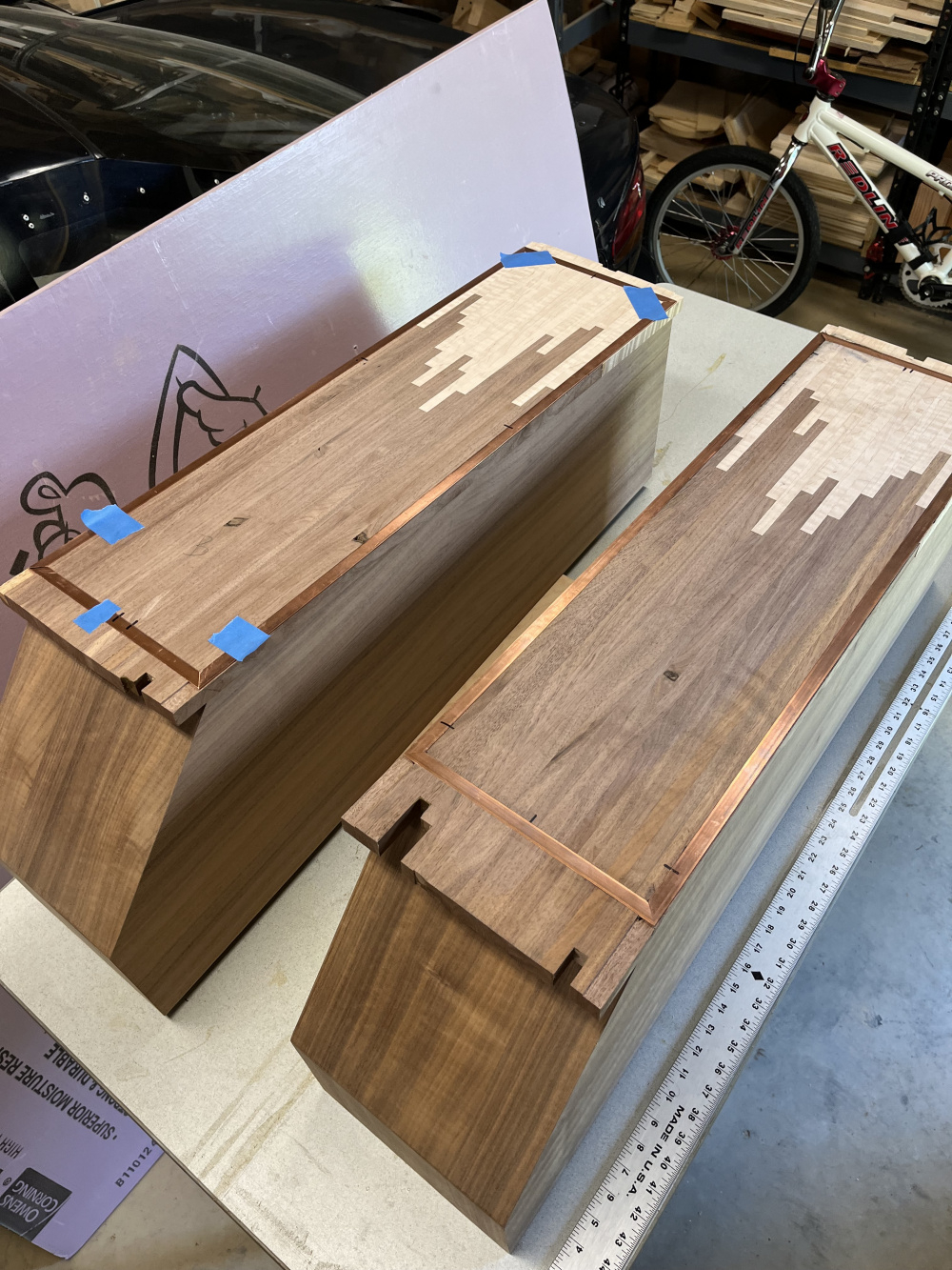

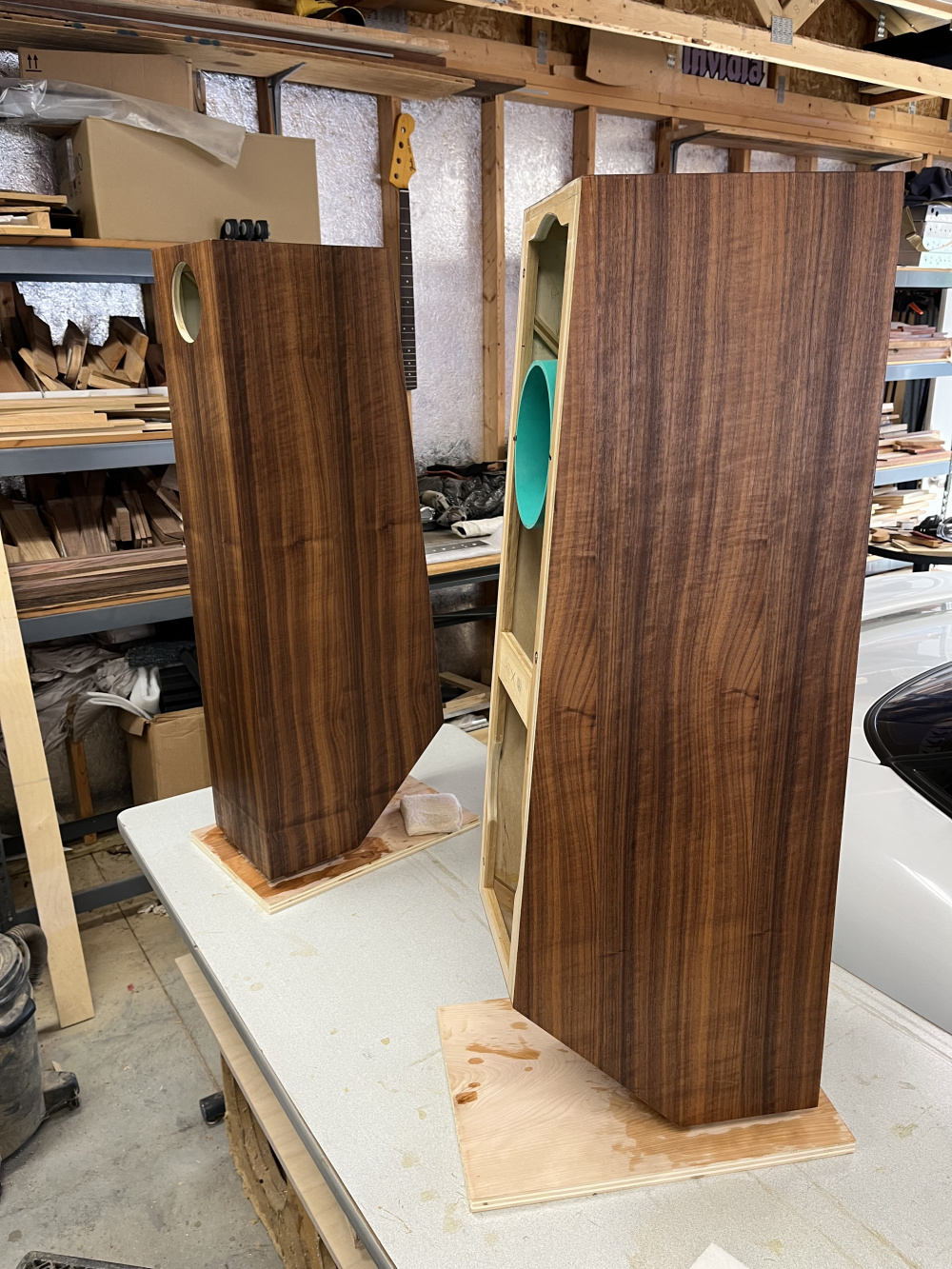

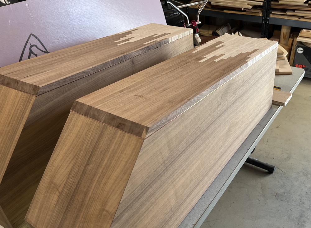

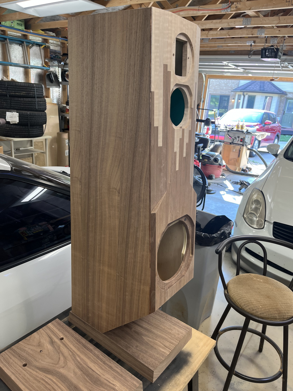

  • Bit more progress today, nice weather for some veneer work. Cabs are looking spiffy now!
    hifisideNicholas_23ugly_wooferR-Carpenterkenrhodes4thtrytajanesrjj45Steve_LeeTurn2and 3 others.
  • Excellent work!
    6thplanet
  • edited June 2023
    Thanks!
    ...and again, can't say enough about the Wilson Art H2O contact adhesive. Great to work with, just have to see how it fairs over time.
  • The veneer looks great - well done!

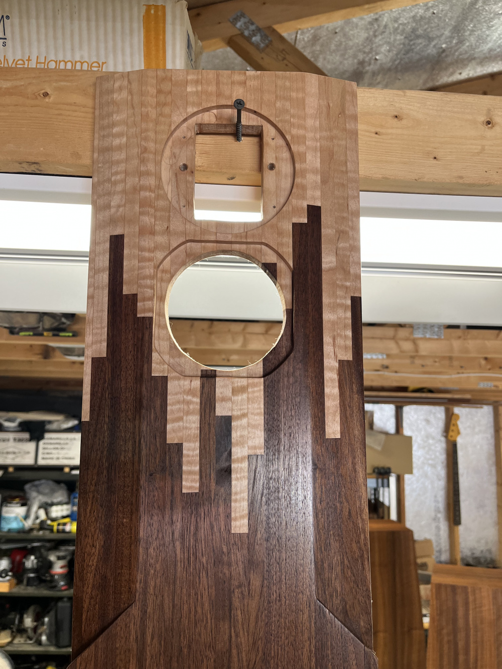

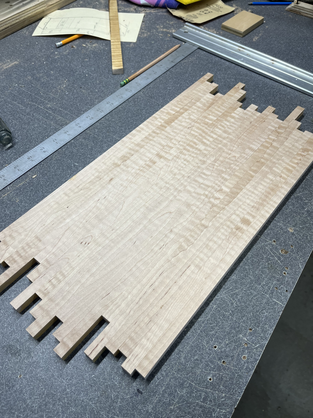

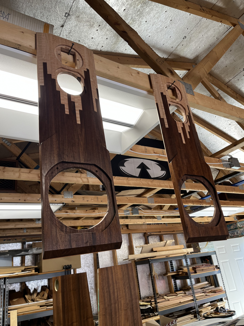

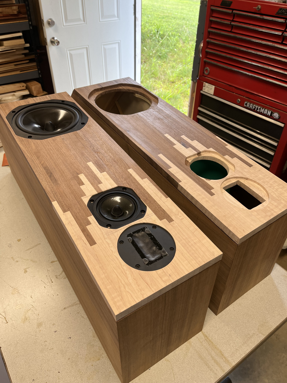

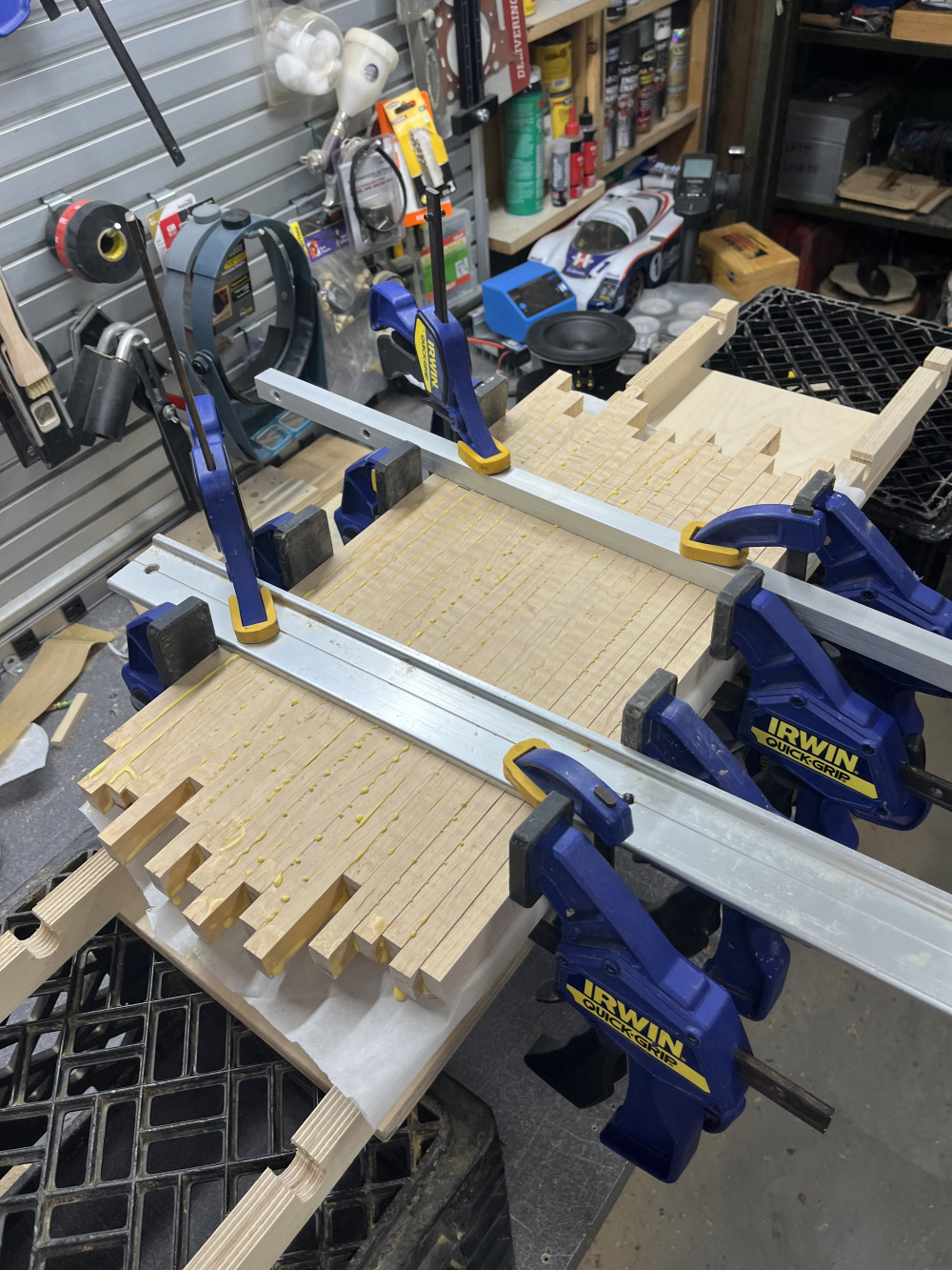

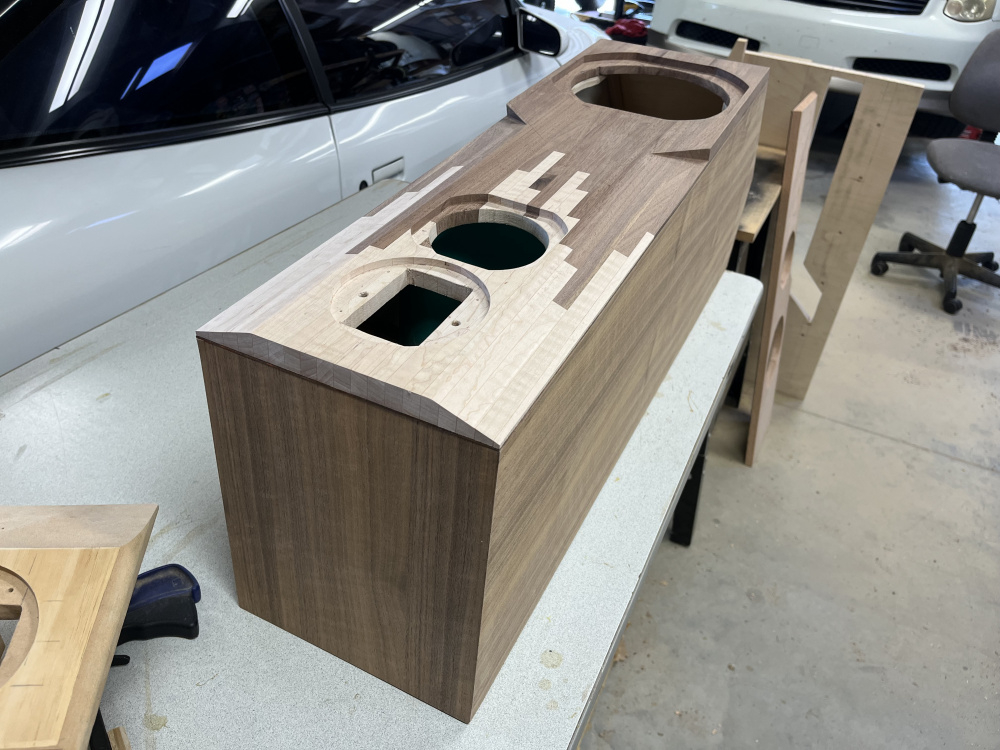

  • Started making the blanks for the baffles. Walnut and Flamed Maple.
    dcibelSteve_LeetajanesSilver1omoBilletjhollanderugly_wooferhifiside4thtrysquamishdroc
  • hifisidetajanesSilver1omorjj45PWRRYDSteve_Leejohnny5jzsilverDDanPkenrhodesand 5 others.

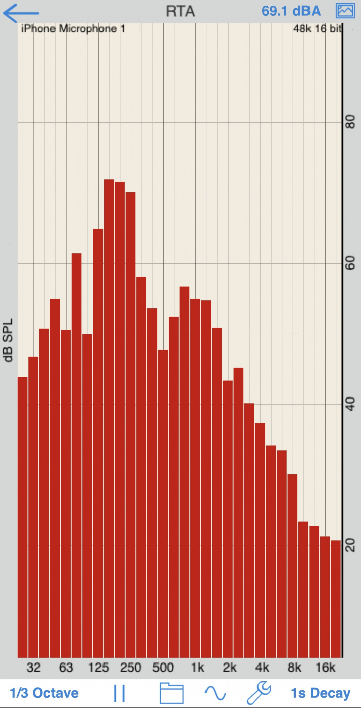

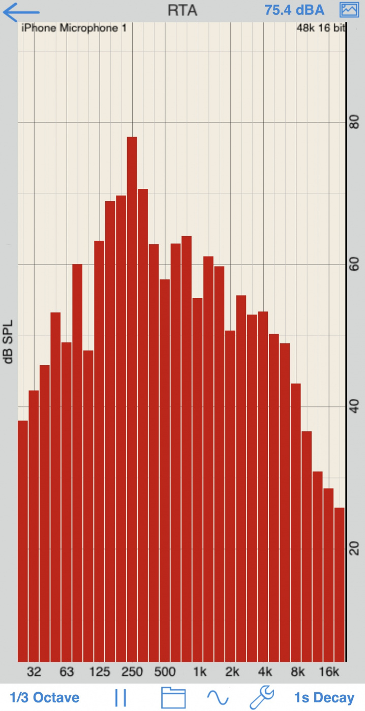

  • Looks like an RTA screen . . . Badass!
  • They've been dubbed the 8 bit baffles.๐Ÿ˜†
    ...guess not so high resolution speakers?

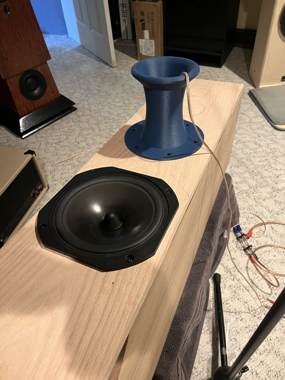

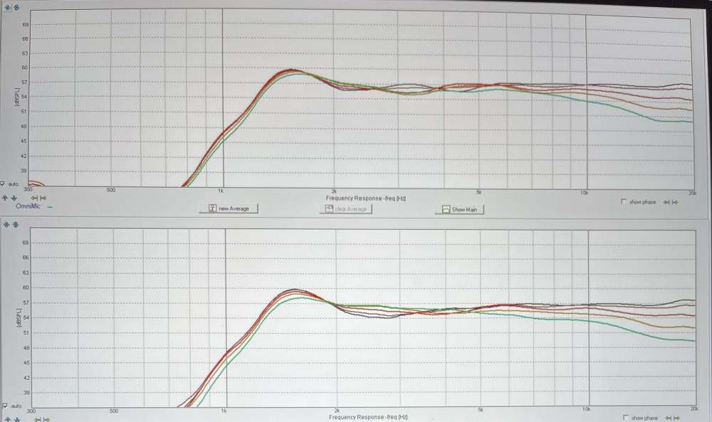

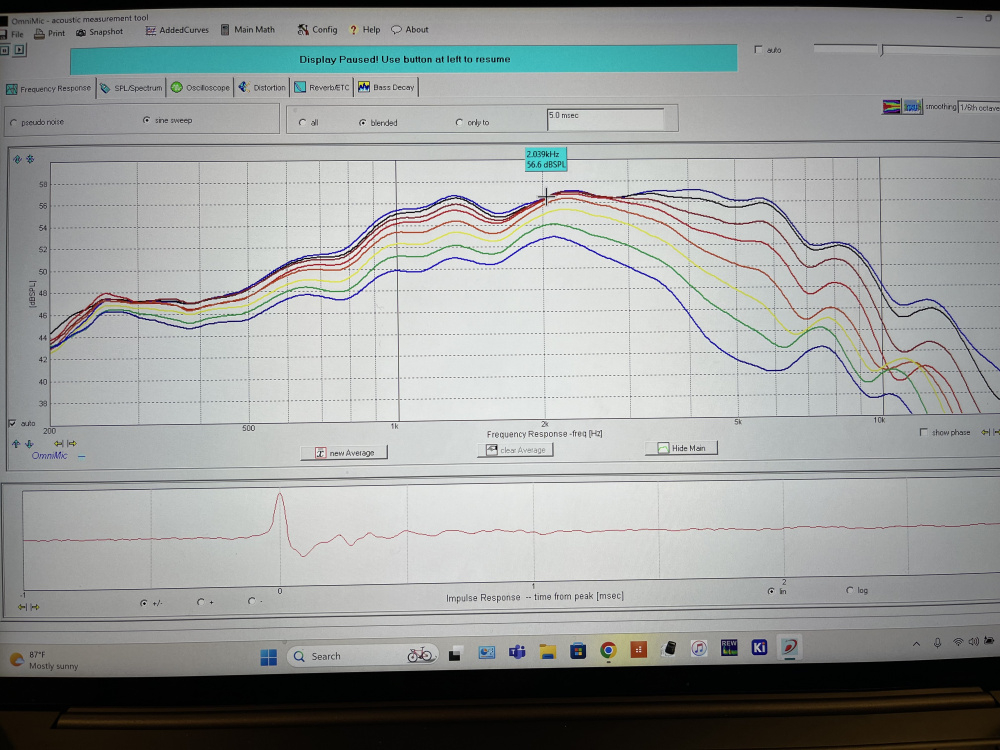

    Ok, so diving in on the directivity thing, I took some measurements on a test baffle. It's 9" wide (3/4" round over). Tweeter right above the mid, mic on tweeter axis, 30" away, 10 degree increments. I get this from the mid....
    The bunching at 2K is baffle related?
    I plan on faceting the baffle, should I expect less bunching?
  • ...huh, crickets

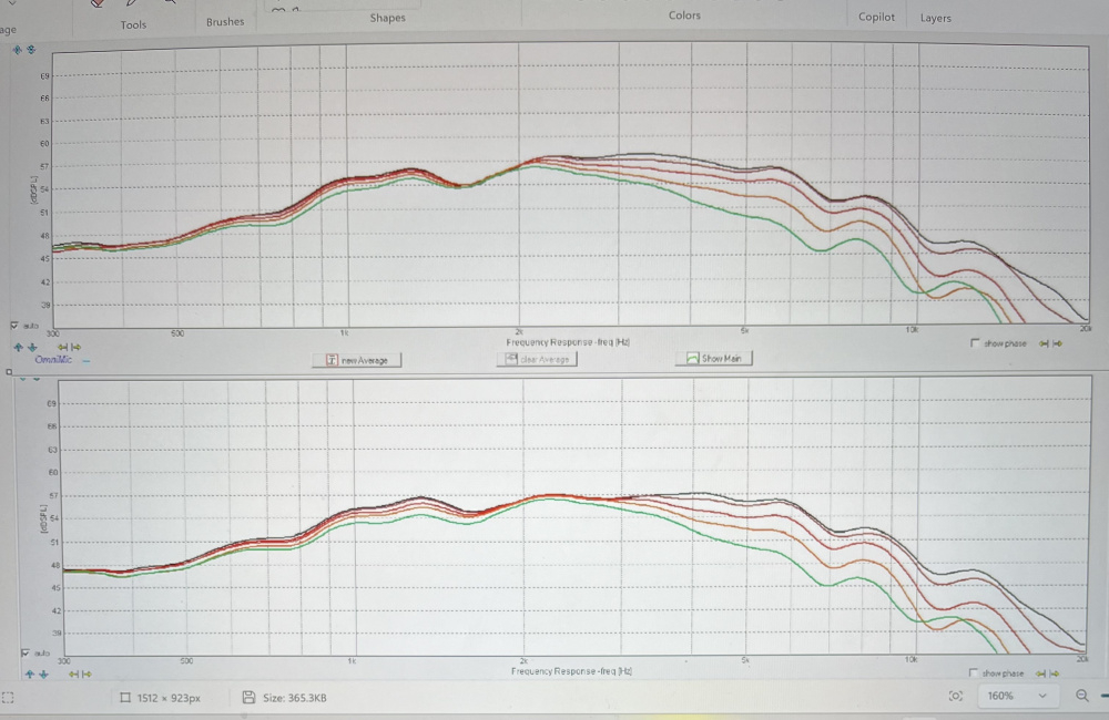

    Well, I answered my own question. I cut a shallow facet on the baffle and ran the measurements again.
    The facetted responses are at the top, 0-40 degree, 3dB scale. First up is the tweeter...
    Midrange...
    Basically it's tightening up the grouping as you move off axis. The tweeter goes from a dip at 2.5K to having a bump at 3.2K, but overall much tighter grouping till it starts to spread, which also happens later.
    The mid, is tighter grouping from 300 up to 2.6K where it pinches. Then starts to spread at 3K. Unfacetted, it's kind spreading till it really pinches in at 1.8K, stays there until almost 3K. I can see how that can really make the power response hot in that region.
    To me this once again kinda proves a smaller baffle is a good thing. Also why no baffle can be a great thing.
    The flip side being a really wide baffle, I've seen it have it's merits too, but I'll likely never venture there mainly because of aesthetic reasons.
    Anyway, hope someone gains some insight from all of this. Back to making sawdust...
