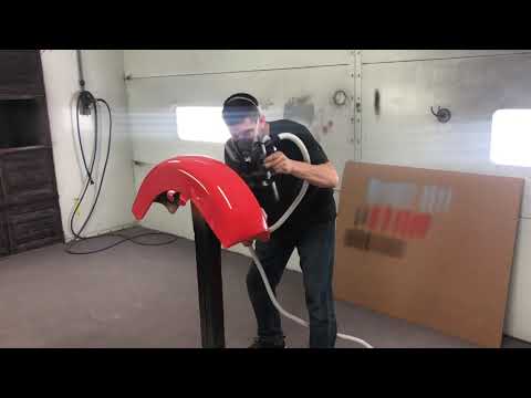

Curiosity was killing me.
I went and bought a HF HVLP turbine sprayer kit. Here’s me spraying with for the first time and my thoughts.
Tagged:
ani_101jhollanderkenrhodesjholtztajanes4thtryScottS
  • Seems like you had to tailor whatever you were shooting to fit the unit. This makes me wonder what kind of results the target consumer, one that knows very little about spraying, might achieve without your vast knowledge of the things that make or break a good paint job.
  • That was a good review. Thanks Brad.
    Could you explain the part about the reducer and increasing the ratio. What are you looking for to get the ratio right?
    Well even a rattle can that I might hold 6” away from the material and others are 10-12” away is tailoring the way it will sprays. And as for my vast knowledge of painting, it came at a cost, I’ve had lots of bad days in the last 22 years. I’m just trying to help anyone that wants to learn and that it doesn’t take thousands of dollars to achieve good results. It takes practice = knowledge.
    Good question. All the primers, basecoats and clears come with recommended mixing ratio on the can. And that’s exactly how I mixed them. By adding or putting additional reducer in the formula helps its spray ability.
    I chose SLOW reducer because it does two things, it thins the paint for spray ability (better atomization). SLOW reducer also help melt any big droplets of paint on the material ( flatten any texture). And this unit needed the help.
    VERY FAST reducers mostly only help in spray ability, as the reducer tends to evaporate before it lands on the material.
    There is no ratio for what i additionally added. The coat I did previous to it, told me what I needed.
    To textured = add a little reducer
    To wet looking = turn the fluid needle in.
