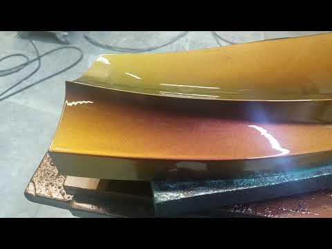

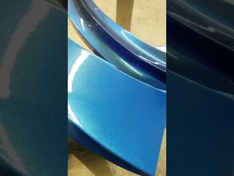

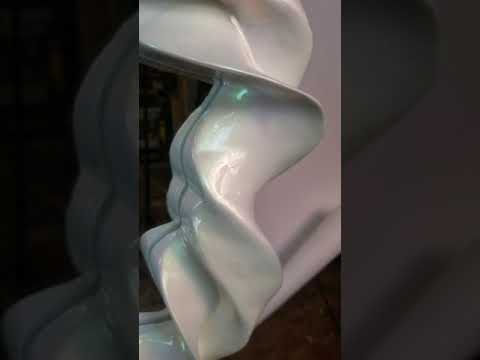

  • There are some PPG pearls chameleon flakes and shimmers on ebay that really pop. They retail for as much as $900 for 6oz but with a bit of luck $60 may just do it.
  • What's the difference between the holographic and pearl metal flake?
