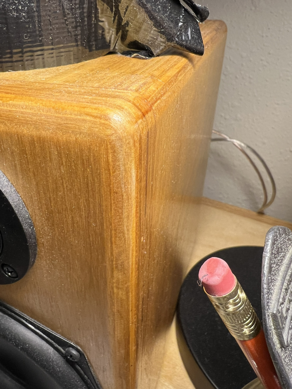

  • BB rounded corners are not that difficult. Take a little off each pass. Standard disclaimer: "I am a total wood hacker, who occasionally has successful cosmetics."
    This is BB with amber shellac base.
